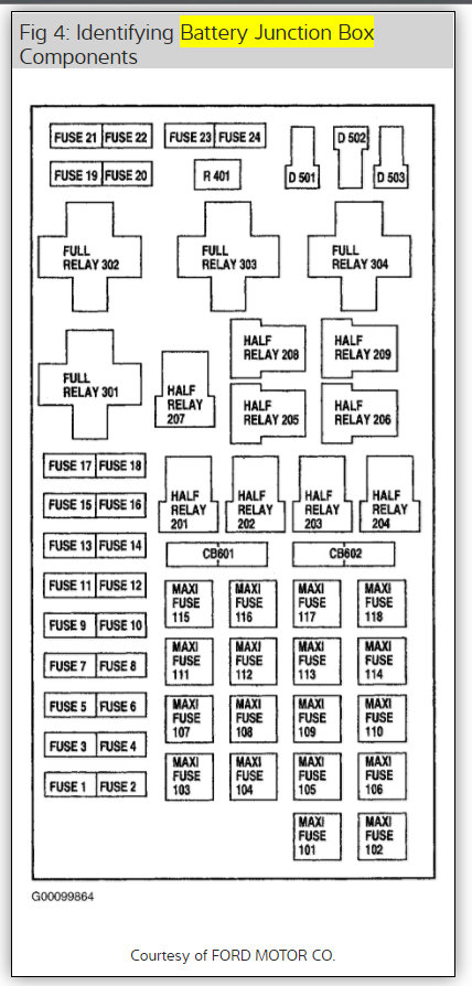

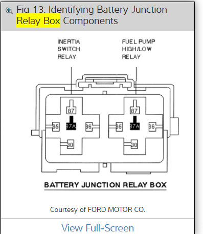

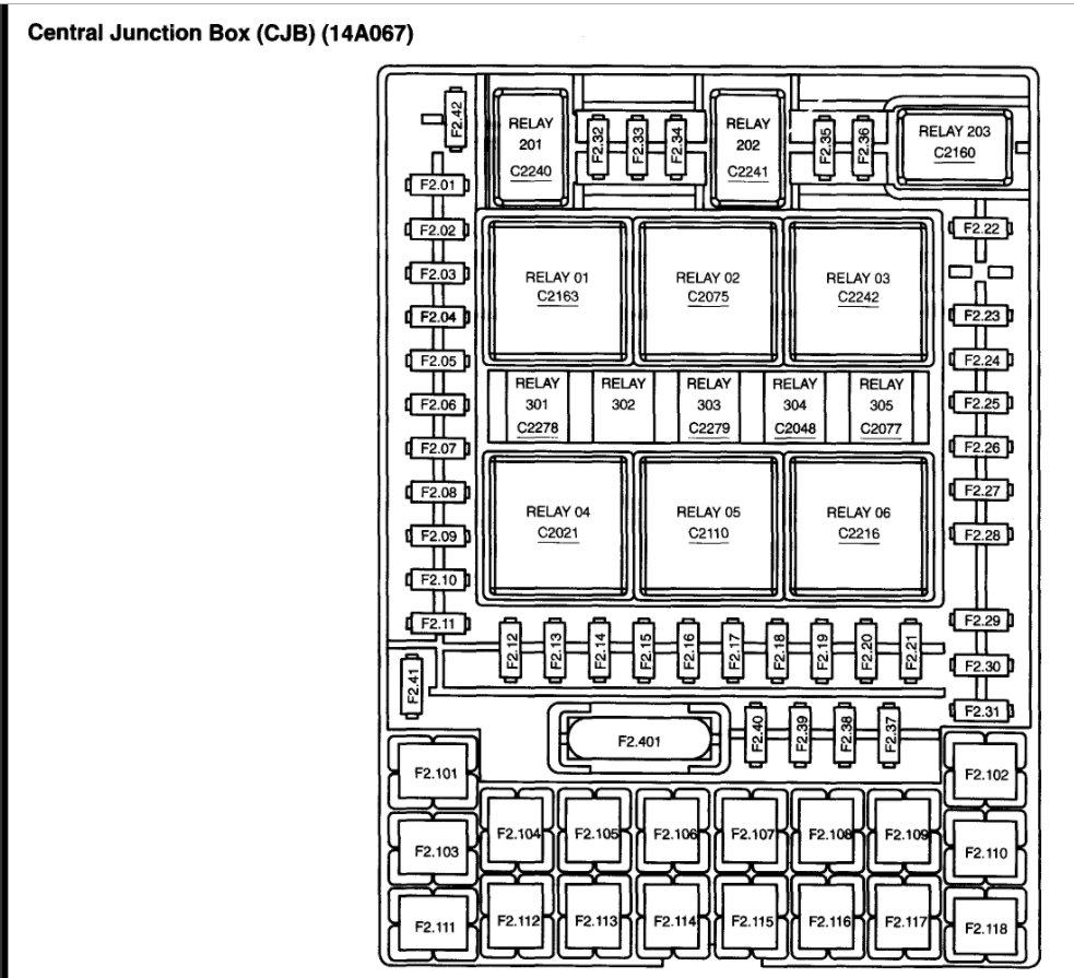

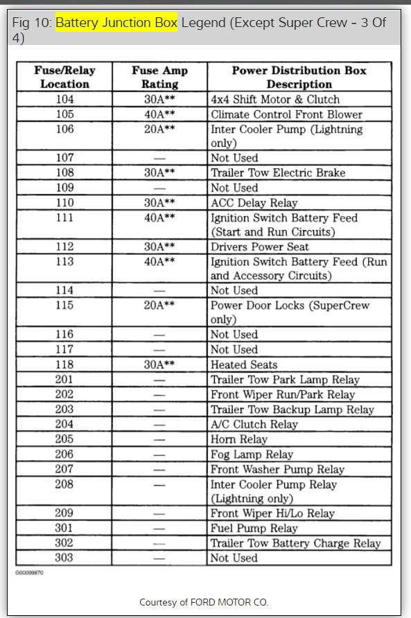

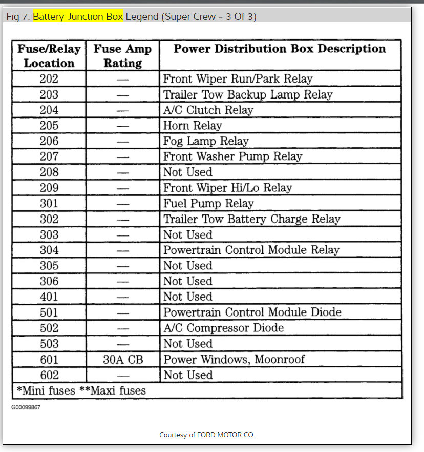

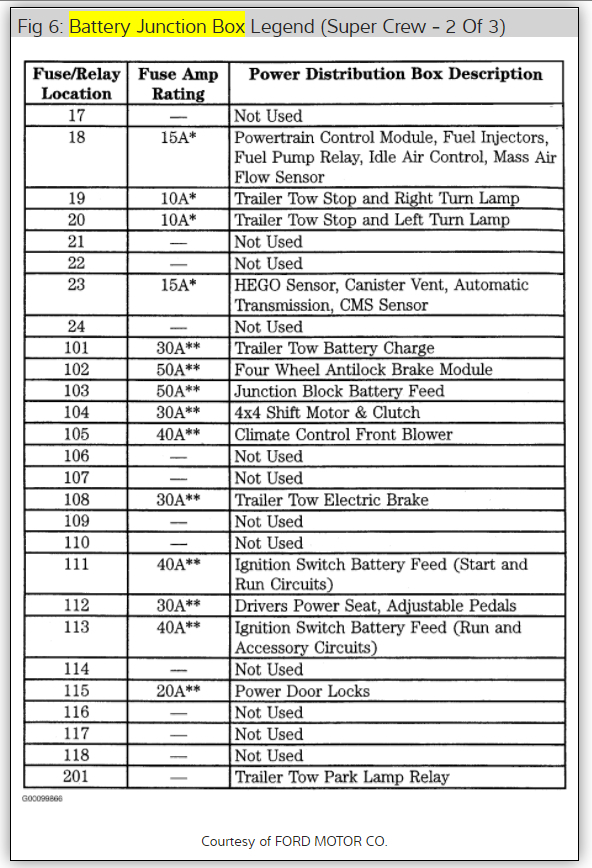

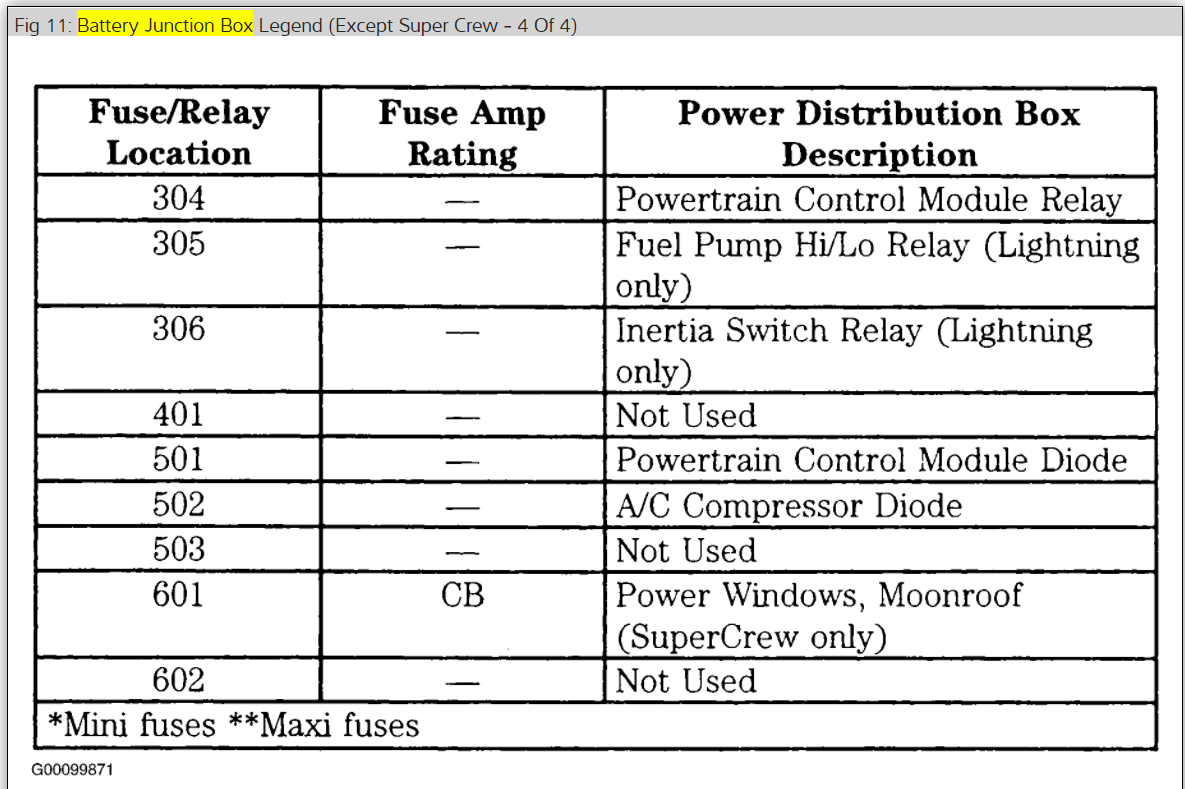

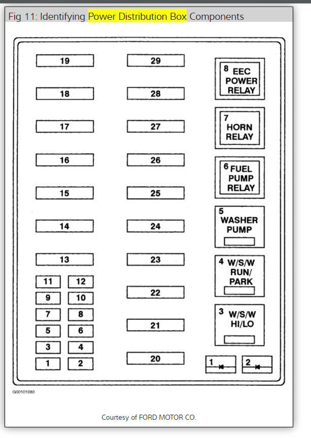

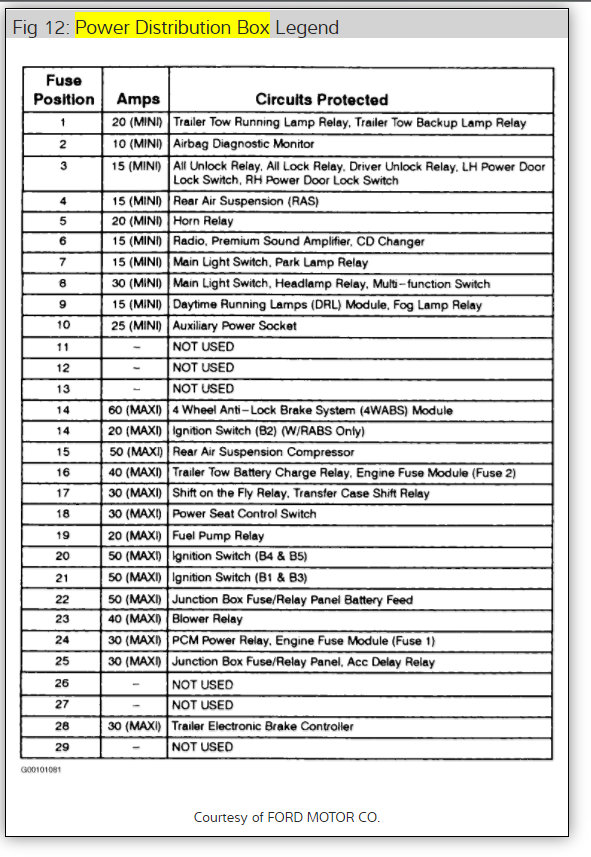

Where is the fuel pump relay located and the fuses?
Mar 22, 2009 at 2:27 PM
  • 55,423 POSTS

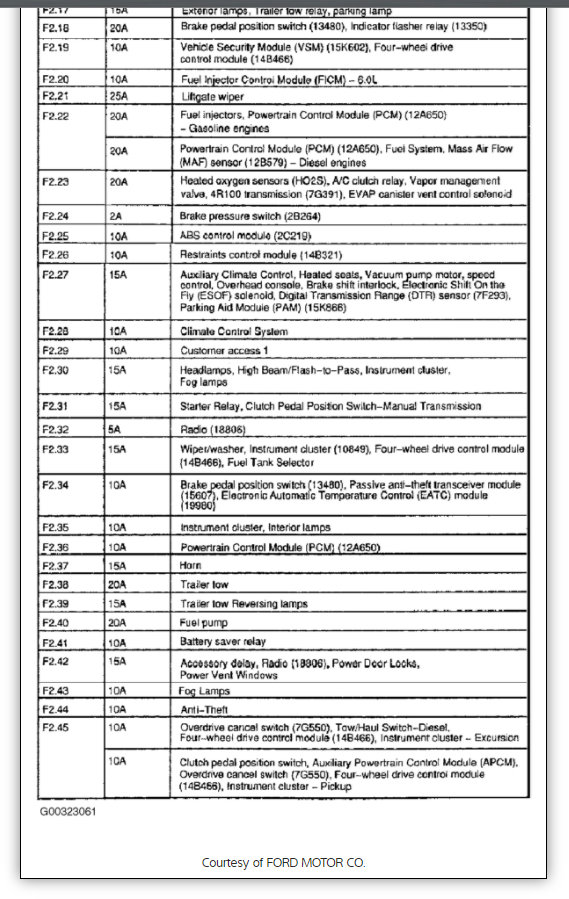

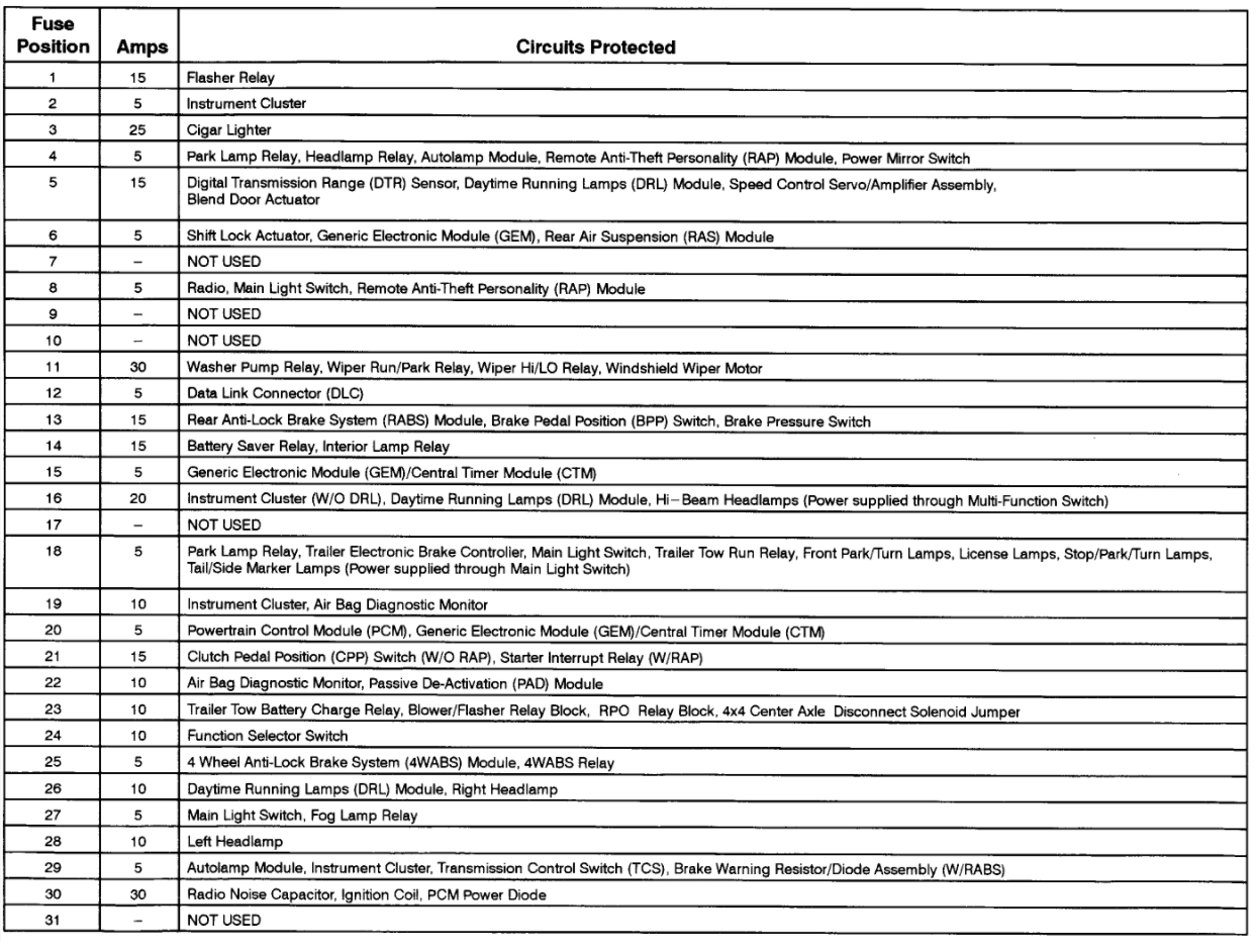

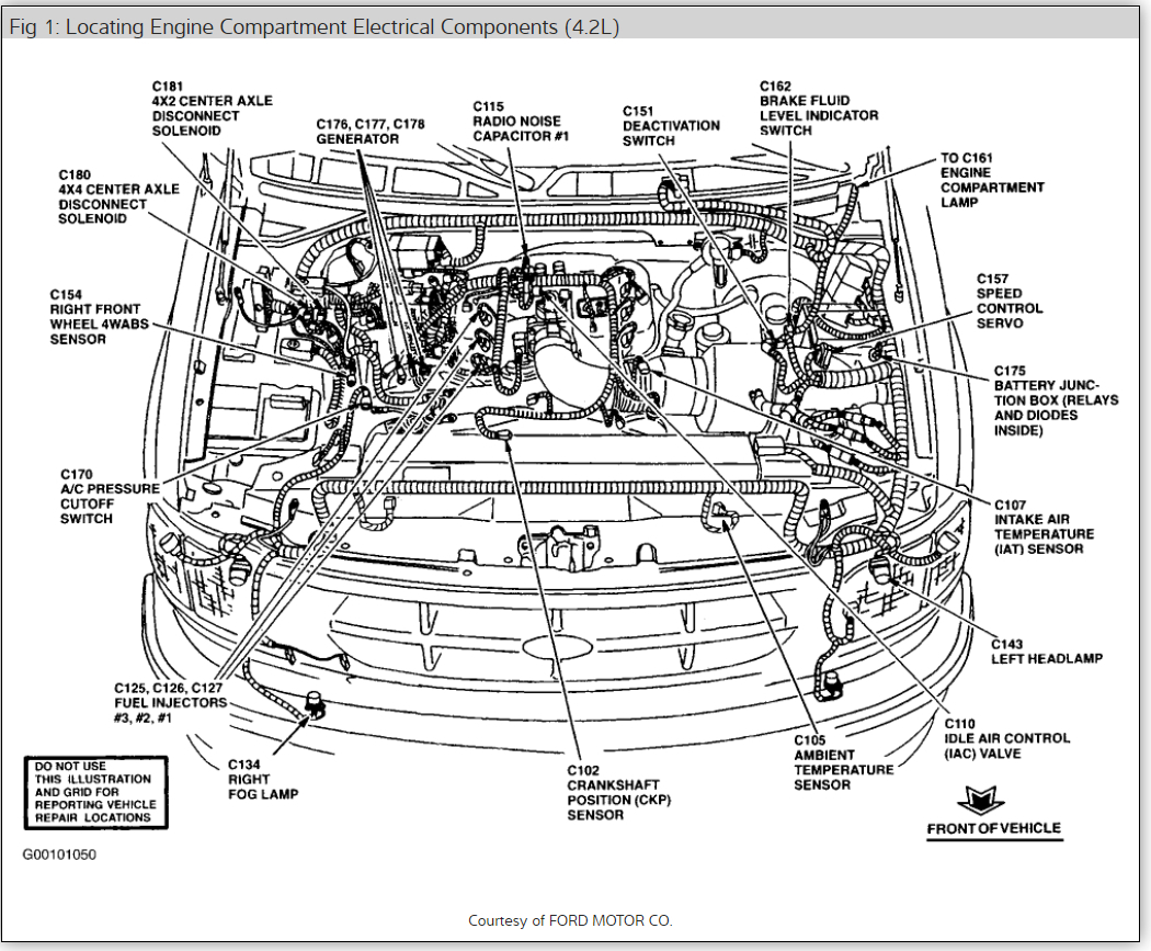

The fuel pump relay is Number 303 in the main PCD under the hood. Here is a guide and some fuse box diagrams (below) to help you get the problem fixed.
Please let us know what happens so it will help others.

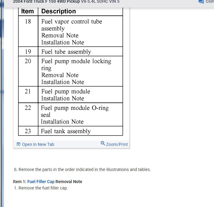

Aug 17, 2017 at 1:53 PM
HOOTGIBSON

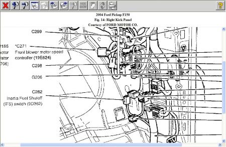

I had about 1/4 tank of gas driving I had no problems before and it just died, it would then start get up to 1K rpm and die. Changed fuel filter along the road, I got dirty gas out of the tank side, it will start but only run a little longer than before. I tried to remove the filter and pump gas into a gas can but can not get any fuel to pump out. Is there another filter in or on the tank that could be plugged. I had bought gas at a major truck stop on I-70 outside of Kansas City, Mo, so there should not have ben a old gas problem
May 29, 2021 at 4:03 AM (Merged)
  • 75,992 POSTS

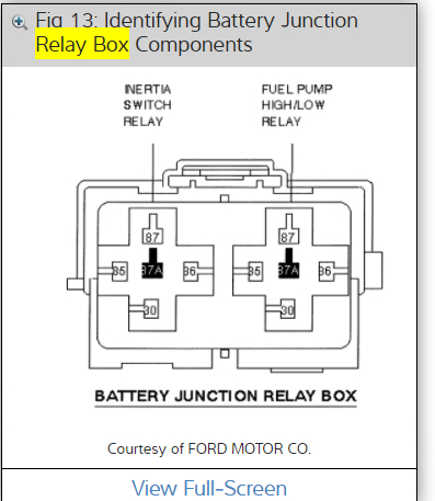

Try this find the inertia fuel cutoff switch behind the right kick panel try resetting it and turn key on do you hear the fuel pump If not remove switch and jumper the electrical connector, try key again Le tme know-

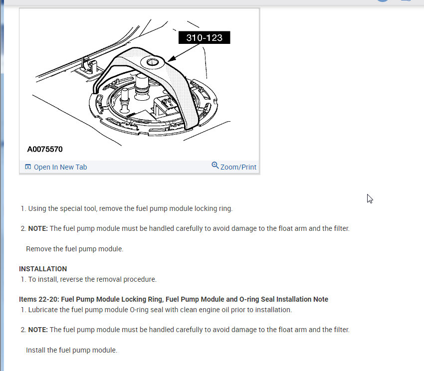

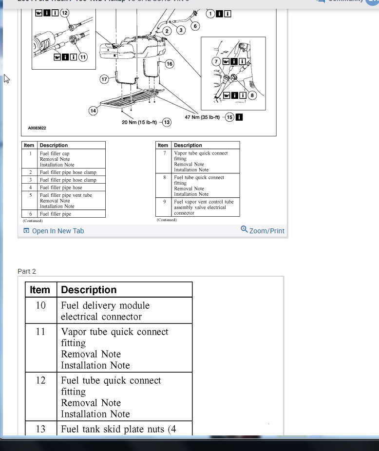

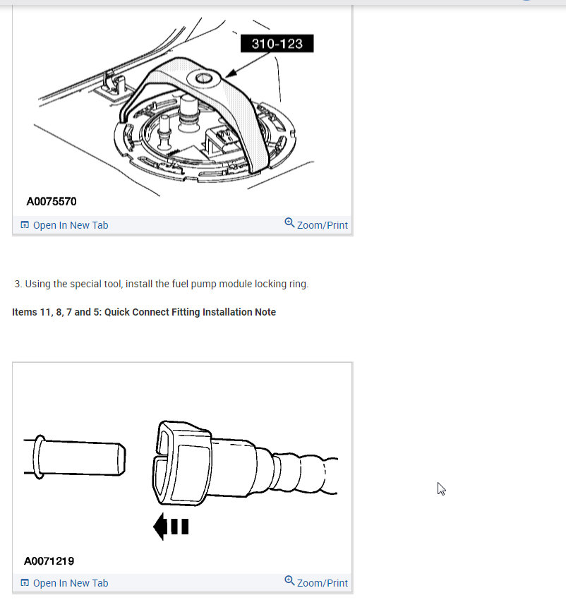

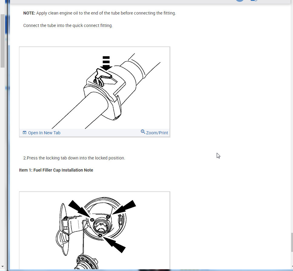

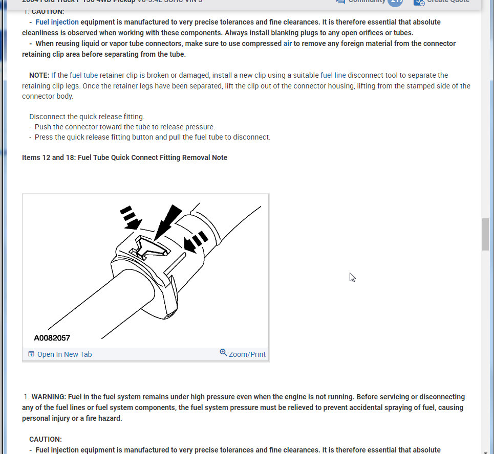

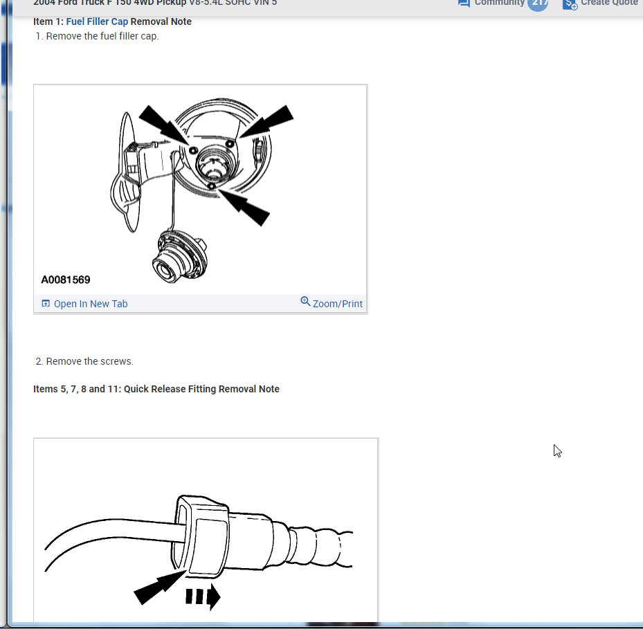

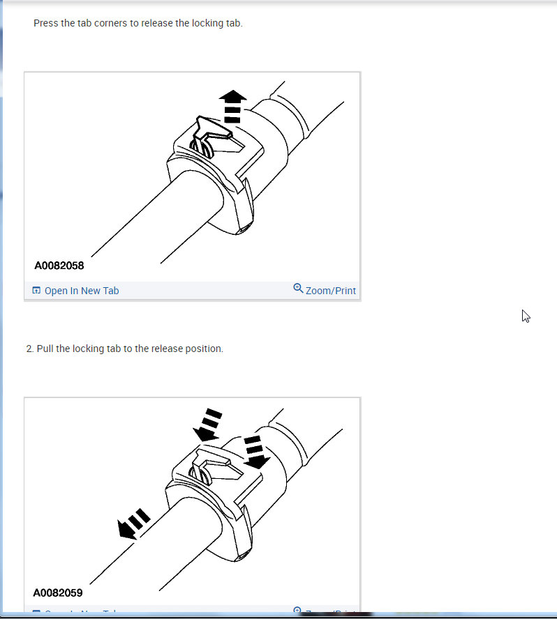

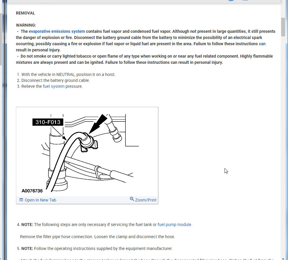

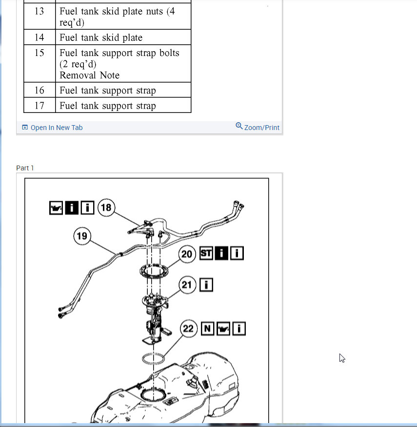

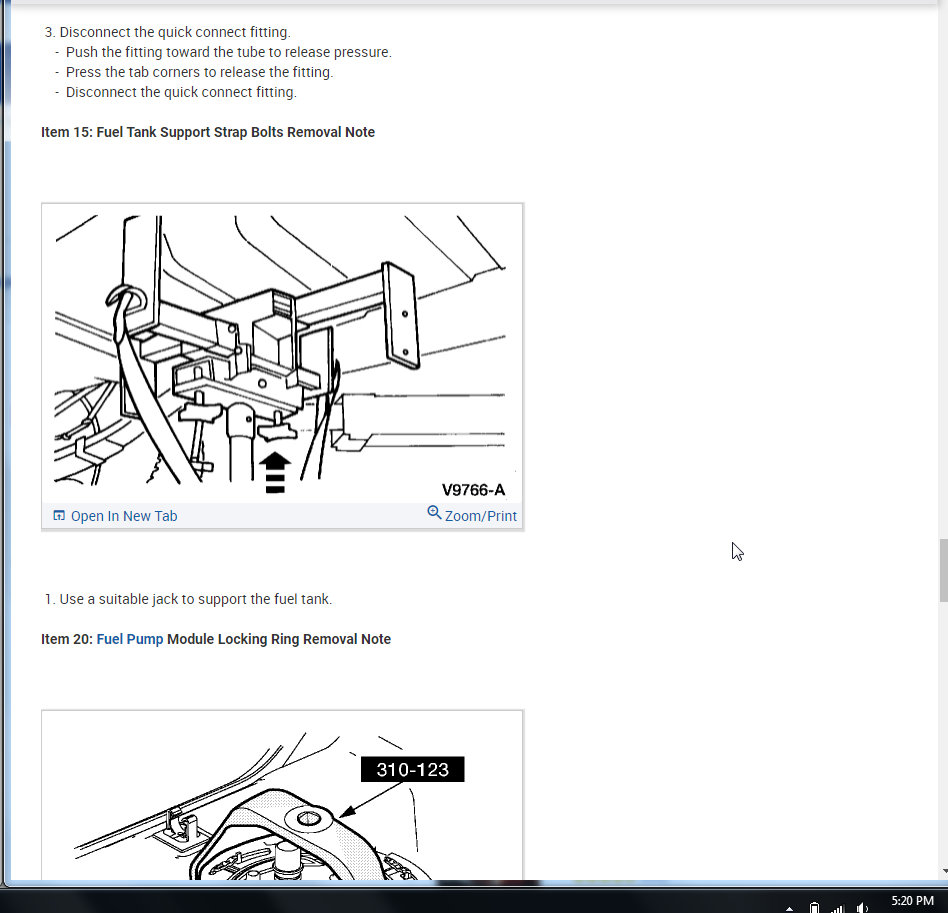

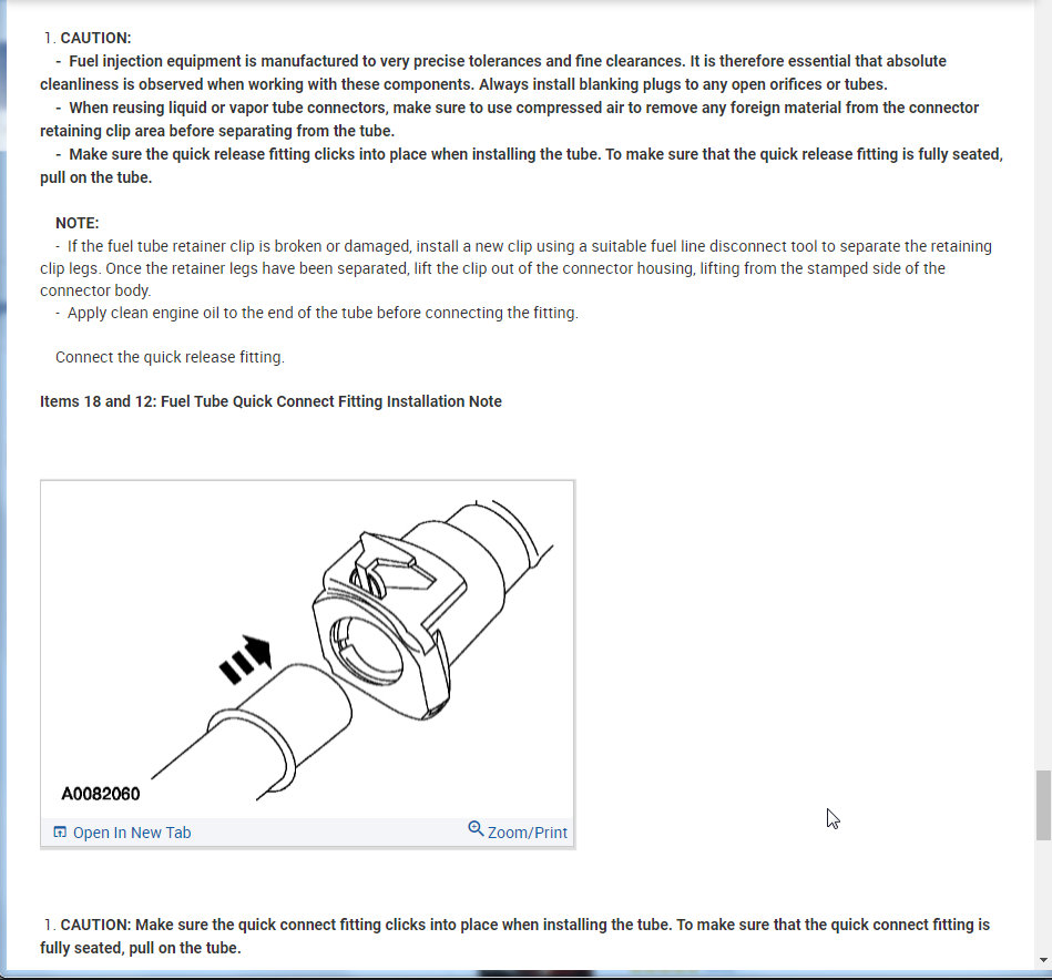

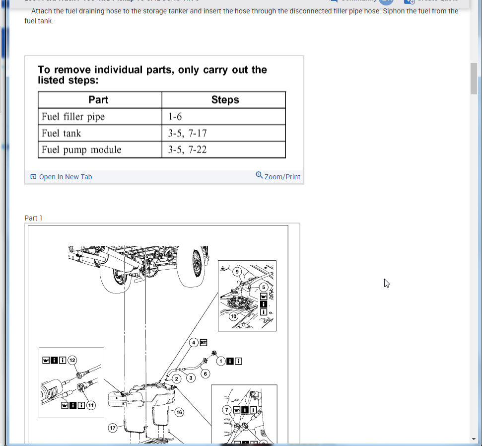

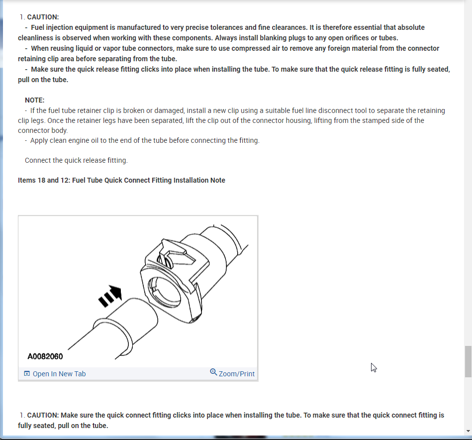

If you had visibly dirty fuel in the tank then I suspect the pump has failed. They are not able to handle much contamination so we need to start with checking the pressure. Here is a guide that will help with this.
Also, if you had dirty fuel then you may just have a fuel quality issue which means we need to drop the tank and clean it out and put fresh fuel in it.

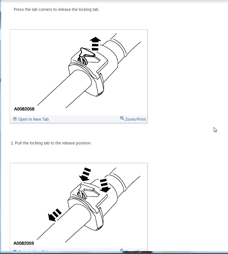

If you have to replace the pump, here is a guide that will help with this.
https://www.2carpros.com/articles/how-to-replace-an-electric-fuel-pump
Below you will find the process from the manual on how to replace this.
Please let us know if you have other questions. Thanks

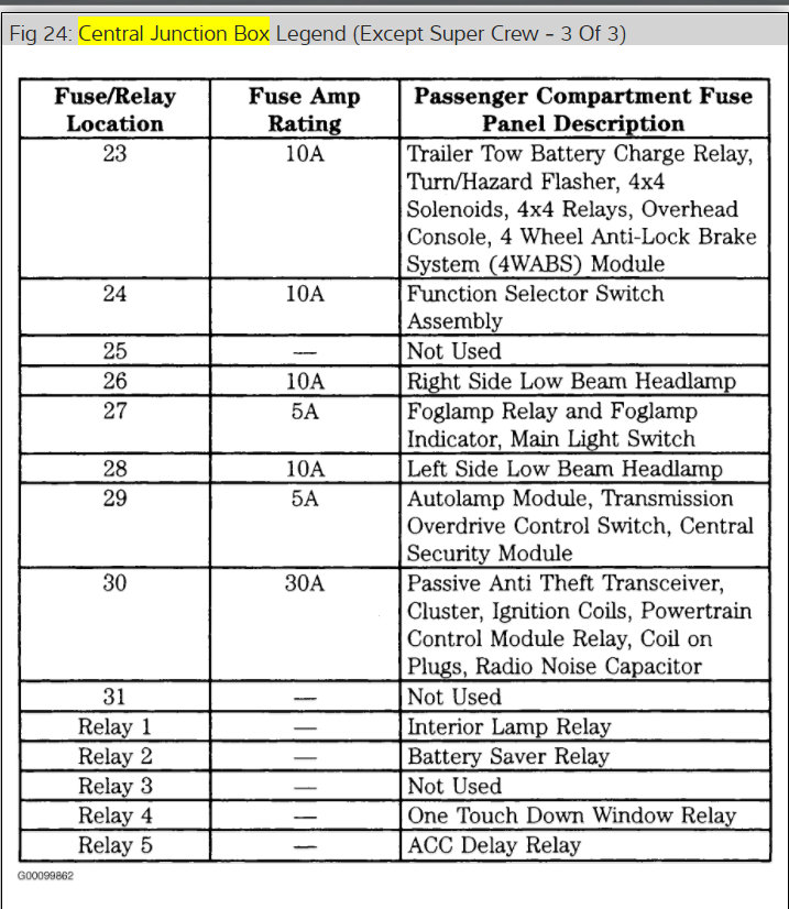

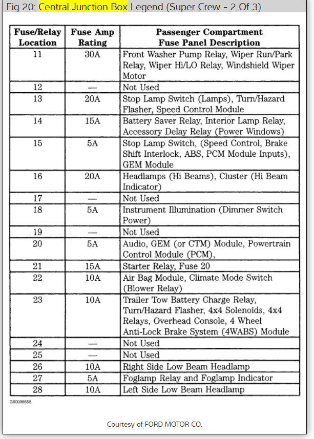

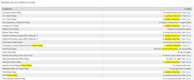

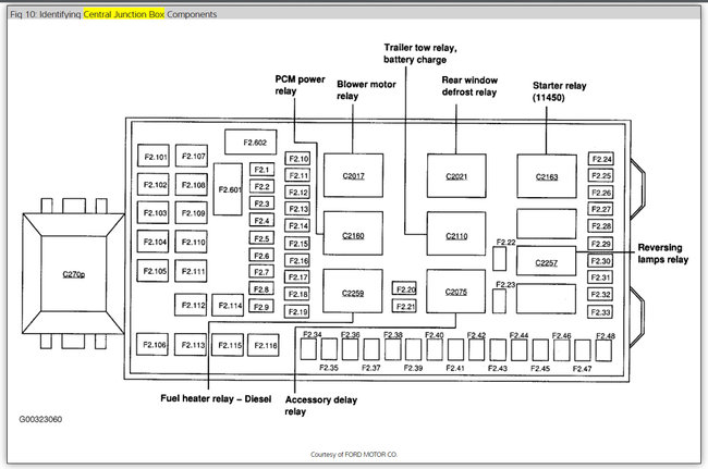

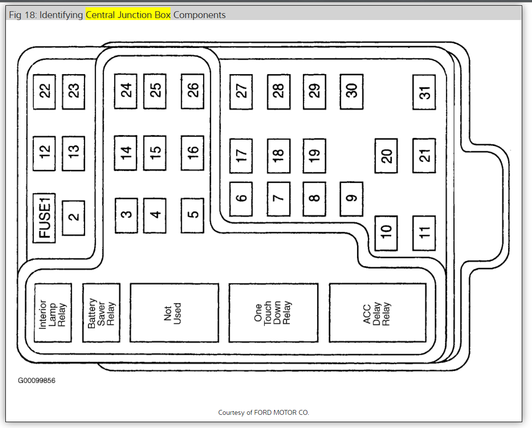

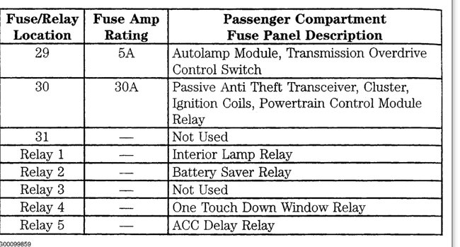

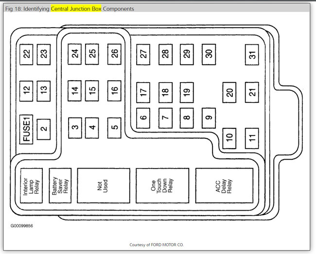

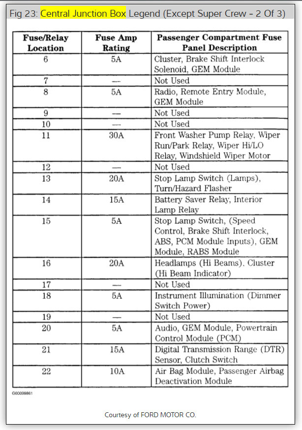

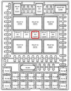

AMBROSE2252
where is the fuel pump relay?

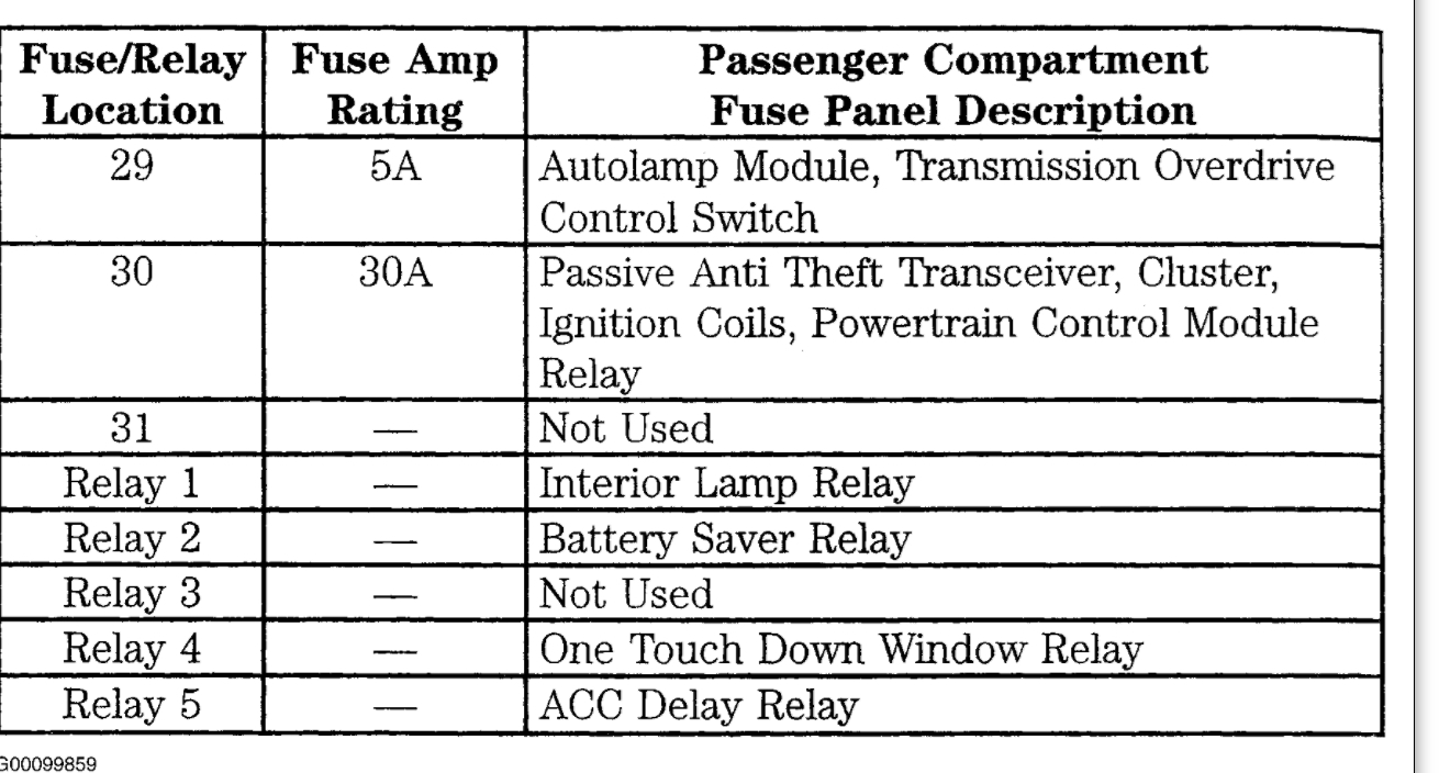

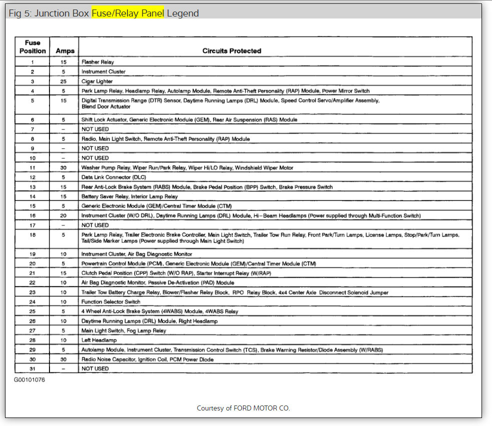

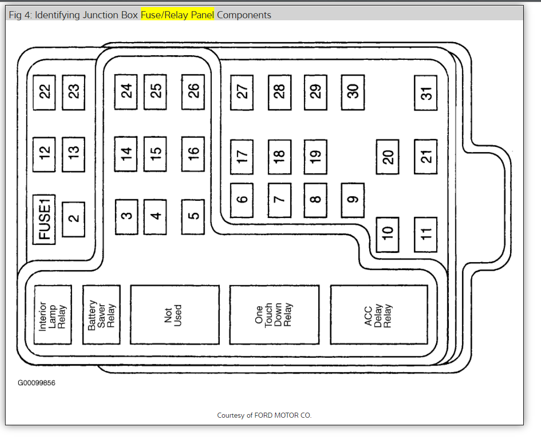

BLUELIGHTNIN6
  • 16,542 POSTS

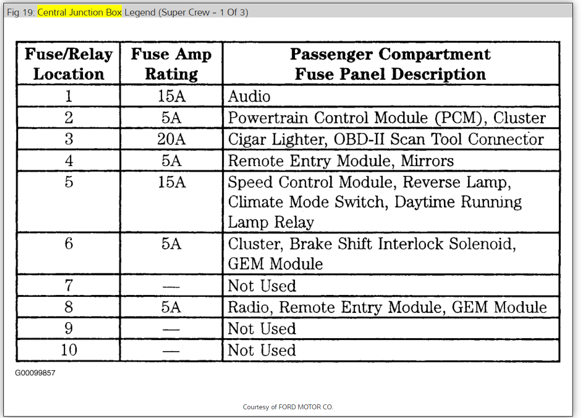

Your vehicle's fuel pump relay is located in the central junction box (relay 303 ) pictured below.
https://images.2carpros.com/forum/automotive_pictures/261618_Noname_348.jpg
The central junction box is located behind the right side kick panel. Thanks for using 2CarPros.com!

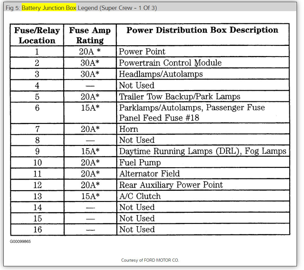

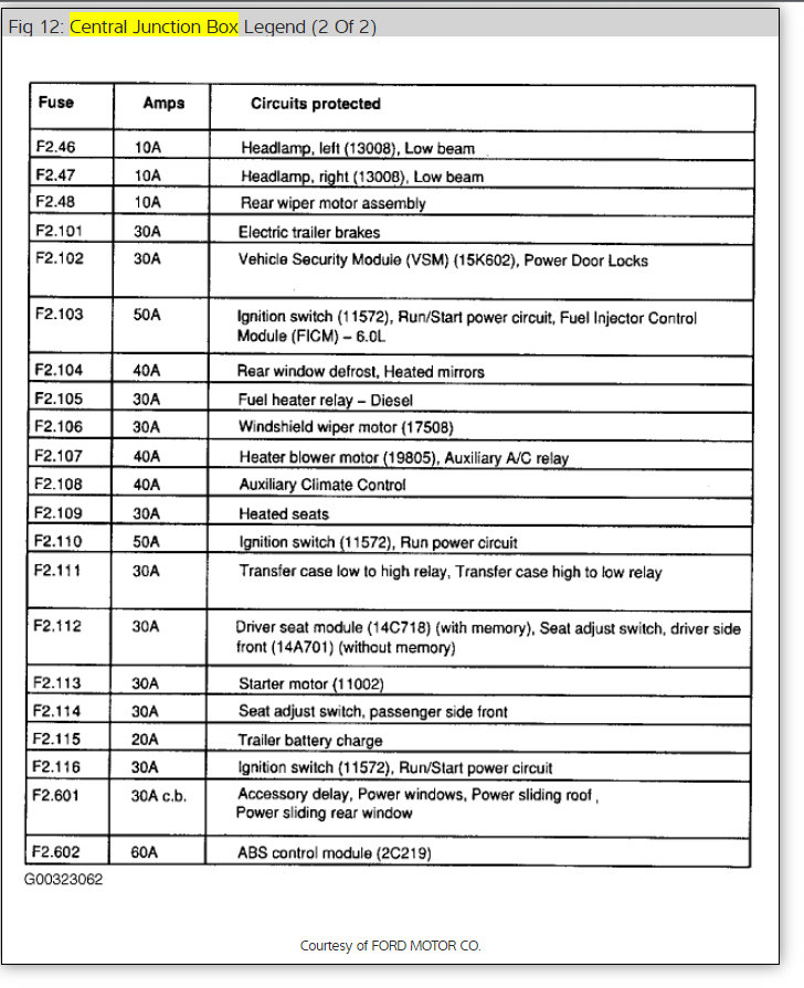

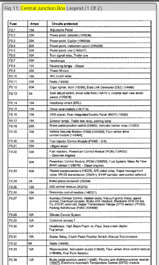

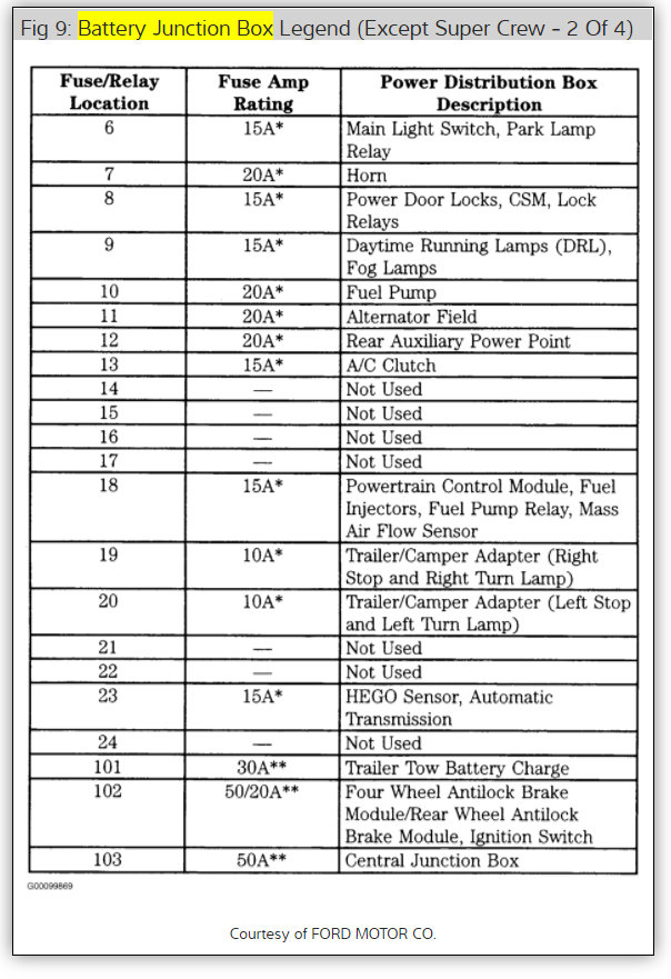

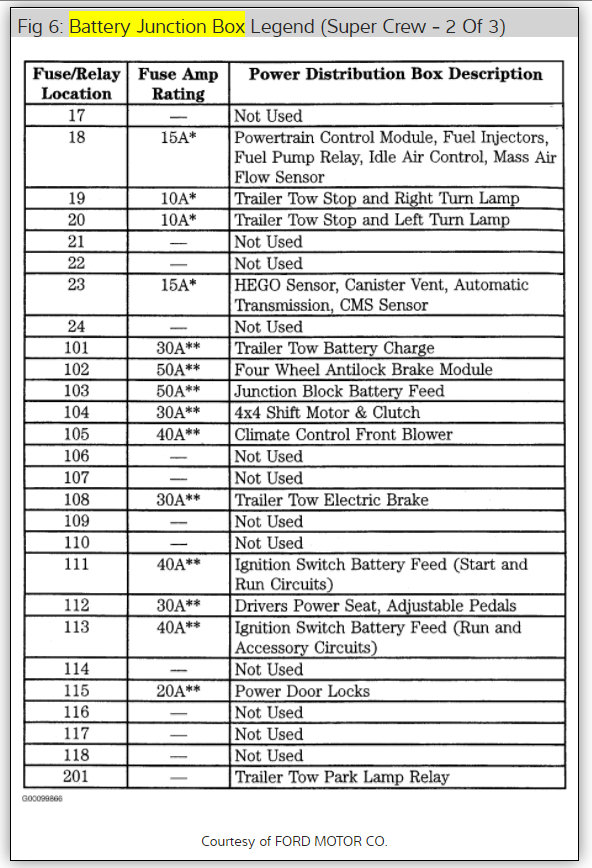

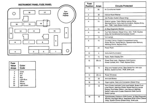

LIMIT
I have a 2001 f150 supercrew and it recently stopped on me, so i check the underhood fuses and see that the fuel pump fuse blew out, i changed it and did it again right away....so next i changed the fuel pump n fuel filter and it started up right away but a few weeks later it happened again so i changed the fuse n blew right away...now i cant even drive it cause as soon as i go to turn the truck on the fuse keeps blowing out....can anyone with this similar problem help me out here....thanks....
MIKE H R
  • 3,094 POSTS
the first thing I would look for is if there is a wire that is grounding out. Start from the fuel pump in the fuel tank and trace the wire going from the back to the front. sometimes it will be hard to get to but if there is a wire that is ground out it might only do it at times if there is a vibration or the wire moves. you say that after you changed the pump and filter it ran ok for a couple of weeks before blowing the fuse , then I would start looking around that area. Also replace the fuel pump relay they can cause a short as well.
Here is its location I have giving you all the relay and fuse locations for your 2001 Ford truck.
Cheers

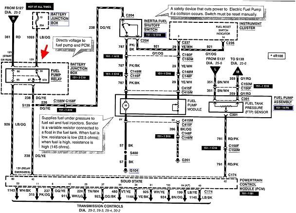

I am only getting 6.89 volts to the fuel pump after changing the pump itself all the fuses the fuel pump relay as well as ECM relay and the ignition module. I have also had the anti theft checked to ensure it is not the problem and it was not. I put a brand new battery in and still crank with no start. Where am I losing voltage and why am I not getting power to my pump? Help please God bless
CARADIODOC
  • 34,381 POSTS
There is a number of things we have to consider before starting the diagnosis. First, if you were measuring that 6 volts at the fuel pump's connector with it unplugged, that may be confusing the real cause of the problem. This would be similar to standing on a garden hose and blocking ninety nine percent of it. You would still see full pressure at the nozzle, as long as it was closed. No water is flowing, so no pressure is dropped across your foot. Voltage is electrical pressure. With the connector unplugged, no current is flowing, so no electrical pressure, (voltage), is dropped across some undesirable resistance in the circuit.
The ignition switch does not need to be on for this. The jumper will energize the circuit, and the fuel pump should be running. If it is, this entire part of the circuit is okay. If it is not running, now is the time to work your way through the circuit with the test light.

My truck just died one day and will not start. If you spay starting fluid it will start. The pump does not kick on with the key so I took it out and tested it directly to a battery it runs fine. So i continued to look for electrical issues. The cut off switch on the passenger side is not tripped all fuses are fine I just am getting no power to the plug under the truck. It is a 4.2 v-6.
BLACKOP555
  • 10,386 POSTS
are you getting power to the relay terminals 86 and 85 when key is turned on ? what is yoru readings at terminals 30 and 87 and 30 and 87a? do you have voltage going to the shut off switch?
This guide should help with the fuel pump relay below.

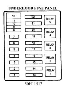

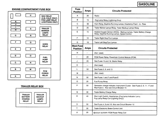

dual tanks - rear pump works - front pump sometimes - in power distribution box, which relay works front tank? thanks for the quick reply about the #2 relay - does this mean that there is only one relay even with 2 tanks? it is the front tank that I'm interested in.
May 29, 2021 at 4:04 AM (Merged)
DAVE H
  • 13,384 POSTS
Fuel Pump Relay.....On engine bay fuse/relay block. relay # 2
https://images.2carpros.com/forum/automotive_pictures/266999_fuse_14.jpg
Fuel Pump Actuation When ignition switch is turned to START position, PCM operates fuel pump relay to provide fuel for starting engine. PCM senses engine speed and shuts off fuel pump by opening ground circuit to fuel pump relay when engine stops or speed drops to less than 120 RPM. When ignition switch is in ON position, EEC power relay is energized (contacts closed). Power is provided to fuel pump relay and timer in PCM. Fuel pump receives power through fuel pump relay contacts. When dual tanks are used, each tank is equipped with a low pressure pump. Such a system has a total of 3 pumps: 2 low pressure and one high pressure. High Pressure Fuel Pump The high pressure fuel pump is positioned inside fuel tank. A reservoir is built onto pump and sender assembly. In a 2-tank system, sender assembly handles switching of high pressure fuel through internal valves. Should one tank overfill during use (return line returns fuel to wrong tank), pump and sender unit in overfilling tank need replacement. The high pressure fuel pump is capable of pumping over 33 gallons (125L) of fuel per hour at a working pressure of 39.2 psi (2.75 kg/cm2 ). This pump also has internal pressure relief and discharge check valves. Mechanical Selector Valve A driver-operated selector switch controls selector valve for switching fuel supply from one tank to another. This valve switches fuel supply and return lines from one tank to another in response to fuel pressure from in-tank pumps acting on its actuating diaphragm. The diaphragm switches tank connection when less than 2 psi of fuel pressure is acting on upper side of front tank and lower side of rear tank. Valve function depends upon proper operation of in-tank low pressure pumps. In all dual-tank vehicles, excess fuel not used by engine is returned to same tank from which it was pumped.*****
RLM18
The truck started running rough and now is hard to start. Checked out plugs and wires. Noticed the fuel pump does not shut off when turning the key on. Tried swapping around relays but i do not which is which. I may have mixed them up. There are 3. Two are the same. I do not have a manual. Which relay goes where? What else could cause the fuel pump to not shut off? Thank you.
JDL
  • 16,098 POSTS
Hi, thanks for the donation. Relay number 2, should be for the fuel pump. If you got the relays mixed-up, read on the relays, if the diagams-- amp rating--model numbers are all the same, it won't matter which relay goes for the fuel pump as long as it is functional. If you plugged a faulty relay into a different circuit, it could effect that circuit. I'd have to test the circuits at the fuel pump relay, there is a power relay that sends voltage to coil side of fuel pump relay, I'd check that also. The pcm grounds the coil side of fuel pump relay in orfer to energize.
https://images.2carpros.com/forum/automotive_pictures/170934_ford_f150_underhood_fuse_box_1.jpg

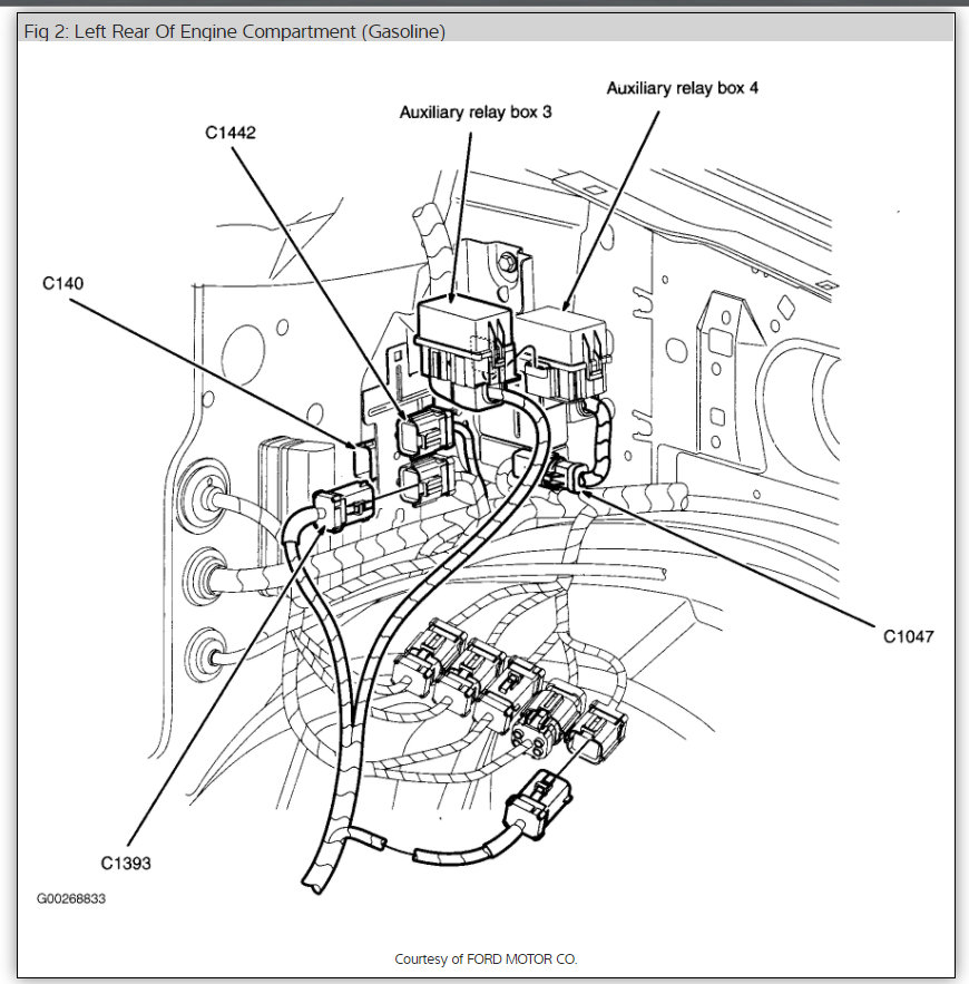

how do I find the fuel pump relay in a f150?
BLACKOP555
  • 10,386 POSTS
your fuel pump relay should be located on the air cleaner box on the side up near the mess of wires on driver side of the engine this guide will help test it with the location of the relay in the diagrams below.

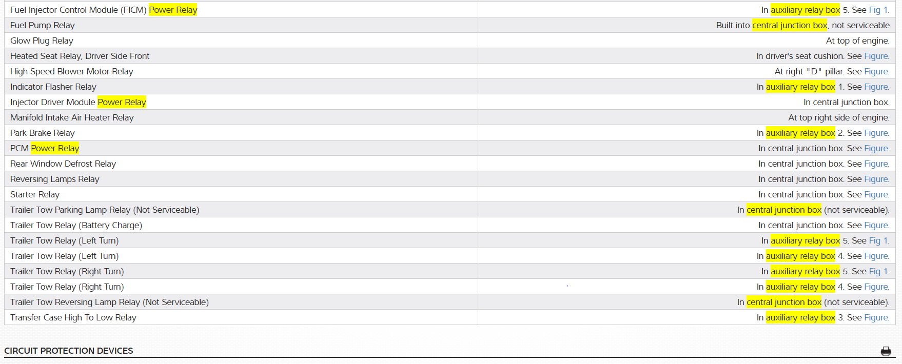

The fuel pump relay is in the engine compartment fuse panel. Here is a guide to help test it and the location of the relay below.

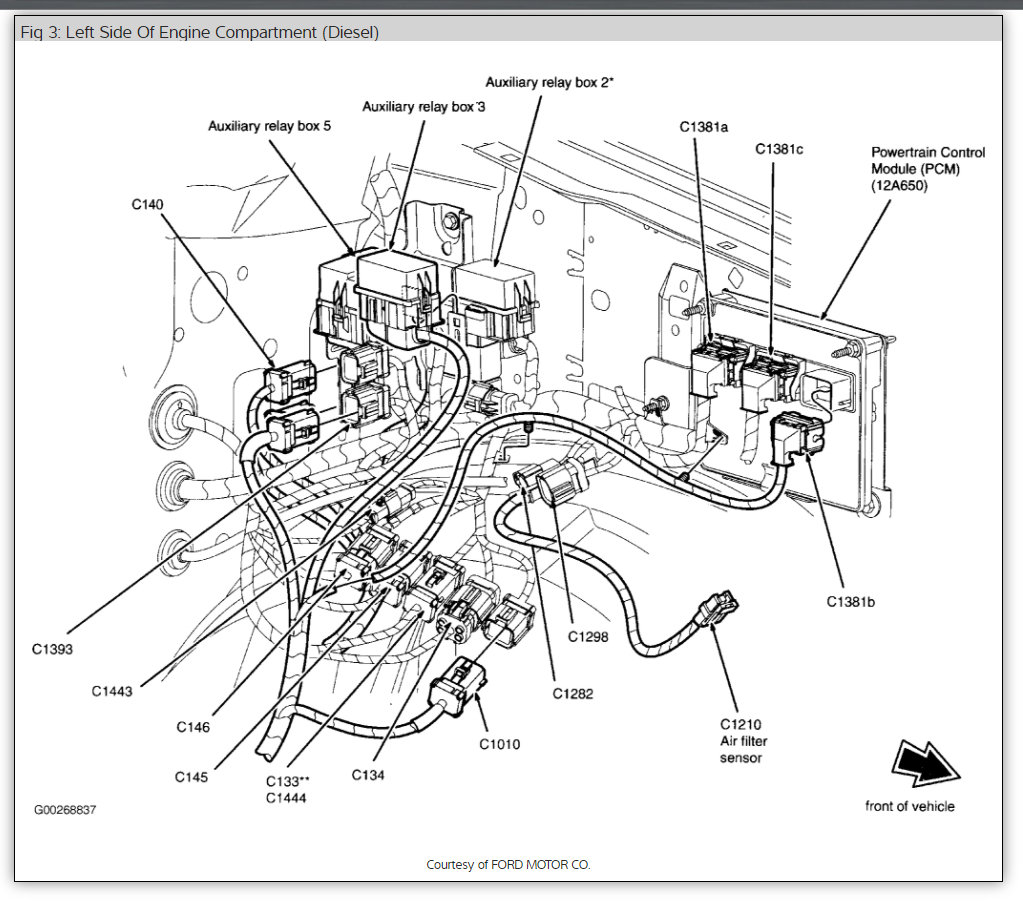

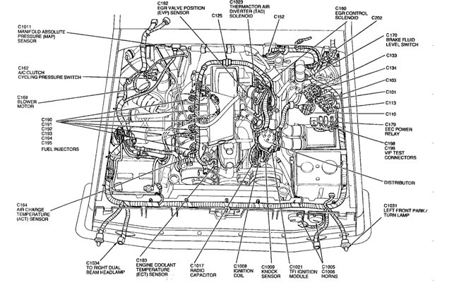

  • 110,244 POSTS
Have you tried replacing the relay again? The pump may be going bad and burning up the relay. This guide can help with the fuel pump relay in the diagrams below.
LH Side Of Engine Compartment, On Relay Bracket. Fuel pump relay is next to the EEC Relay. Check out the diagrams (Below). Please let us know what happens.

KEVIN HAMMOND
Hello I have an 89 f150 with a 4.9 it quite on me yesterday so fare I have found that the fuel pump is not coming on so I checked the fuel pump relay by jumping it with a wire and can hear the pump come on but the truck will not start but with the relay in place I don't hear the pump come on. I checked to see if the truck is getting spark and its not so can some one please give me some other ideas as to what it might be I'm all out of ideas myself. Thanks
CARADIODOC
  • 34,381 POSTS
Excellent. Too many people get hung up on the first thing they find missing, but you thought to check further for spark.
The Engine Computer turns on the fuel pump relay when it receives sensor signals that also tell it when to fire injectors and ignition coils. The common suspect is the pickup coil inside the distributor but also consider the ignition module on the side of the distributor.

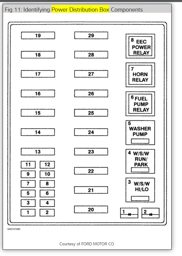

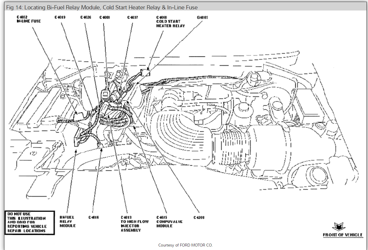

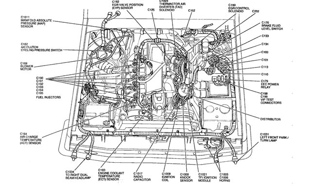

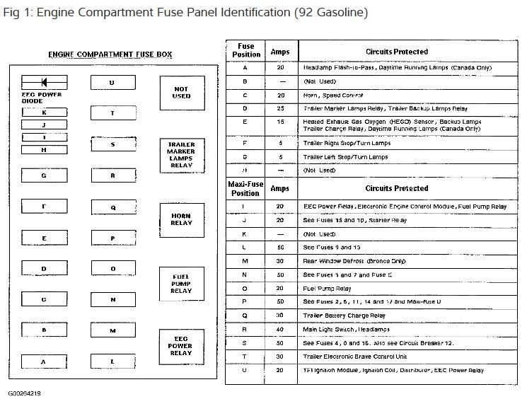

88FORD
hi, on my 88 ford i am looking for resons why the fuel pump was not working and i was going to go ahead and change my fuel pump relay and there are two relays right buy the eec relay. One i belive should be the fuel pump relay but im am not sure.so are there two relays (only 1 tank)
  • 75,992 POSTS
https://images.2carpros.com/forum/automotive_pictures/12900_fp_relay_7.jpg

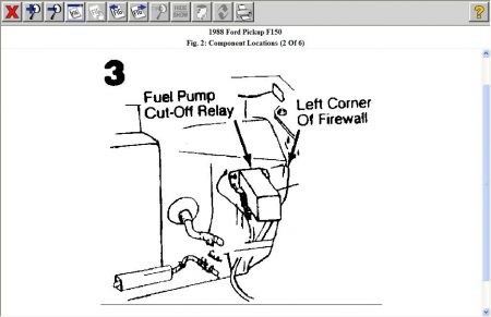

CAHUGHS
Can you give me the location of the fuel pump relay for a 1988 Ford F150 with a 302 v8 w/ manual transmission? All other posts I've found for this type of vehicle and the repair guide I have, which covers many model years, indicate that it's in the main fuse block under the hood (left fender). Mine has no such fuse block under the hood. Any suggestions?
INDYUKE
  • 416 POSTS
Right next to the intake airbox. It just looks like a plastic bar. You need to reach under and grab the relay and pull it down and out, then unplug it. Sometimes they're labeled.
