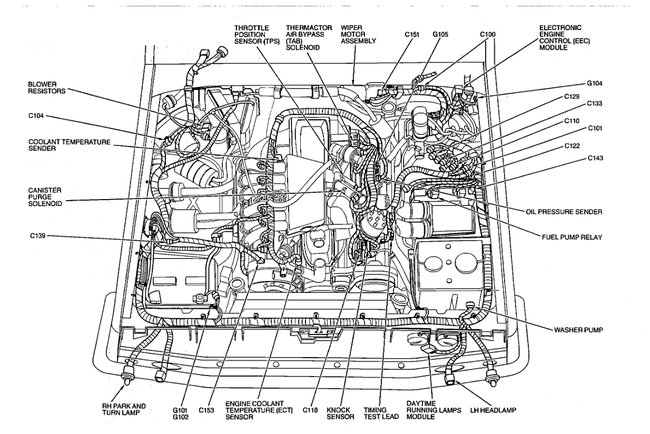

Needing to find the location of the fuel pump relay for a Ford F-150. Any help would be appreciated. Thanks

Here is a guide to help you check the relay which is under the hood on the left side fender check out the guide and the diagrams below.

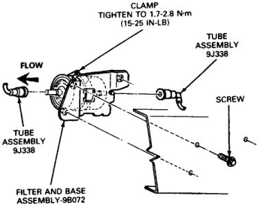

Where is the fuel pump and filter located on a 1987 ford f150 v8 302 5.0l 2wd. Please help

https://www.2carpros.com/forum/automotive_pictures/12900_fp_55.jpg
The High Pressure Pump is mounted on the Frame Rail.
Dual Tank
The Low Pressure Pumps are mounted inside each of the Front and Rear Fuel Tanks.
Single Tank
The Low Pressure Pump is mounted inside of the Fuel Tank.
Fuel filter:
https://www.2carpros.com/forum/automotive_pictures/12900_ff1_8.jpg

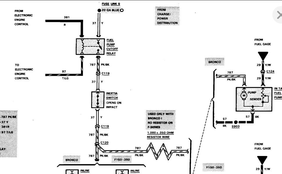

Good afternoon, we had our great running truck 5.0 engine transported to our son in the Army. Since it was delivered once it got off the transporter it had trouble starting. The next day acted up next day would not stay running etc. Well to get to where at now my question is, the fuel relay and the fuel pump are good they are not getting power. Any and all help greatly appreciated.

You should have two powers at the relay with the key on. The red and the yellow wire should have battery voltage.
Check that to be sure you have power. I attached a wire diagram for you to view for the diagram. The feed for the yellow wire comes from a fusible link. The red wire comes from the ECM.
