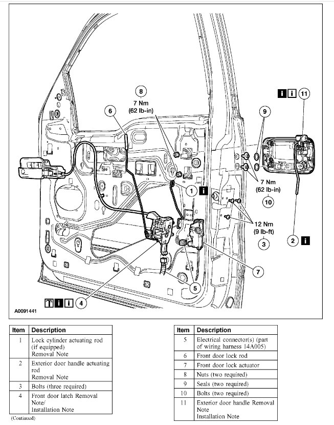

where is the door switch for this at?
Dec 11, 2007 at 3:06 PM
  • 54,837 POSTS

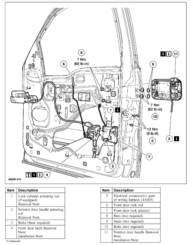

It should be in the door latch itself. Remove the door panel and you can see the wiring going to the latch. Here is an image to help. Check out the images (below). Please let us know what happens.
