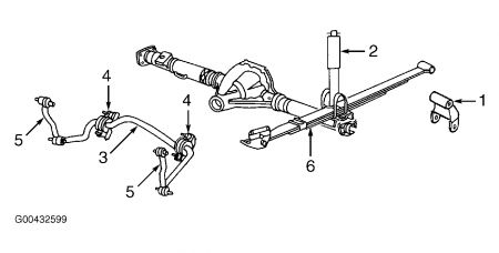

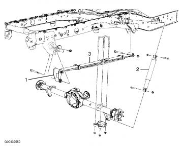

I have a 2003 f150 supercrew 4x4 i need new leaf springs. I took the overloads off years ago, never hauled anything. Now, I haul heavy items, and I bent the leafs, Does anybody know if any other years of f150's will fit my 03. I'm looking into buying some 04 f150 leaf springs can anybody tell me if they would fit or what can I do, or point me in the right direction? Thanks

the 2003/2004 spring fittings are different for the F150 so will not interchange
https://images.2carpros.com/forum/automotive_pictures/266999_2003_1.jpg
2003
https://images.2carpros.com/forum/automotive_pictures/266999_sp2004_1.jpg
2004 the 2003 & 2004, F250 & F350 superduty leaf springs should fit ... but i don't understand why your just not doing a straight like for like swap ??
