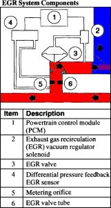

Having the computer readout by Autozone says the EGR valve is bad again. I say again because I have replaced it less than a year ago and previously the year earlier.
I have been downsized and so need to do this work myself. Is there something I could have done to to cause the EGR valve to fail or could there be something causing the failure?
Wednesday, September 9th, 2020 AT 6:17 PM (Merged)
ISLAND_PRIDE71
  • 62 POSTS
Try checking the rest of the DPFE/EGR as you see below:
https://www.2carpros.com/forum/automotive_pictures/294624_dpfeegr_1.jpg
JEEPLVR_2
Had the same problem # 4 in the diagram above, EGR pressure sensor needed to be replaced. Sometimes a little particle gets on it from dirty fuel especially after that many miles, I only had 70k when mine went out. Change it have the service light shut off and see if that works.
