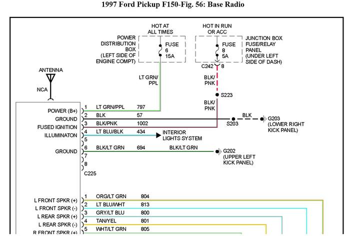

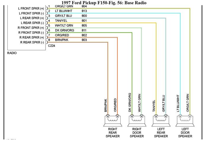

Six cylinder two wheel drive automatic.
My deck has four wires; red, black, yellow, blue. I have all the speakers hooked up correctly but the deck only gets power if I twist the red and yellow wires together and and hook them to the black/pink wire on my truck (accessories). My problem is I cannot seem to find the battery constant wire. How to connect the deck properly?
May 4, 2010 at 9:49 AM
BLUELIGHTNIN6
  • 16,542 POSTS
Here are the full radio wiring diagrams for each radio that came in that tuck and a guide to help you test the connections with a video of the radio being installed:
and
https://youtu.be/jF_sDSS0n7I
May 4, 2010 at 9:54 AM
CT_TAZ23
  • 6 POSTS
Thanks. That is the best diagram I have seen yet, but I still cannot find that battery constant. I even tested the remaining wires with a multi-meter with the key out and still no luck. So I was wondering if I could use a bit of heavier wire straight from the positive side of the battery back through the firewall?

So you do not have that color wire? Has the stock radio wire harness been cut before or something?
May 4, 2010 at 2:55 PM
CT_TAZ23
  • 6 POSTS
They are all there, but I can only find twelve volts coming from the black with pink stripe wire with the key on.
May 4, 2010 at 3:06 PM
BLUELIGHTNIN6
  • 16,542 POSTS
Try hooking your yellow wire to the trucks cigar lighter. That should work. Your stock radio may not have been wired to remain on with key off.

HENRY DERUELLE
I have a 2001 F150 XLT super crew cab. Trying to find the ground wire for after market FM mp3 stereo. Diagram I found on line says the ground wire is black/light green but there are two wires that match the color. Do I wire both blacks for my ground wire on the radio?
Dec 28, 2016 at 6:06 PM
  • 55,423 POSTS
Hey HENRY,
Yes, you can use either ground wire will work.
Please let us know happens so it will help others.
Best, Ken

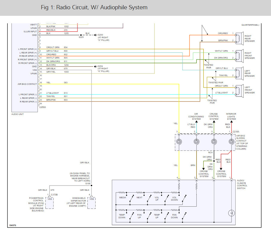

STEVENBRNNN5
The colors are black/purple, green/black, black, black/green, blue/dark blue.
Jan 3, 2017 at 4:37 AM (Merged)
  • 75,992 POSTS
Do you have the base radio or the premium sound radio?
KHLOW2008
  • 41,814 POSTS
Here is a schematic of the radio circuit. I cannot seem to find some of the colors you have indicated.

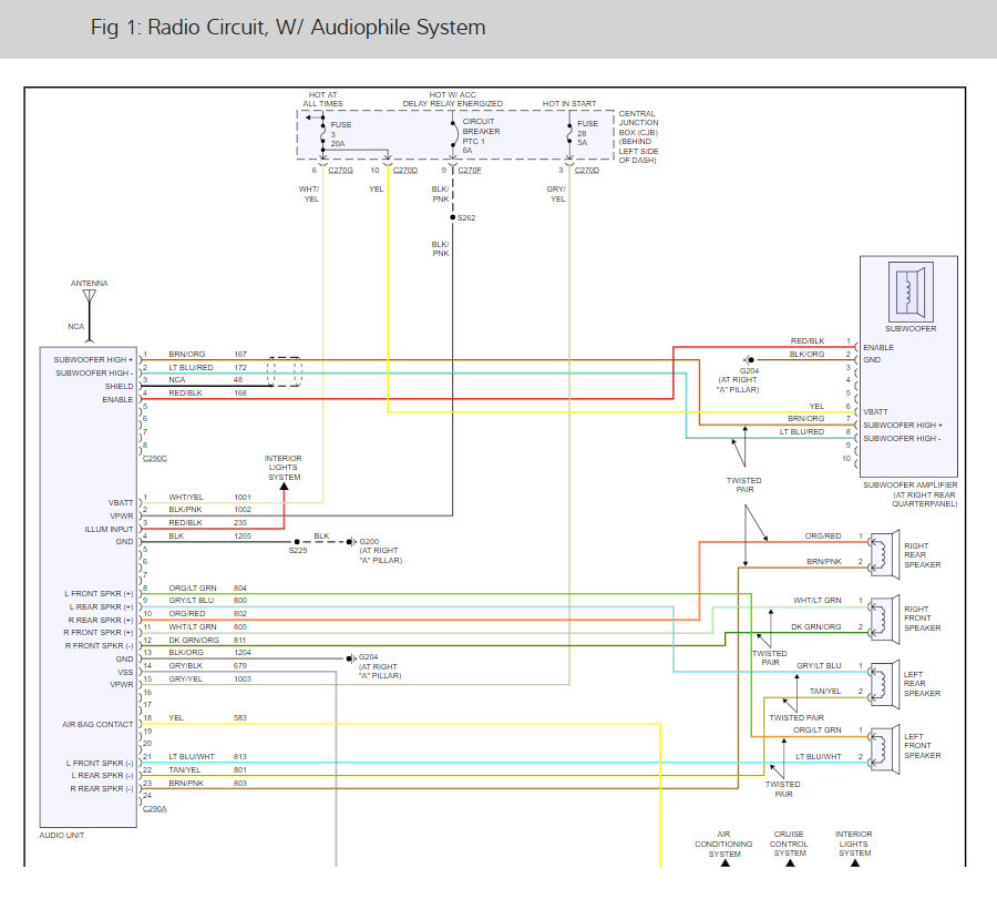

PAGE13
Installed a dual XDM6350 radio using wire harnesses. If I hook up the radio illumination wire (solid orange) to constant power the radio works if lights are off. If I hook the wire to switched power, it only works when lights are on, tried every combination I can think of but cannot seem to get constant power no matter what. Also, when orange is hooked to the constant, I have no dash lights. Any suggestions?
KHLOW2008
  • 41,814 POSTS
Hi Page13, Thank you for the donation. What is your original radio specs, base or premium (with amplifier)? From both types of radio wiring schematics, I am not able to find any solid orange wire. Do you have the wiring schematics for the new radio that you have installed?
https://images.2carpros.com/forum/automotive_pictures/192750_RadioWiring94F150Fig57a_1.jpg
https://images.2carpros.com/forum/automotive_pictures/192750_RadioWiring94F150Fig58a_1.jpg

HENRY DERUELLE
Had my factory radio stolen from my truck. (Wire harness was cut.) Bought a FM mps3 deck to replace original. Question is wire diagram I found on line lists the ground wire as being black/light green. I see two wires with that color. do I take my black ground wire from the deck and connect it to the other two?
Sep 21, 2018 at 5:46 AM (Merged)
CARADIODOC
  • 34,381 POSTS
You do not need both wires. One is for the radio section and one is for the amplifier section. Both wires go to the same ground point on the truck. Either one will work for your ground wire.

CARL TODD PEABODY
Need the correct colors to install a aftermarket radio. Need amp turn on wire and both twelve volt wires please. Help sitting in the truck, at a loss.
STEVE W.
  • 15,347 POSTS
15A Fused - Battery - light green with violet trace
5A Fused - Hot in run or accessories-black with pink trace.
5A Fused - Hot in start only - red with black trace.
Remote on. Was not in base models only up-level units with CD changer.
Light green with black trace.
Illumination wire - light blue with black trace.
