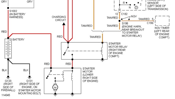

I need to see a diagram of how to wire the starter
Sep 6, 2009 at 6:59 PM
  • 54,859 POSTS
Here is a wiring diagram of the starter you where looking for I have also found a guide on how to check the wiring as well.

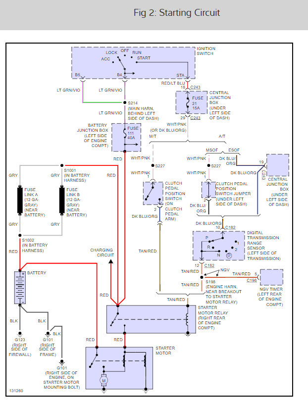

no power to starter solenoide
Jan 20, 2021 at 12:53 PM (Merged)
JDL
  • 16,098 POSTS
Which wire isn't hot? Might be a problem with transmission range sensor? Note wiring below. Check out the diagrams (Below). Please let us know if you need anything else to get the problem fixed.

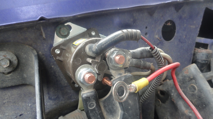

tried to crank truck over and was making a click sound my dad told me it was the solenoid. bought a napa solenoid, but it wasnt a direct replacement it came with the I stud original only came with M B and S, anyways hooked up new solenoid and got no power for nothing so i figured i had it hooked up backwards, so i switched places with the M and B and got power and truck started up problem and question is that the starter wasnt disengaging when truck was running so turned off ignition and unhooked the S terminal and battery to turn it off. did that a few more times and new solenoid is done for and will not even kick truck over just the same clicking sound just like before. so can anyone explain why that was happening my truck has four wires that hook up all together 1.the m and b terminal wires,2.altenator wire 3.the starter wire.4. headlight and other electrical wire. please some help i tried to put as much detail into this. ( on stock solenoid all of the wires listed 2-4 hooked up to b terminal and thats what i hooked up to napa solenoid but difference was the starter wouldnt disengage.)

Sounds like you had the wires on the two large studs switched around. Your truck does not need a fourth terminal on the solenoid for an ignition bypass but most replacement solenoids have that terminal so it can also be used on older Fords. If you hook the red / blue wire to the wrong small stud and the wires are reversed on the large studs, it is possible for it to work once then to stay engaged. The small terminal will continue to get voltage through that internal connection that is incorrectly going to the battery. That's why you would also have to disconnect the battery cable.

Any chance you could post a picture of the old and new solenoids? If you reinstall the old solenoid, can you connect the wires the way they were before to verify it acts the same as before? Also, can you see the starter so you can describe it to me? Do you see a perfectly round solenoid bolted to the top of the starter or is there a tapered sheet metal cover on it?
Jan 20, 2021 at 12:54 PM (Merged)
CARADIODOC
  • 34,321 POSTS
Here's the solenoid on a '94 Tempo. This is what I'm expecting your original one to look like.
FORD150
  • 6 POSTS
yes mine is a fender mounted solenoid the oringinal came with only three terminals M,B,S ,the main battery wire goes to M+B and the starter plug wire goes to S terminal.the other 3wires lay over B terminal witch if im right is on the right side of solenoid saying S terminal is north,,, yeah that was what i was going to do is put original back on and see if it still makes clicking noises again, (does the sequence of the wires order have anything to do with it,, lets say if i didnt put the wires in direct order over the B terminal saying red was on top then the yellow then other yellow would that have anything to do with it?)
CARADIODOC
  • 34,321 POSTS
I'm not familiar with the letter designations or any yellow wires. In the photo above, the large stud on the right has a single wire that goes to the smaller terminal on the starter. No other wires will be on that stud.
All of the other wires with eye terminals go on the large left stud. The order doesn't matter. One of those wires goes to the battery positive post. The stud is just used as a convenient tie point for all those other wires.
FORD150
  • 6 POSTS
that solenoid is similar to my stock one but has less wires i can see your pic has three wires excluding the red plug wire, my wires are different from these maybe i will be able to get a picture and show you then things will make more sense.
FORD150
  • 6 POSTS
here is the pic hopefully it helps
CARADIODOC
  • 34,321 POSTS
My first thought was those two large terminals are reversed. Is it possible that pair is turned around? If not, pull all the wires off the large studs. First be sure the solenoid clicks nice and strong when you turn the ignition switch to "crank". It must release when you release the switch. You'll hear it easily from inside the car. Next, take that pair that are molded together and touch just the one that comes from the battery positive post to its stud on the solenoid. Watch very closely when you touch it to the stud. If you see a small spark, it's on the wrong stud. Either the solenoid or the pair of wires must be turned around.
If there is no spark, connect just those two molded wires and leave the other ones off the large studs for now, then see if it works correctly. Also be sure that unused smaller stud on the bottom isn't touching the larger terminal next to it.
FORD150
  • 6 POSTS
at first the pair were reversed from what you can see on the pic now , the difference was that i was getting no power the other way around so i put them to what you see in picture now and got display lights to come on and headlights + ignition to crank over, so if i try again i want to make sure there is no spark when wires touch large studs?

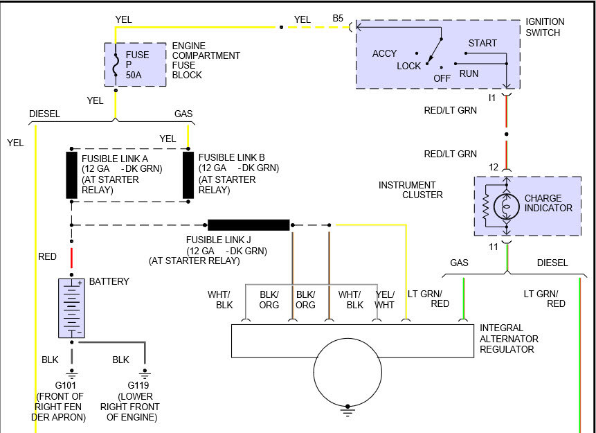

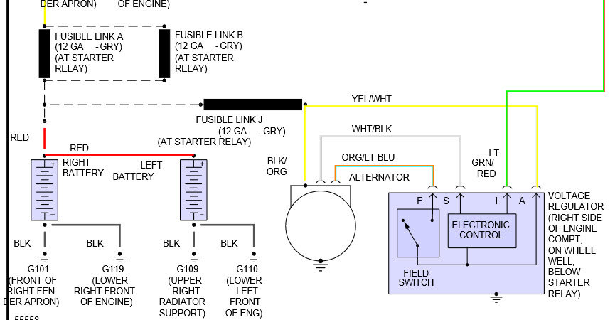

Truck will run if you push it off and pop the clutch. Cannot find a loose ground .Battery light is still on after replacing alternator. Voltage is 11.6 volts with truck running. After replacing all of these parts do not know what to do next.
HMAC300
  • 48,601 POSTS
with truck running you should have 14.3 volts so start by checking fusible links to starter relay and they go to alternator and several other places. one picture is for internal regulator other is external regulator. also check fuse in engine fuse box.

WALTCASTLE34
The starter stays engaged after the key is turned off had to remove the battery cable to stop it how do I fix this? I took the starter out no wire damage or any mechanical issues that I can see. Never had any starter or ignition problems before this please help!!
CARADIODOC
  • 34,321 POSTS
Next time it does this unplug the small red / blue wire from the starter relay. If the starter continues cranking, replace the sticking relay. If it stops cranking, check for voltage on that wire. If you find 12 volts there, suspect the ignition switch.

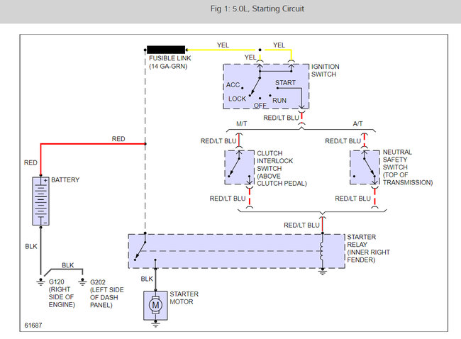

2CP-ARCHIVES
  • 4,540 POSTS
color wire routing from starter relay to Ignition switch
Here is a guide to help you check the wiring and the starter wiring diagrams below
2CP-ARCHIVES
  • 4,540 POSTS
i need to know which wires hook up to the start solonid from the battery it has 5 wires one from the battery one the starter motor ,one to the starter switch then two more on has a fuseable link on it but is showing ground but the guy i got the truch from had it hooked to the same post as the hot wire from the battery and the other wire as well
one from battery to the one side of solenoid, the other side goes to start motor.
the fusible links go where the battery wire attaches as they are feeds for inside the truck.
the remaining goes to the little stud on the solenoid as it is the tickle wire from ignition switch to energise the solenoid thus turning on the starter.
