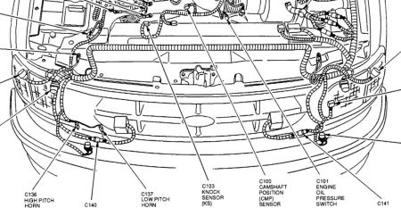

I can not find my Camshaft Positon Sensor location on my ford f-150 truck do you know where its located?

BLUELIGHTNIN6
MECHANIC
16,542 POSTS
It will be on the front of the engine, post your engine size and I will give exact diagram for you

MECHANIC
75,992 POSTS
The Camshaft Position Sensor is located in front of the engine.

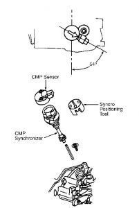

MANUAL
18,500 MILES
Help! I have a 97' F-150, 4.2L V-6. Engine light came on. So I pluged in a code reader, and it gave me two codes, P0340 & P0430. For P0430 I changed the O2 sensor and the code was gone. Now for the last code I changed the Camshaft Position Sensor, But the light wont go away. Now when I changed the Cam. Sensor I didn't secronized the shaft. Could that be why the light is still on?

SERVICE WRITER
MECHANIC
9,123 POSTS
Yes, The shaft itself very well may be bad. The sell new ones at NAPA with the sensor less than $100.

ALMILL3
MEMBER
2 POSTS
1997 FORD F-150
6 CYL
2WD
AUTOMATIC
125,000 MILES
I am getting trouble code P0340 ( Camshaft Position Sensor A - Bank 1 Circuit Malfunction) and I can't seem to find it for replacement. Does anyone know where I can find it and how hard it is to change out? Or do you have any suggestions of why else this code would be showing up if it isn't the sensor itself? Thanks.

SERVICE WRITER
MECHANIC
9,123 POSTS
Your going to likley need the shaft that is right underneath it as well. They are available aftermarket that includes the synchronizer shaft and the sensor. Napa carries it.

SERVICE WRITER
MECHANIC
9,123 POSTS
If I have time later tonite, I'll upload the the R&R procedure, you don't want to do this wrong.

KRISTY MAIRE PENTON
MEMBER
4 POSTS
I also have a 97 F150 4.2L I found the cam position sensor by taking off the air intake hose from the throttle, remove upper radiator hose and two y heater hoses and maybe a few bolts I don't see where the bolts need to come off yet. My question is to prevent antifreeze leakage or waste can I get to it easier from under my truck?

KRISTY MAIRE PENTON
MEMBER
4 POSTS
Also just to replace the sensor not the synchronizer you just unscrew it and put on the new one otherwise you need a special tool and technique for the synchronizer
