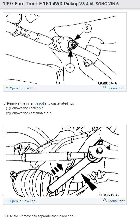

Making a squeaking noise only when I turn the wheel
JTAYS2388
  • 1997 FORD F-150
  • V8
  • 4WD
  • 85,000 MILES

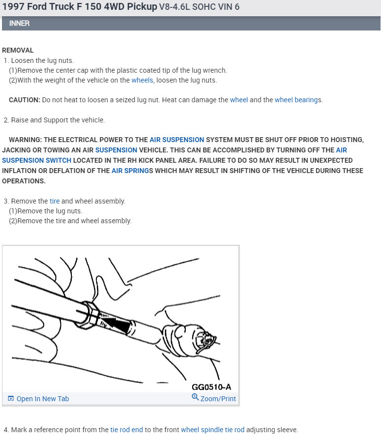

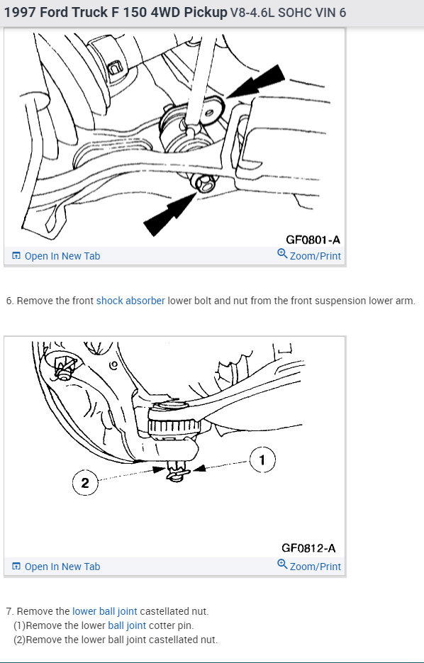

My ford f-150 is making a squeaking noise only when I turn the wheel to the right.I greased everything and the noise has not stopped I was thinking it is my ball joints but I am not sure
Tuesday, July 22nd, 2008 AT 8:16 AM
SQM
  • 6,383 POSTS

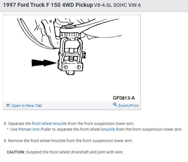

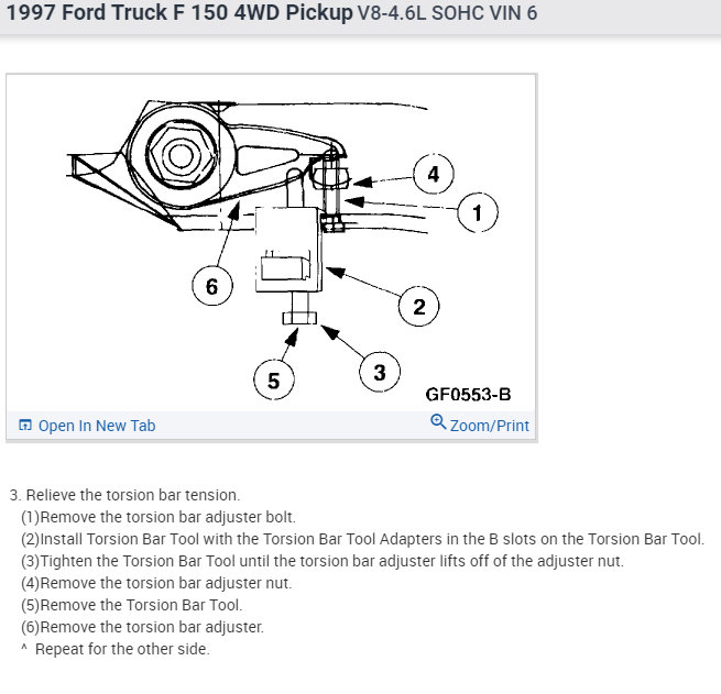

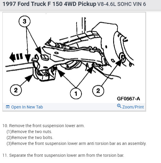

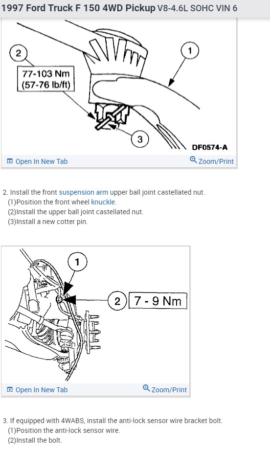

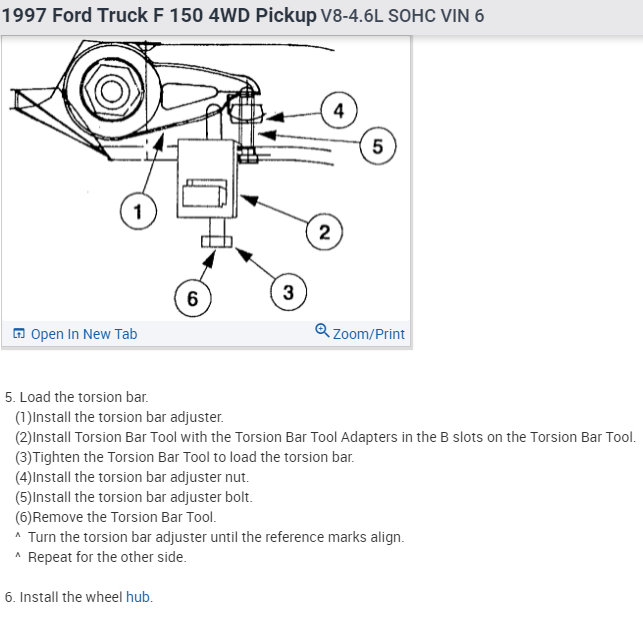

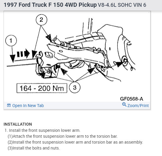

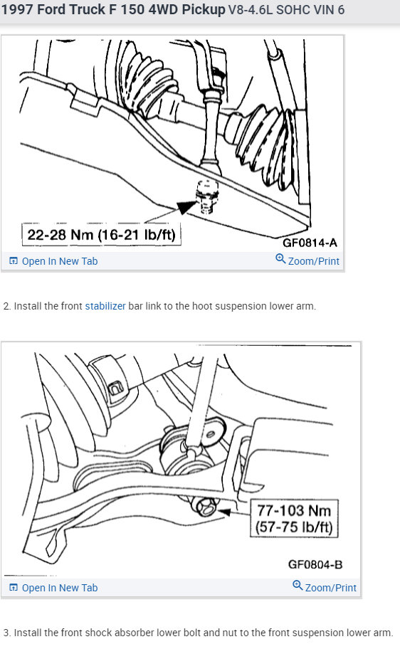

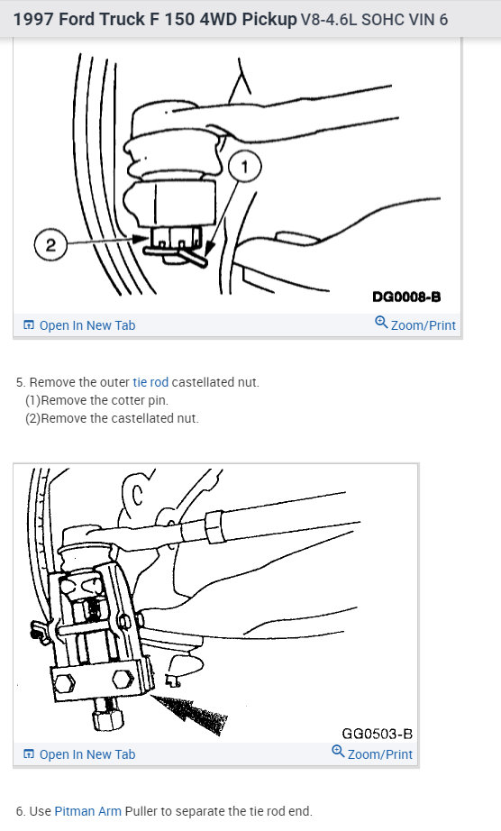

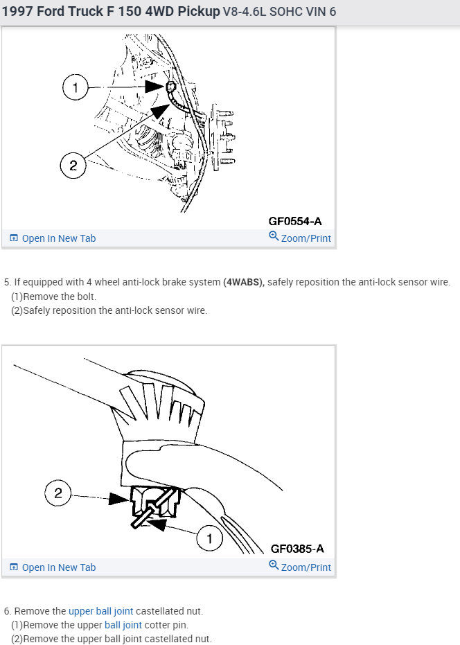

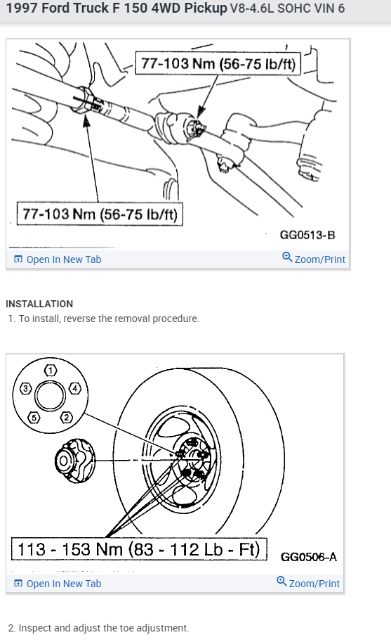

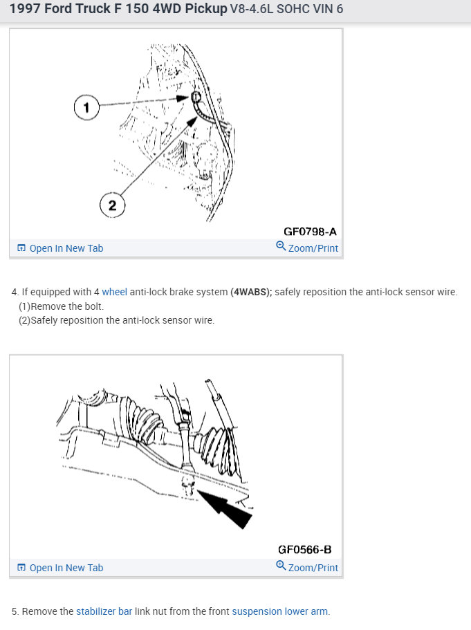

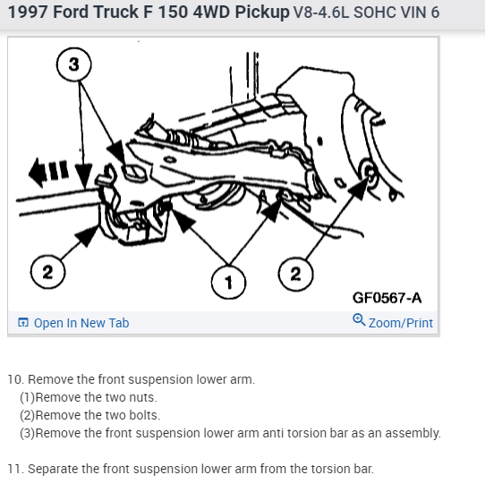

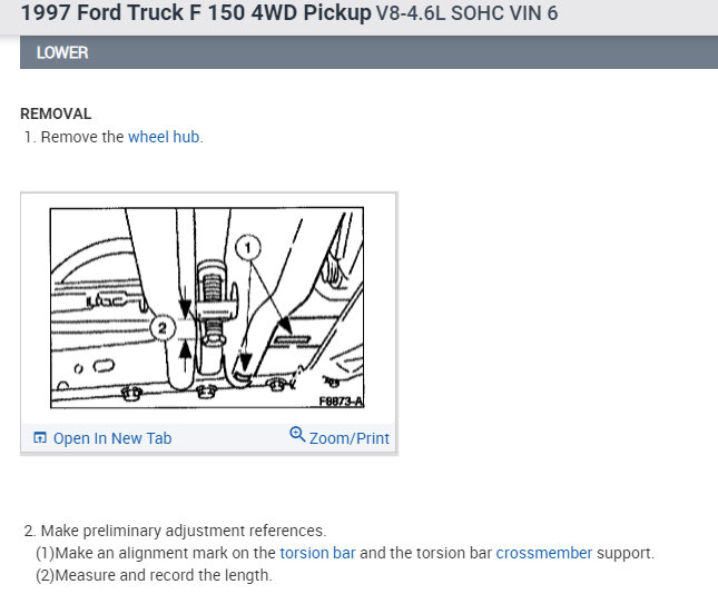

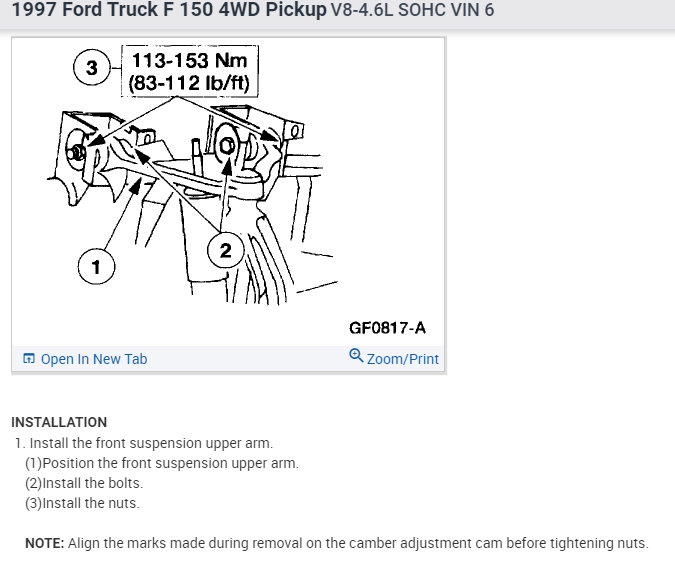

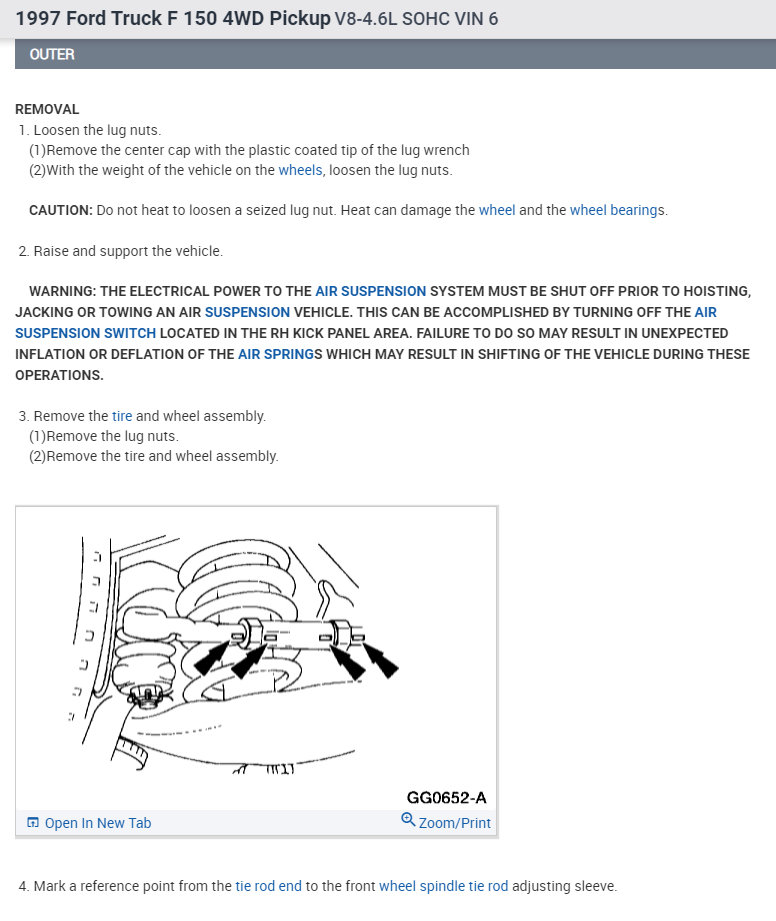

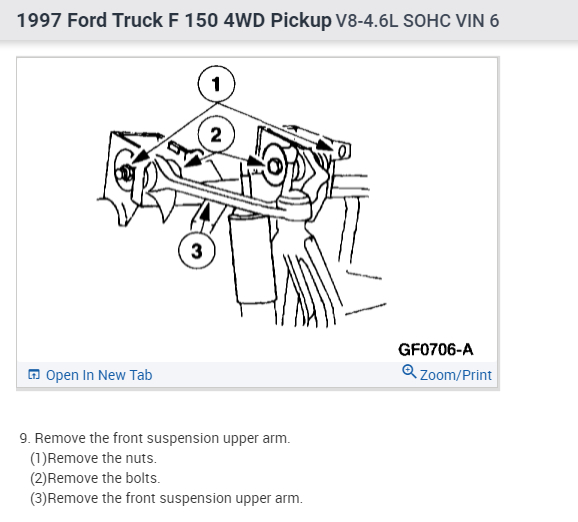

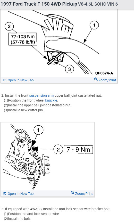

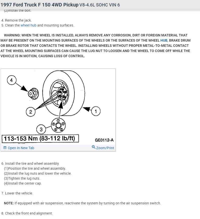

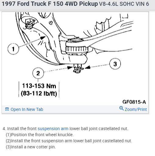

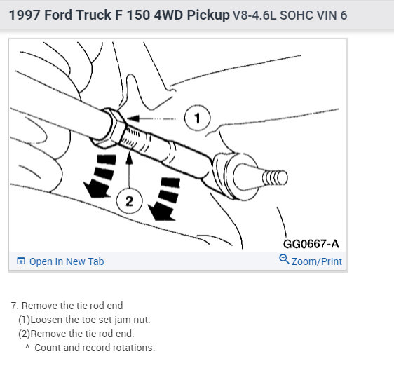

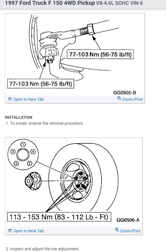

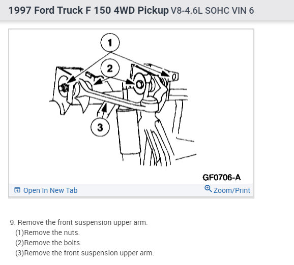

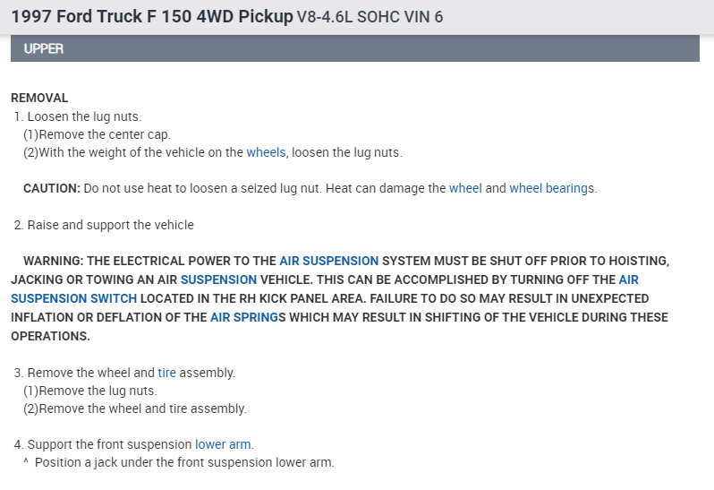

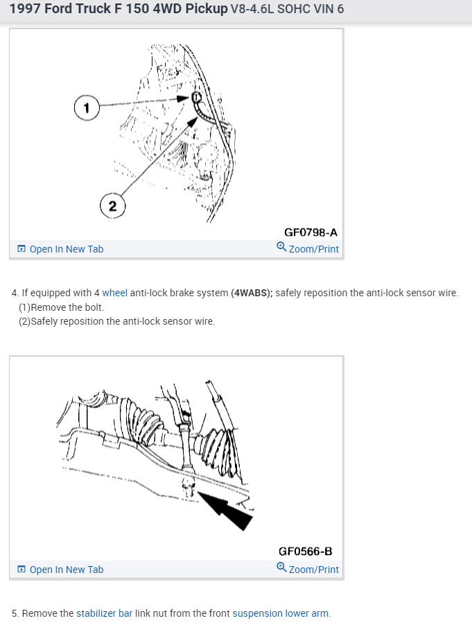

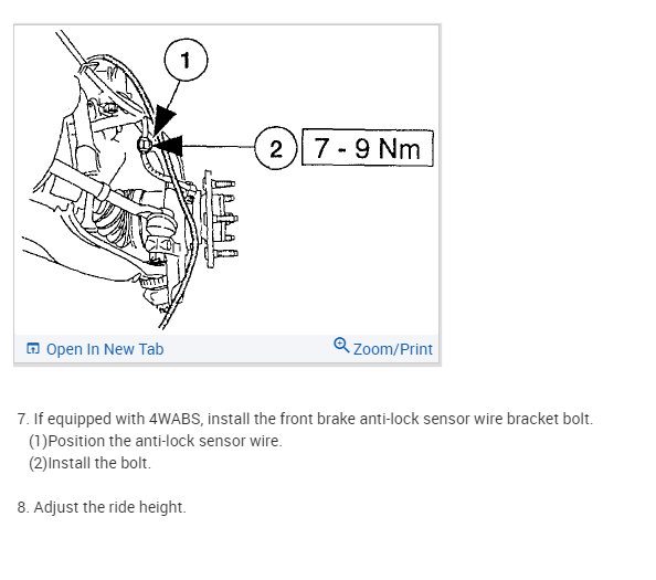

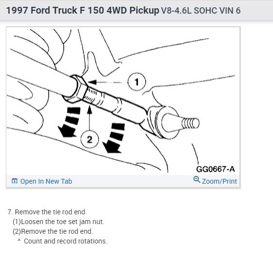

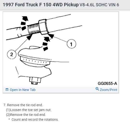

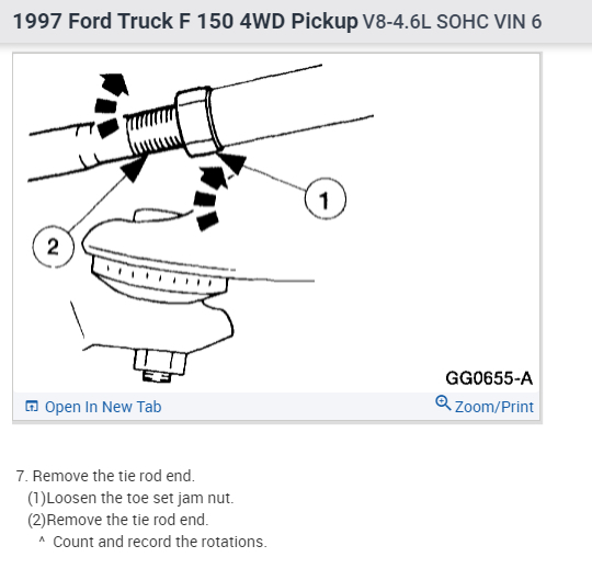

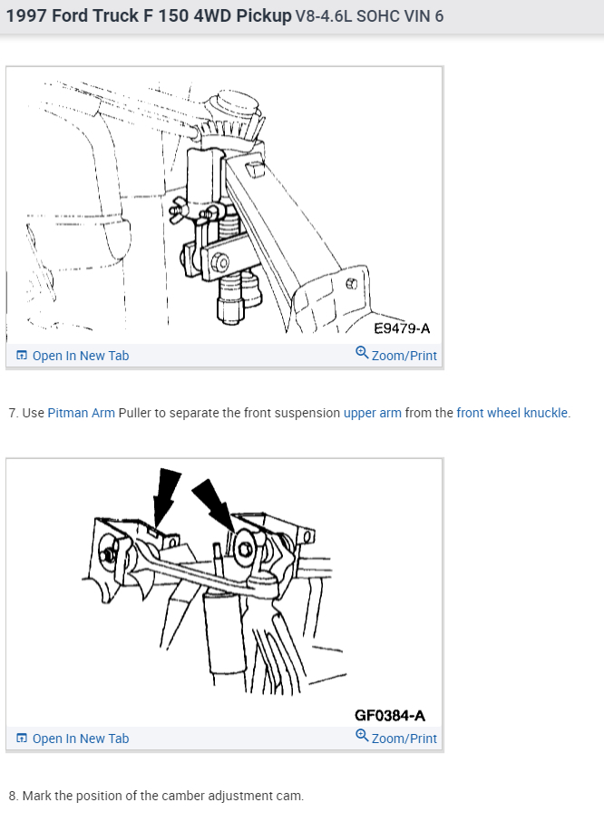

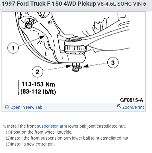

This noise could be from worn tie rod end or control arm bushings.
Check the bushings for excess play.
Typically, when there is too much play in a bushing it will create noise as well as vibration. Since you only hear it when turning, it is likely the tie rod end bushings.
https://www.2carpros.com/articles/tie-rod-end-replacement
https://www.2carpros.com/articles/popping-noise
I have attached the replacement procedures for the tie rod ends as well as control arm below.
