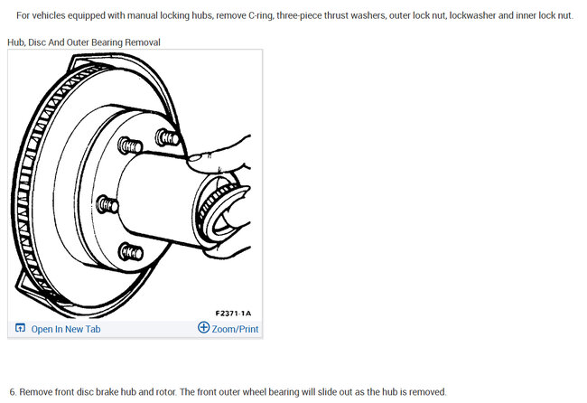

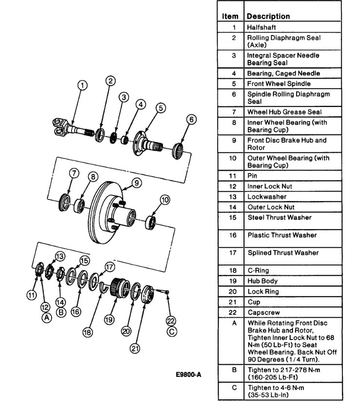

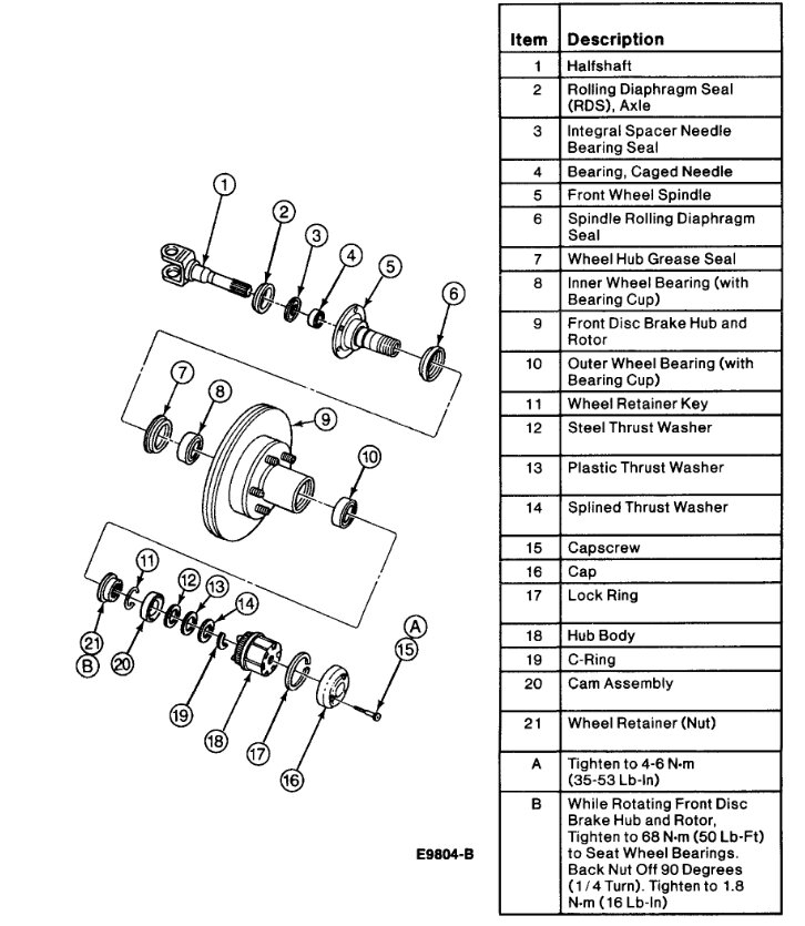

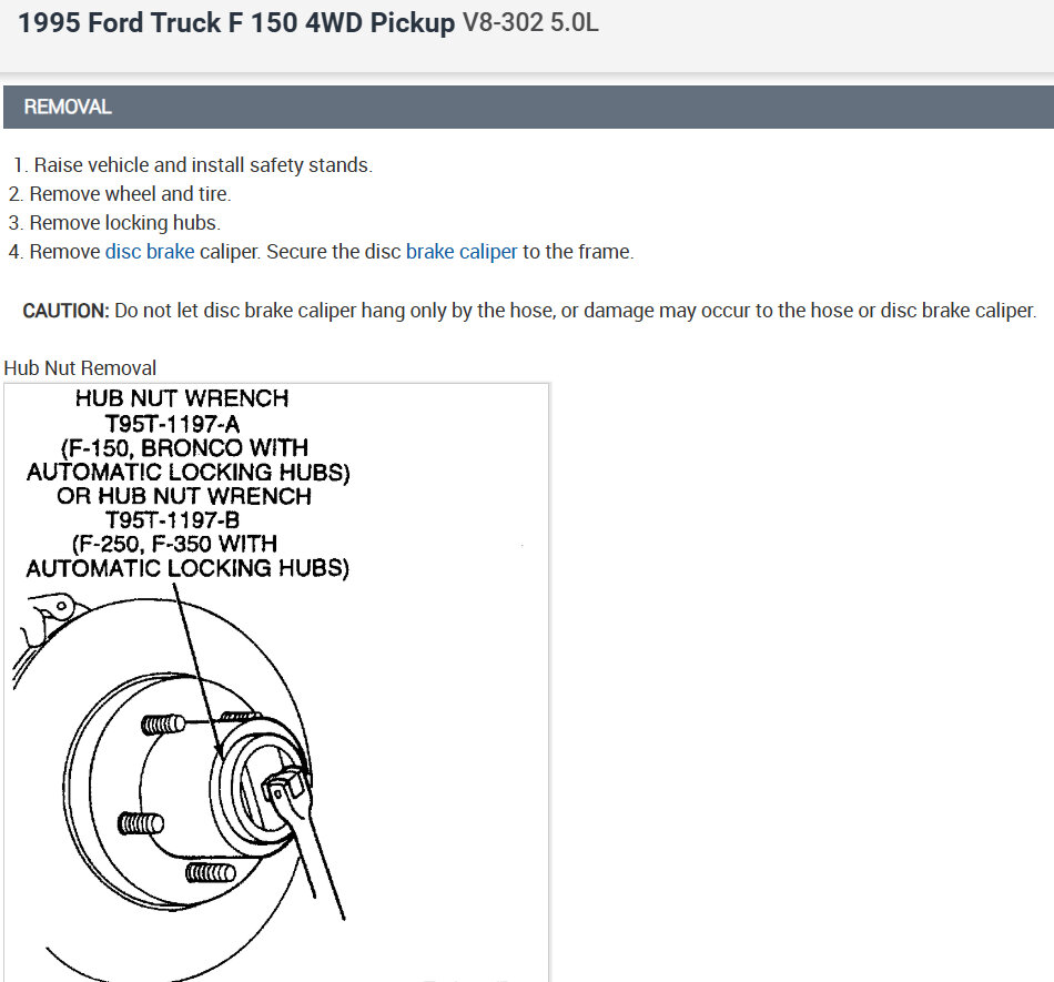

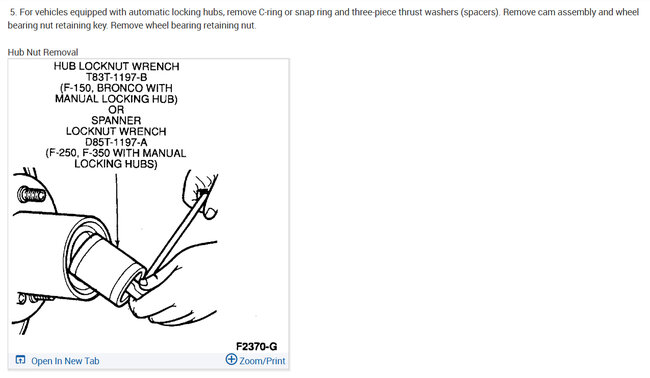

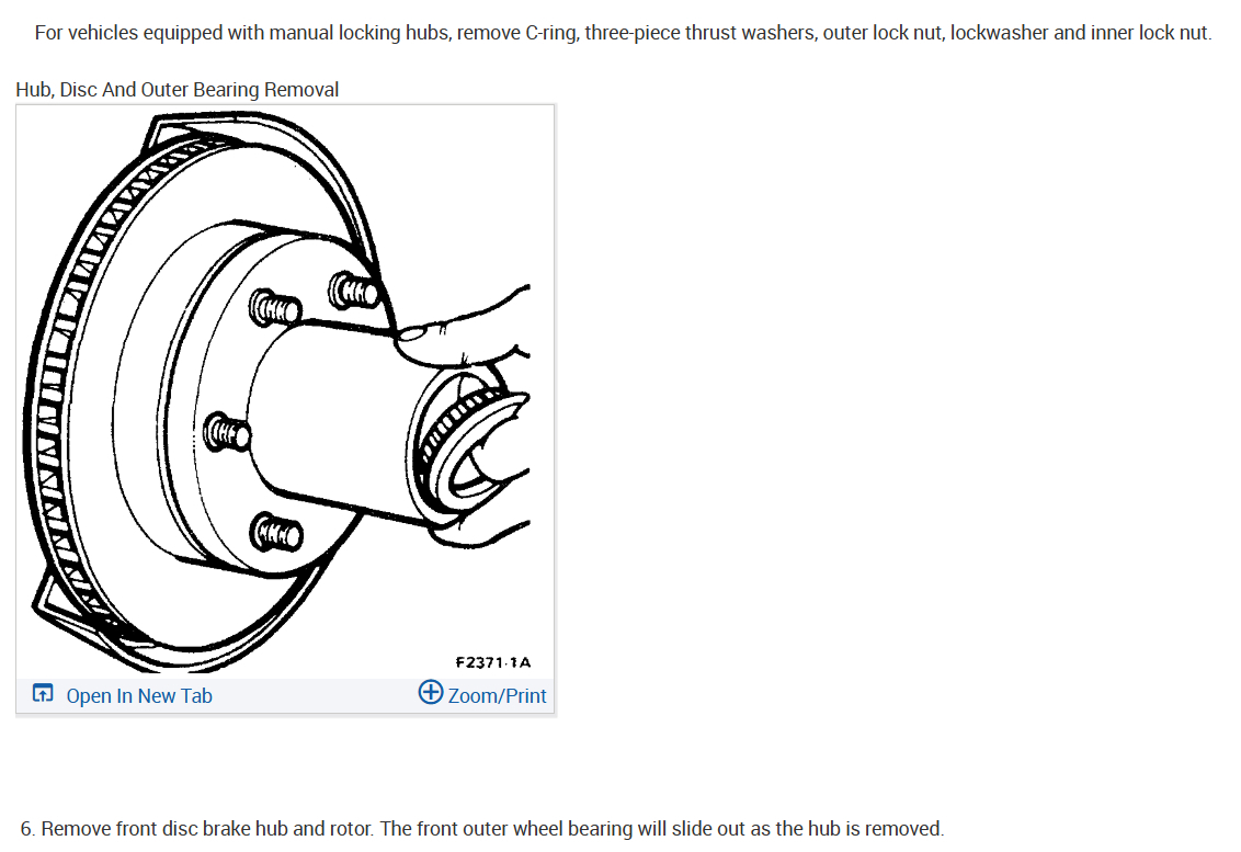

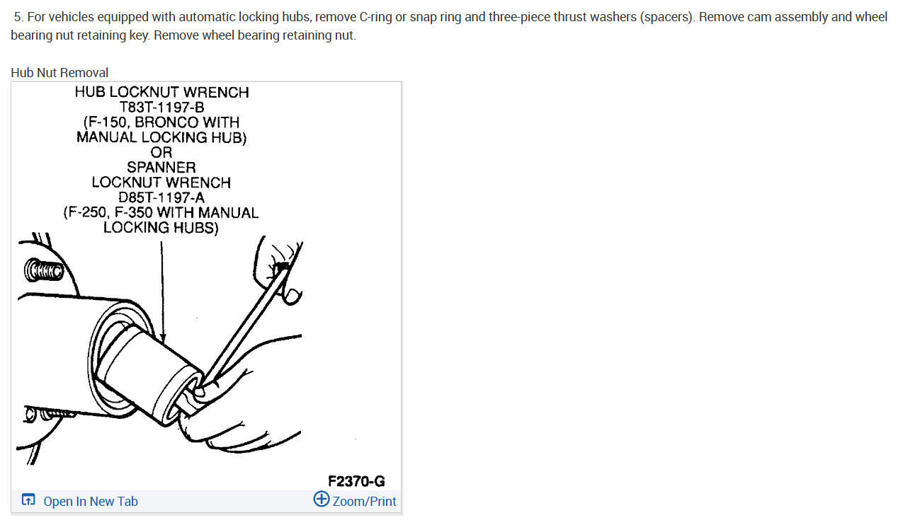

I need to replace the front brake rotor how do I get it off. It is a 4x4 with automatic hubs.
Thursday, December 4th, 2008 AT 10:25 AM
RACEFAN966
  • 5,029 POSTS
Ok first off you need to remove the outer hub, there should be three screws that hold the outer hub on. Then there is a snap ring in the hub that you will need a pic to make it easier to pull out. Then you can remove the inner section of the hub, Then there is a snap ring or c ring remove it, then remove the washers and the cam assembly then the retainer key and then the wheel bearing nut then the rotor will slide off with the bearing. Here is a pic with a brake down of everything.
https://www.2carpros.com/forum/automotive_pictures/249564_front_hub_1.jpg
Check out the images (below). Let us know if you need anything else.
