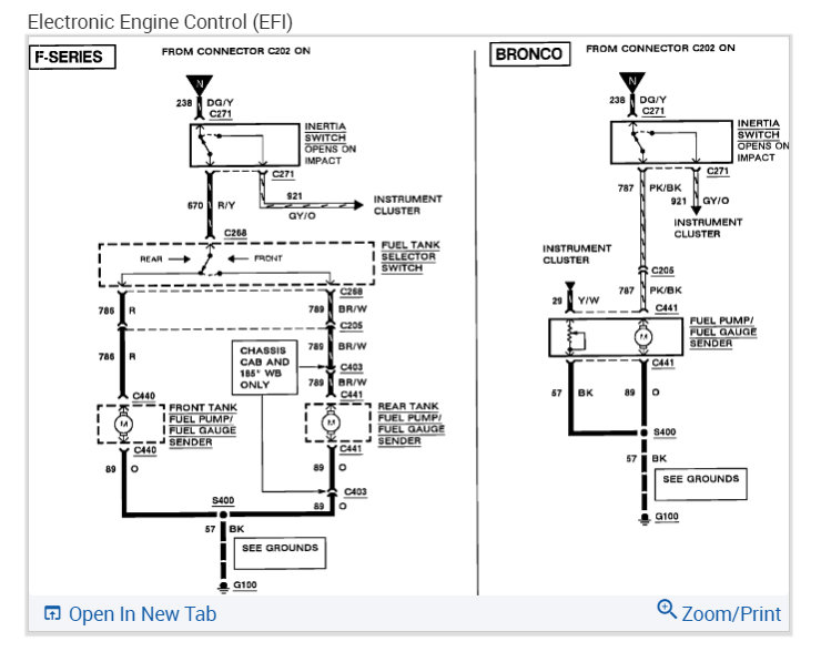

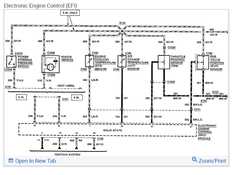

Getting power on ground wire but no power to fuel pump. There is power on main yellow wire power on red ignition switch and power on ground wire on back of fuse box, fuel pump shorted inside fuel tank on red wire, so we are trying to replace with new fuel pump no power to pump (4.9L)
Sunday, December 16th, 2007 AT 12:53 PM
7 Replies
  • 75,992 POSTS

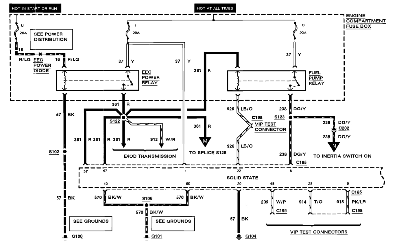

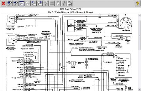

Have you check the fuel pump relay and inertia switch? Here is the engine and fuel pump wiring diagrams with a guide to help you do some testing.
-1
Monday, February 15th, 2021 AT 9:54 AM
KHENRI
Both switches have been checked and they are okay.
+2
  • 75,992 POSTS
Do you have power at inertia switch dark green/yellow? When key is in On position
+1
KHENRI
Have power on ground wire from fuel pump relay to 60 pin plug, ground to fuel pump has no power from
cab to fuel pump, power from switch to relay is good
+2
  • 75,992 POSTS
Do you have a dark green and yellow wire at the fuel pump connector? When the ECU energizes the fuel pump relay all you got is 2 secs to check for power at the pump connector. When the truck fires up the inertia switch powers the pump.
Check for power at pin No.8 at ECU.
