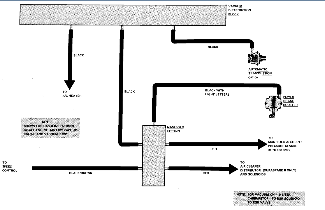

'85 ford f-150. The heater works great but it will not blow through the defrost vents. It just keeps blowing through the dash vents. Is there a door that's not closing or some vacuum problem?

I would check under the hood for broken vacuum lines headed inside the cab. THis guide can help plus I have found the HVAC vacuum line diagram so you can make sure all points are getting vacuum.
https://www.2carpros.com/articles/air-vents-stay-in-the-defrost-position
Check out the images (Below). Please let us know what you find. We are interested to see what it is.
