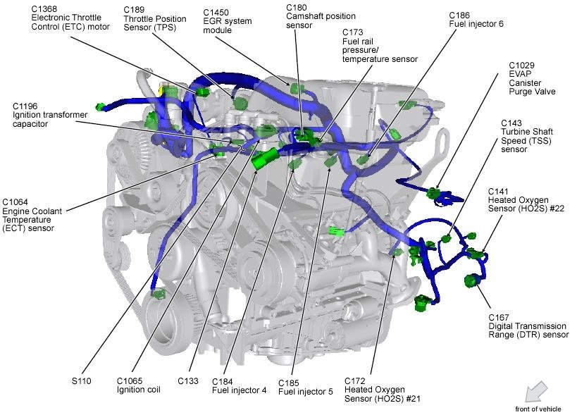

can you show me in picture which vacuum hose you mean?
can you show me in picture where is the MAP sensor in my vehicle?

it is not EGR, it is the EGR module and you need someone to do what cardiodoc says.
Jan 24, 2017 at 8:33 AM
ALDERBI
what is the EGR module? can you explain to me with pictures? thank you

Third from left on top.
Upon further searching, it appears this engine does not use a MAP sensor. That would explain why there is so much confusion concerning this fault code.
