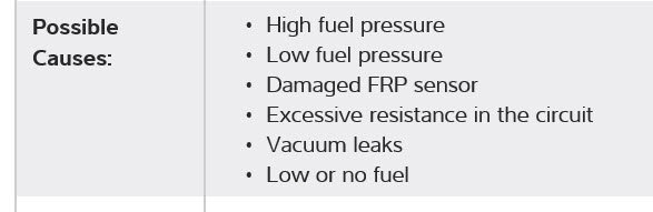

check fuel pressure with a gauge auto parts rent it, see link.
for code 191 is fuel pressure sensor. see picture for causes. make sure you have quarter tank of fuel in-tank.
