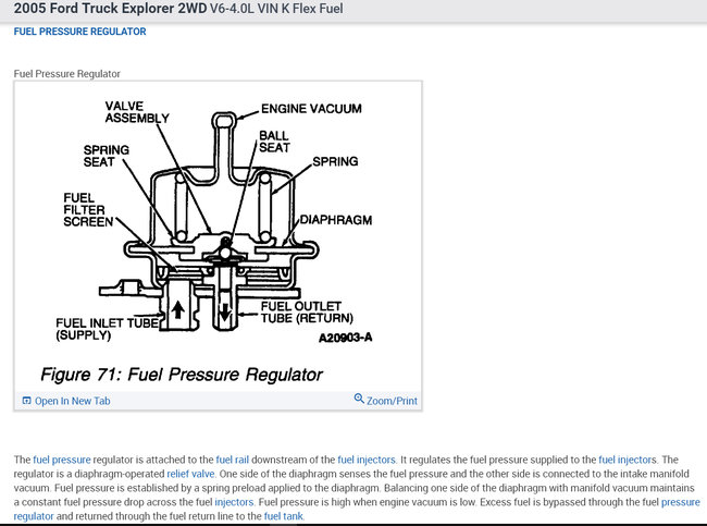

where is the fuel pressure regulator located and how to replace it? this is the code being thrown up for us. thank you.
Jul 10, 2010 at 3:14 PM
  • 110,194 POSTS

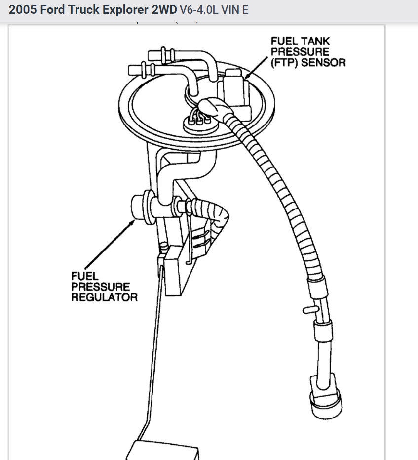

The fuel pressure regulator is located in the tank on the fuel pump. Here is a diagram (below) of what it looks like and a guide to help you test it.
Jul 10, 2010 at 6:56 PM
DOGHANDLER01
The diagnostic computer reads fuel too lean. The fuel pressure is 70. It should between 28 and 40. Where can I find a diagram that shows me where the fuel pressure regulator is, or can you tell me?
Jan 2, 2019 at 7:06 PM (Merged)
  • 75,992 POSTS
The fuel pressure should be between 60 and 65 so you are okay. The regulator is will the pump as one unit they do not have separated pressure regulators anymore. It is calling a lean codes and low power because you need a new MAF sensor which is a regular maintenance item.

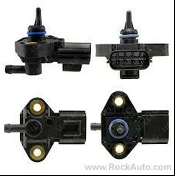

Trouble code read "high fuel pressure", "running rich bank 1 and 2", don't remember the code. Took the vehicle to mechanic who diagnosed fuel system condition, checked fuel pump pressure (5 psi too low), checked rail pressure (10 psi too high), took vacuum line off the "fuel pressure regulator" at front of rail, pressure is meant to drop by about 10 psi, did not change without vacuum, which lead to diagnosis of faulty fuel pressure regulator. He also recommended replacing fuel pump and fuel filter. Total cost of $900 with labor. No tune-up ever, all original engine equipment including fuel and ignition systems components. I did replace the MAF sensor recently when vehicle began rough-idling and stalling.
My question is what is the component called that bolts on (two torx bolts) to front of the fuel rail, and has a small-diameter vacuum line coming of the top of it? I can't find it in any of the online parts stores, but do remember the mechanic telling me that it is a motorcraft part only. Thanks for your help.
JDL
  • 16,098 POSTS
If it looks like the picture, it is a fuel pressure sensor. The picture came from rockauto.com
RLOTHIAN
Thanks, I found it, it is the Fuel Injection Pressure Damper, Ford PN 9F775. Rock Auto has it for $166, Ford for $380.
