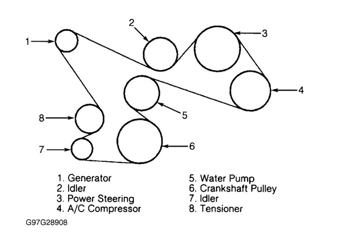

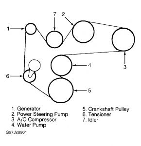

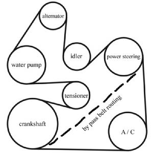

Depending on the configuration of the Alternator, A/C, Power Steering, Water Pump, Idler and "Tensioner type" you have, one of the two diagrams below shows the belts routing. The "Tensioner" is spring loaded and needs to be pulled back to allow the belt to travel over it. Then slowly release the tensioner onto the belt. The tensioner constantly applies pressure on the belt keeping it tight.
DOUBLE CHECK THE BELT ROUTING (#1) OR (#2) BEFORE STARTING THE ENGINE!!
#1
https://www.2carpros.com/forum/automotive_pictures/433905_Belt_diagram_40L_1.jpg
To use the "bypass belt routing" you will need a smaller drive belt.
#2
https://www.2carpros.com/forum/automotive_pictures/433905_Belt_Diagram_40L_2_1.jpg
Good Luck;
Rick

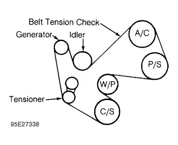

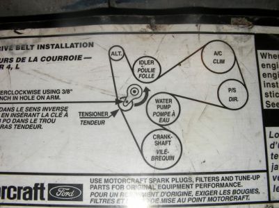

BMRFIXIT
  • 19,053 POSTS
Did you recheck the belt route ?
https://www.2carpros.com/forum/automotive_pictures/99387_Graphic_29.jpg
https://www.2carpros.com/forum/automotive_pictures/99387_Graphic1_12.jpg
+1
Friday, March 27th, 2020 AT 12:10 PM (Merged)
TGRIFFITH
Thanks so much for posting the diagram!
The bearings went bad in my idler pulley, which resulted in it falling off, and the belt coming off.
Bought the new idler pulley for $15, and put the belt back on according to your diagram, and everythings back in order.
Thanks again!
