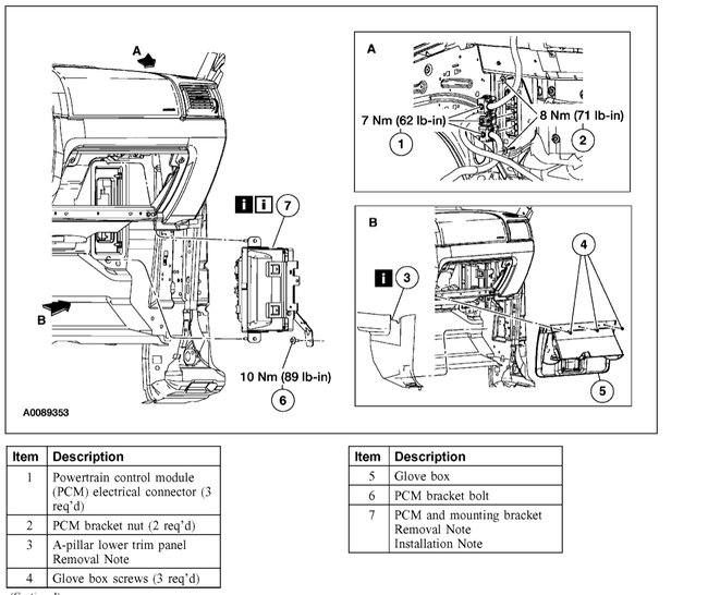

I'm trying to locate the computer module to get the keyless entry code. So far I haven't found it. Please suggest where it might be.
Thanks, Harrell Gantt
Dec 5, 2008 at 10:37 AM
  • 55,433 POSTS
The location of the engine control module is located in the passenger's compartment behind the glove box on the right side. Here is some diagrams to show you what I am talking about. (below)

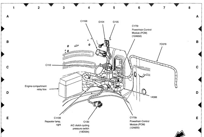

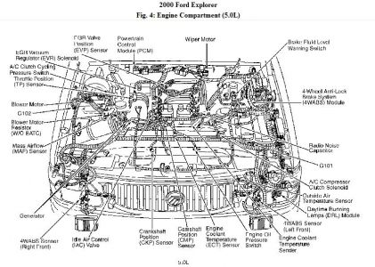

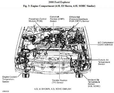

Where is the computer module located in a 2000 for explorer
Nov 11, 2017 at 10:52 AM (Merged)
BLUELIGHTNIN6
  • 16,542 POSTS
Powertrain Control Module (PCM) is located through firewall, pictured.. 4.0L Engines
https://images.2carpros.com/forum/automotive_pictures/261618_Noname_245.jpg
5.0L Engines
https://images.2carpros.com/forum/automotive_pictures/261618_Noname2_73.jpg
