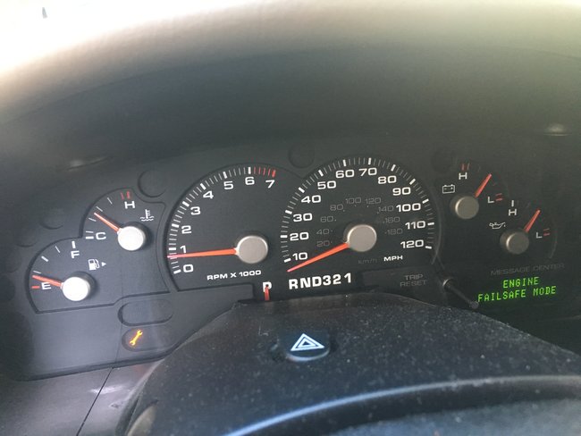

05EXPLODER94
Last Thursday I was driving home from work in a 35 mph speed limit zone, and I had to come to a stop because a truck thought he wasn’t going to make it under a railroad bridge. About thirty seconds later, he starts driving and I look down at my dash, and the “Engine Fail safe Mode” message displayed, and the car stalled. I was able to start it up and drive it home without further problems. Took it up the highway later that day, and no issues. Took it to a mechanic over the weekend and they couldn’t figure it out because it didn’t throw any codes. Drove it home from the mechanic with no issues, and to work this morning with no issues. Driving home today, down that same 35 mph speed limit road, “engine Fail safe Mode” displayed again, and the orange wrench light lit up like it did last week, but this time it didn’t stall, not even after coming to a complete stop in my driveway. Left the car running for a couple minutes and it still didn’t stall but the light was still on. I had a similar issue with it about five years ago where the message kept popping up very frequently and the truck would stall while slowing down to take a turn; it turned out to be the throttle sensor was bad, so we replaced it and all was fine until now. The only thing is the “check engine” light, or in my case, the “service engine soon” light didn’t come on, which explains why it didn’t throw a code. I can’t remember if that happened five years ago or not. Not sure what it is. Maybe I need a new sensor, maybe a new throttle body, not sure. The mechanic did say they cleaned a couple of the spark plugs, and said it could use a tuneup, but they said it wasn’t urgently needed. I don’t know if that’s causing this or what is. Hopefully I explained this well enough. Any help ASAP would be greatly appreciated, so I can either fix it myself or take it back to my mechanic to get it fixed. Thank you in advance for any assistance.
I included a picture of my dash with all the lights that came on. As you can see, no “check engine” or “service engine soon” light is on.
Jan 29, 2021 at 2:56 AM (Merged)
STEVE W.
  • 15,349 POSTS
Welcome back to 2CarPros. A common cause for this is the throttle position sensor on the throttle body. They start to act up but don't throw a code because the problem fixes itself so fast. First thing is to check the connector to it. They can get corroded inside and send odd readings. Next would be to watch the signal output on a scope and see if any drop out appear. Or just replace it and save the diagnostic work. A set of plugs wouldn't be a bad thing if they haven't been done in a while.

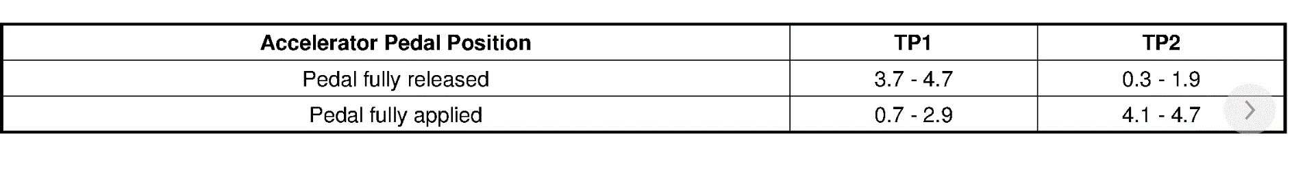

MIKEBKFD
Yes, it is a drive-by-wire system. I have no accelerator pedal whatsoever when I turn the car to the arm position or started the throttle body you can hear it click three times but then nothing. I changed the actuator motor and I've changed the throttle positioning sensor. it has done this to me three times. the first time for three days the second time for a couple hours and then this time for 3 days now.
  • 110,244 POSTS
Do you have diagnostic trouble codes? Also, have you checked the voltages at the accelerator pedal position sensor?
Let me know. I have the diagnostics for the APP if you need them. Also, if they exist, let me know what codes you have.
MIKEBKFD
Yes, the codes are p0122, p0223, p022, p2104, p2112, 6 p2110 and p2111. I know I do not have the voltage measurements for the accelerator pedal.
  • 110,244 POSTS
Wow, that's more than I thought. I went through each one. Rather than giving you a thousand page flow chart, here is where I suggest starting. It seems the codes center around the APP sensor and the TP voltages. So,that is where I would start. I attached the voltages at the APP sensor. Check that and let me know what you find.
If you want the flow chart, let me know.

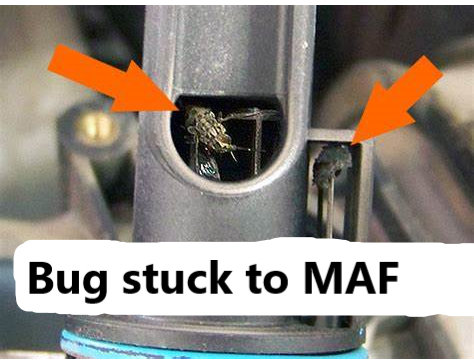

KATHLEEN MARIE P
Okay so the initial codes were PO301 and PO306 we identified them as a misfire on cylinder 6 we changed all of the spark plugs and then the serpentine belt and pulleys due to a squeal that recently started but seemed unrelated. Now the squeal is still continuing and coming from underneath we think. But the SUV is stuck in limp mode and the last time I drove it a couple days ago it wouldn't go over 2,000 RPM's or 20 to 30 km an hour. We are totally stumped and could use some help. Thank you.
Jan 29, 2021 at 2:57 AM (Merged)
BMDOUBLE
  • 1,139 POSTS
Would it be possible for you to upload a short clip of the noise? This would help tremendously! And have any new codes come up since the p0301,p0306? 2002 Explorer v8 doesn't have an electronic throttle body so I can't blame that. The PCM should have set a p1270 if it entered failure effects management mode. Were any coils replaced while the plugs were done? Also have a good look at the mass airflow sensor for any bugs or contaminants.
KATHLEEN MARIE P
Codes p1131 and p1161 also popped up, but were cleared when spark plugs were changed. It's at my dad's house so I can't get a sound clip right now. I can in the morning.
BMDOUBLE
  • 1,139 POSTS
Okay, those are lean codes and do not let a parts store sell you oxygen sensors for this! Lean codes plus lack of power = fuel pump or fuel system restriction or even a mass airflow sensor contamination problem. I would undo the air filter housing and inspect the mass airflow sensor, if it's contaminated you can give it a shot of brake clean or mass airflow sensor cleaner until the bug or whatever is stuck in it is gone.
