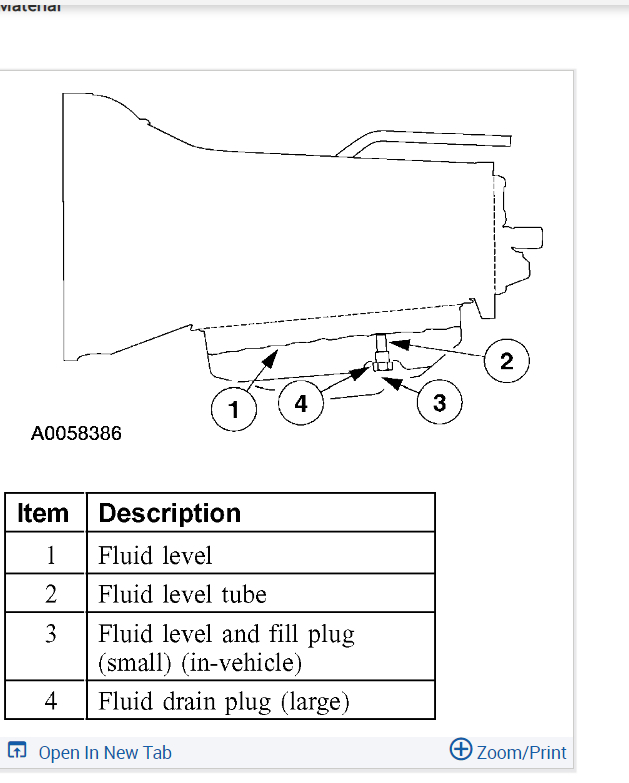

2003 Ford Explorer V6 Front Wheel Drive Automatic 36000 miles
Drove truck to mall. Got in started put in revers to back out truck went forward. Shut engine off. Restarted, truck would not go forward or reverse. truck starts in park neutral and all drive gears but does not move. Truck is eddie bauer explorer with auto select 4wd on dashboard. truck had a transmission service at ford dealer three weeks ago.

sounds like its low on fluid
Dec 9, 2007 at 12:21 AM
  • 55,224 POSTS

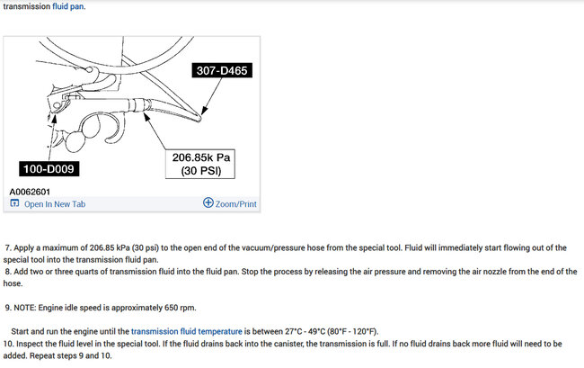

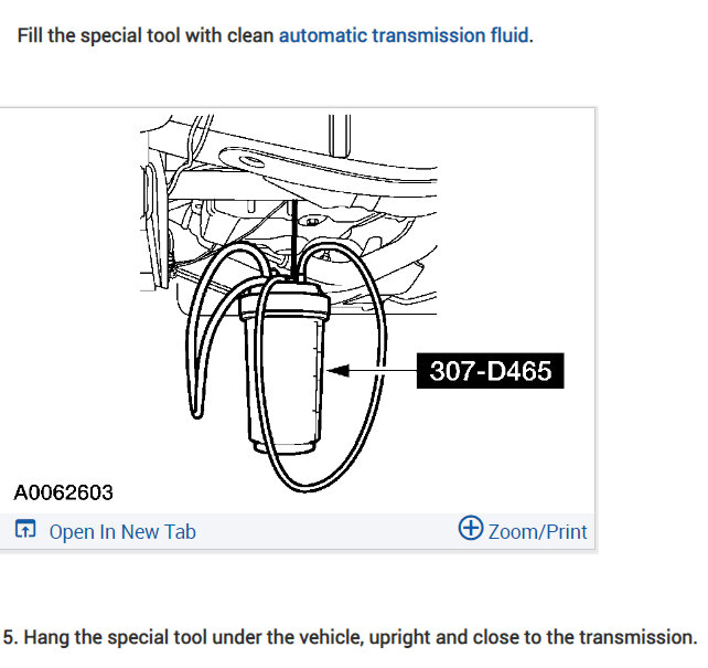

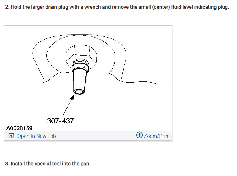

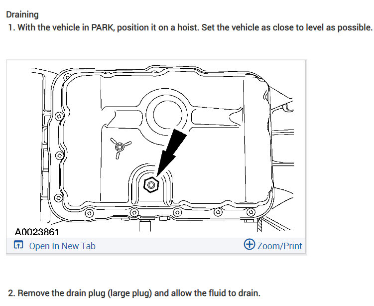

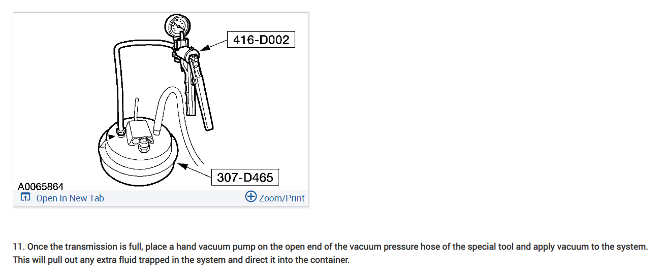

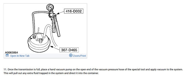

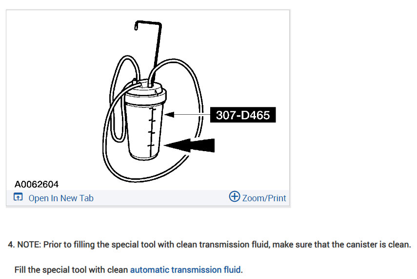

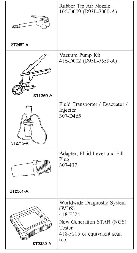

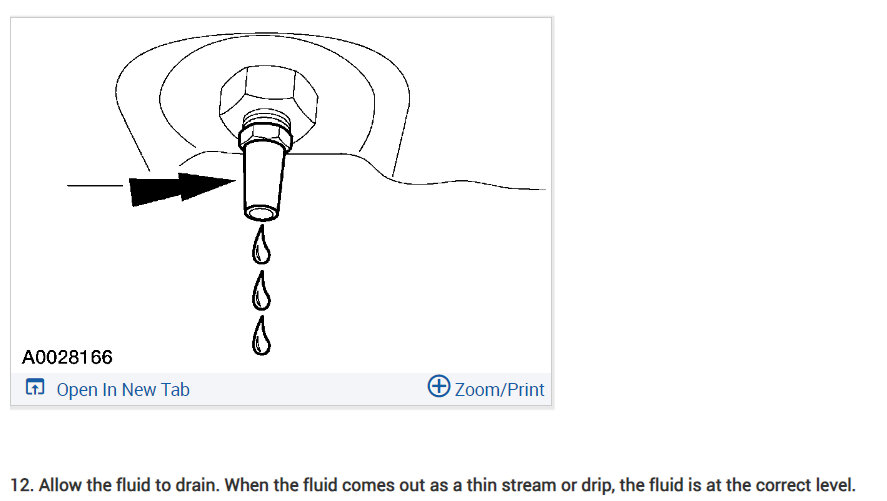

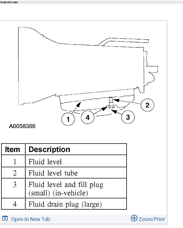

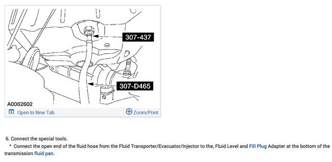

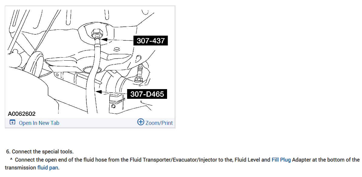

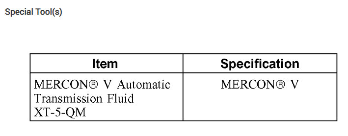

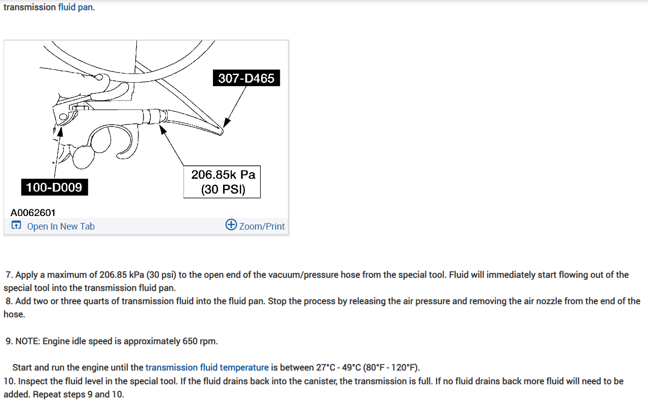

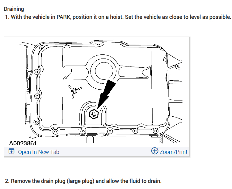

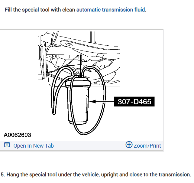

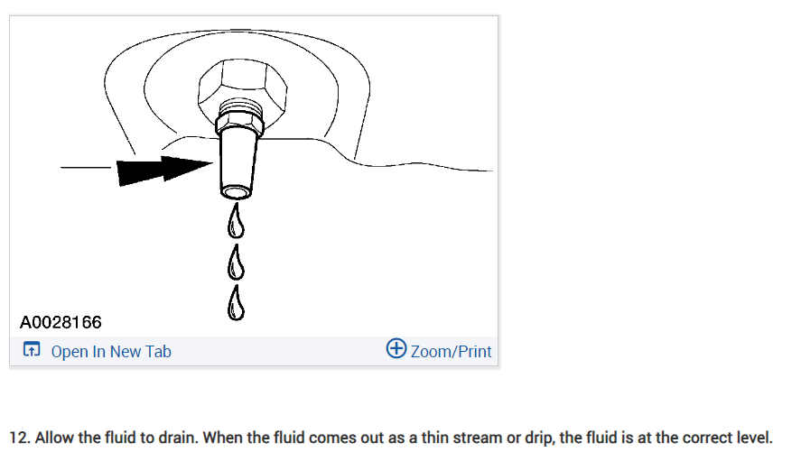

Yep, I would start by checking the fluid here is a guide to help. I have included how to check the fluid on your car below which will take special equipment.
https://www.2carpros.com/articles/how-to-check-and-add-transmission-fluid
