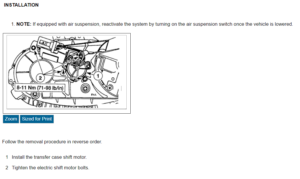

This sounds like the encoder needs to be replaced here is the instructions in the diagrams below. Check out the diagrams (Below). Please let us know what you find. We are interested to see what it is.

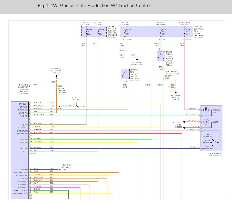

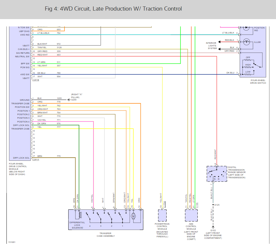

To me it sounds like, the switch is bad which is common with these cars but to confirm the failure let's check for the trigger signal from the switch to the system.
Here is a guide and a transfer case wiring diagrams to get the problem fixed:
Please run this test and get back to us.

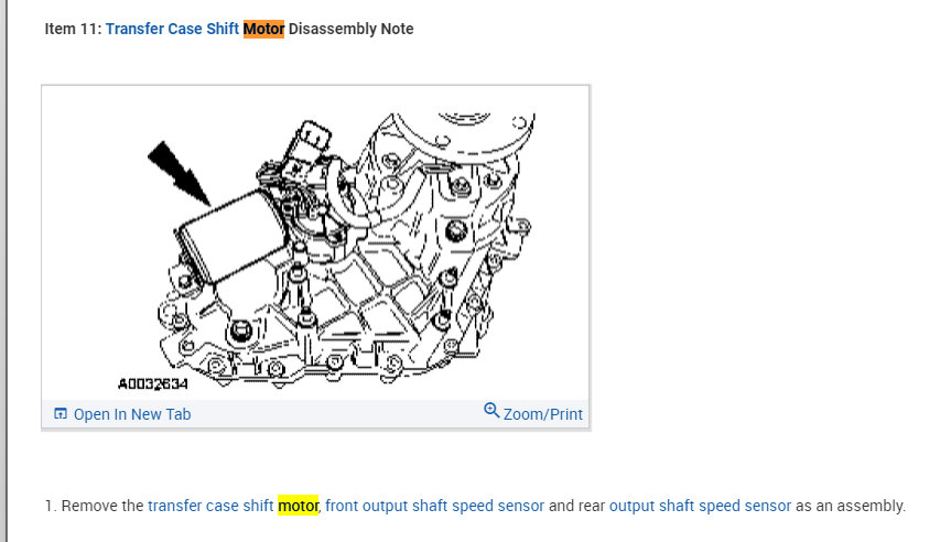

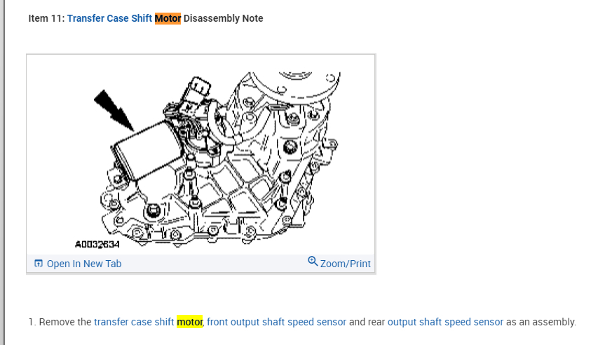

This is usually the 4x4 shift motor on the back of the tranfer case. It looks like this.

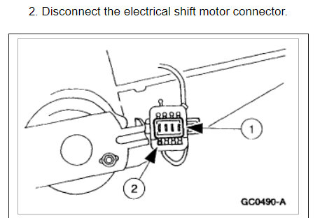

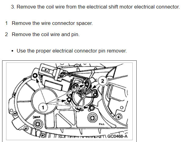

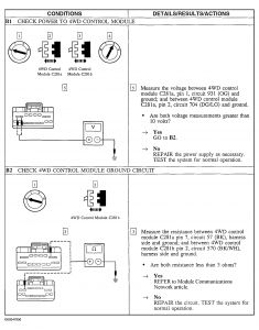

Here is how to test it to see if the switch and module is good. If you need more let me know. Now you will have to right click on the instructions and save pic and then print it ok.
https://images.2carpros.com/forum/automotive_pictures/249564_Graphic_8.jpg
Let me know if you need more ok. You will need a digital multi meter to do this ok. Thanks.

first thanks,
I can't get the picture to download in anyway so i can read it or print it readable. Have had the computer guy here at work try and he can't either. He asked if you could send the page to me directly.

Ok I have sent it to you from my yahoo let me know if you need more ok. Thanks

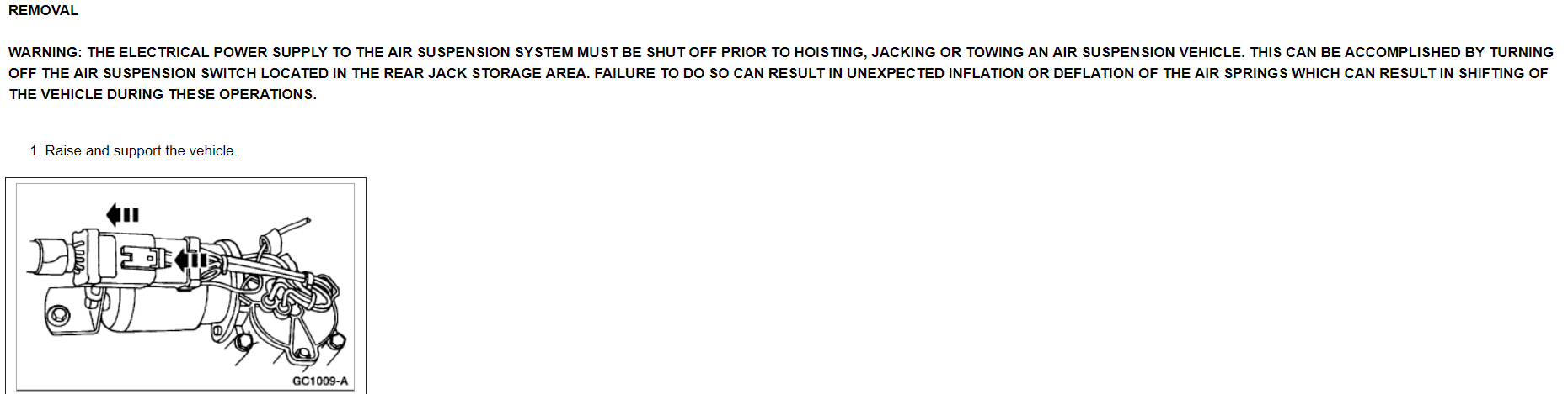

This is a common problem when the transfer case shift actuator jams up and needs to be replaced. Here is a diagram and instructions on how to replace the actuator. You might need to raise the car up.
