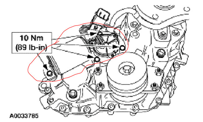

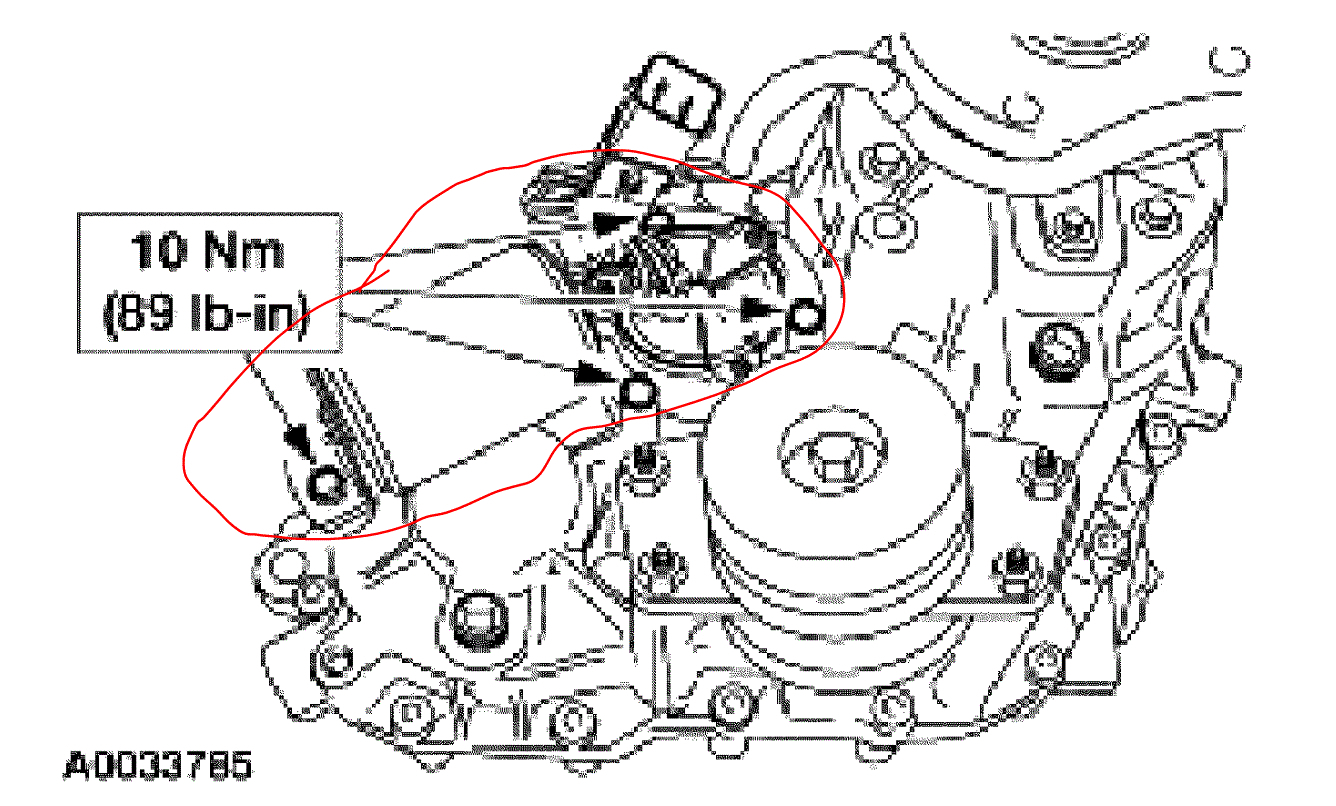

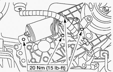

When you say control module, are you referring to the transfer case shift motor? See pic 1.
Also, I need to know if this vehicle has the automatic 4wd or if it is an AWD vehicle.

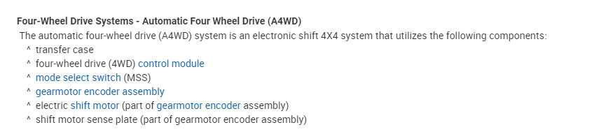

Can you confirm for me that you have the automatic 4 wheel drive system that is attached? The picture of the buttons is the second image. The Eddie Bauer should have this unit but I just want to make sure before we proceed because I suspect you have an issue with the encoder assembly, but we need to make sure we are dealing with how your vehicle is equipped.
Thanks

Yes, it has automatic four-wheel drive, four-wheel drive high, four-wheel drive low and the buttons are as in photo, they light up but when pushing the buttons the dashboard indicator light that says hi 4x4 or low 4x4 does not appear when pushing the button, I changed out the transfer case control module brand new but still nothing. the way it feels as I drive it's in four-wheel drive. unknown if it's low or high but winter is coming on and we will be snowing soon. I need to try to figure this out. I appreciate any information you can help me with.

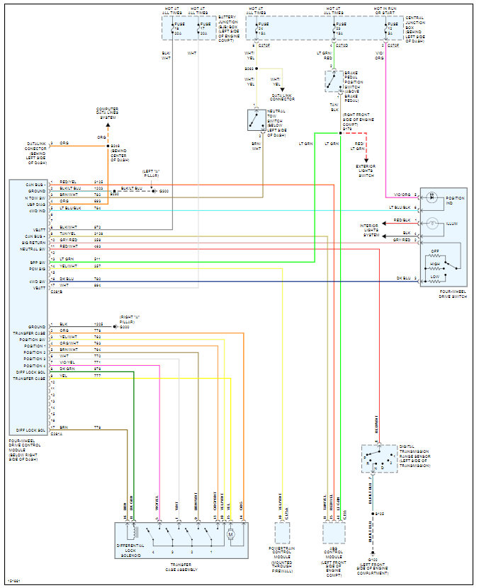

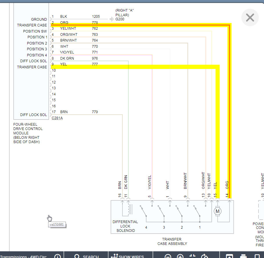

We need to go to the transfer case motor as shown in the wiring diagrams and press the 4 high switch and see if there is voltage to the motor. Then press Low. Then Auto. Is there voltage on the motor when pressing any of these buttons? If so, you need a motor as it is most likely failed if you cannot hear it moving.
Basically this motor just has power put to one side or the other depending on what button is pressed. The module you replaced is the power and ground for it as it just reverses the polarity when moving one way or the other.
Let us know this and we can go from there.

you may need friends help on this. one needs to be in the truck and one under driver side of truck at the back of the transfercase. there is a little motor which inguages the transfercase.you won't need to start truck turn key to run while friend turns the selector switch to all spots and lightly tap on the little motor NOT Hard. Ford says you should activate it at least twice a month weather you use it or not just to keep it freed up. let me know if this works and we go from there. 8) NOS

On the transfer case find the actuator motor, have someone press the buttons while you tap it with a hammer. If it works, the brushes, or contacts inside it are possibly corroded a bit, may work to free them up, if not check for power at this motor, if power is present, replace motor. GEARMOTOR ENCODER ASSEMBLY Removal and Installation 1. Press the 4X4 HIGH button on the mode select switch (MSS). Fig. 53: Locating 4X4 High Button On The Mode Select Switch Courtesy of FORD MOTOR CO. 2. Raise and support the vehicle. 3. Disconnect the gearmotor encoder assembly harness connector. Fig. 54: Disconnecting Gearmotor Encoder Assembly Harness Connector Courtesy of FORD MOTOR CO. 4. Remove the bracket bolt and gearmotor encoder assembly mounting bolts and remove the gearmotor encoder assembly. Fig. 55: Removing Bracket Bolt And Gearmotor Encoder Assembly Mounting Bolts Courtesy of FORD MOTOR CO. 5. Remove the grease from the motor adapter and check for any nicks or burrs. If any damage is found, repair or install a new gearmotor encoder assembly as necessary. For additional information, refer to TRANSFER CASE - AUTOMATIC SHIFT . 6. To install, reverse the removal procedure.  Apply a coat of Multi-Purpose Grease to the gearmotor encoder assembly.
https://images.2carpros.com/forum/automotive_pictures/62217_motor_1.jpg
