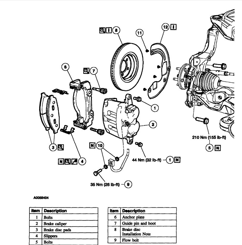

How do the front brake rotors come off this truck. Once i loosen the caliper, will the rotor slide off with the assistance of a hammer or are there nuts/bolts that hold it to the hub?

I think you have slip off rotors on that one. After you remove the caliper, it may come right off, or you might need to remove the caliper brackett.

This can happen when the brake rotor is rusted on, this guide can help you remove the brake rotor so you can complete the brake job.
https://www.2carpros.com/articles/how-to-remove-a-stuck-brake-rotor-a-comprehensive-guide
Check out the images (below). Let us know how it goes
