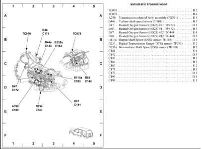

Where is the neutral saftey switch
Saturday, September 4th, 2010 AT 4:57 PM
MECHANIC
75,992 POSTS
Neutral Safety Switch-Location @ B234 - see below:
View 151-8 (Automatic Transmission)
