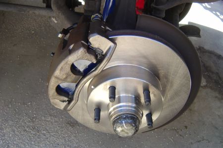

r&r all brakes calipers, rotors, pads, shocks, bearings, front wheel seals - vehicle is still on jacks - brake pedal has no pressure when engine is running, the rear brakes stop rotors - yet brake pedal still feels liike the brakes are not being applied. Does the vehicle have to be in motion for the brake module to work properly? Or is brake module have to serviced by technician?

Was this the problem before changing all those parts?
Look at the front calipers and tell me if the brake bleeders are on the top or the bottom.

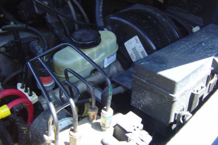

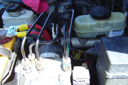

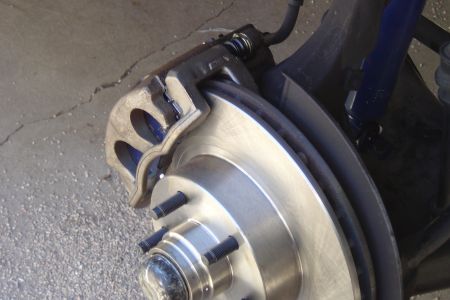

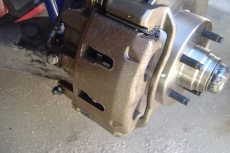

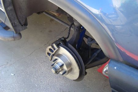

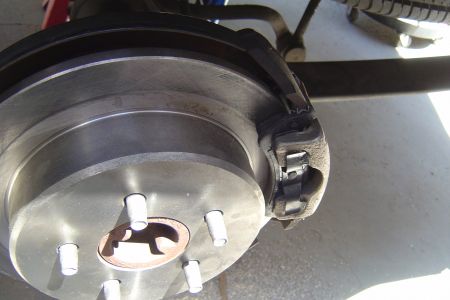

REGORZ
Original problem was the front brakes wore out and the rear didn't seem to be working, over the past year, i r&R front brakes three times.
when mounted the front caliper is double piston with bleeder valve on the side
https://www.2carpros.com/forum/automotive_pictures/566105_DSC00875_1.jpg
https://www.2carpros.com/forum/automotive_pictures/566105_DSC00873_1.jpg
https://www.2carpros.com/forum/automotive_pictures/566105_DSC00874_1.jpg
https://www.2carpros.com/forum/automotive_pictures/566105_DSC00876_1.jpg
https://www.2carpros.com/forum/automotive_pictures/566105_DSC00877_1.jpg
https://www.2carpros.com/forum/automotive_pictures/566105_DSC00880_1.jpg
https://www.2carpros.com/forum/automotive_pictures/566105_DSC00881_1.jpg
Friday, August 27th, 2010 AT 2:43 PM
WRENCHTECH
  • 20,761 POSTS
Well, you didn't answer my question but your pictures did.
You have installed the calipers on the wrong side of the car. You have the left on the right and visa versa. The bleeder needs to be at the highest point of it traps air in them than can't be removed. Switch sides with the calipers and bleed again and you'll get a pedal.
