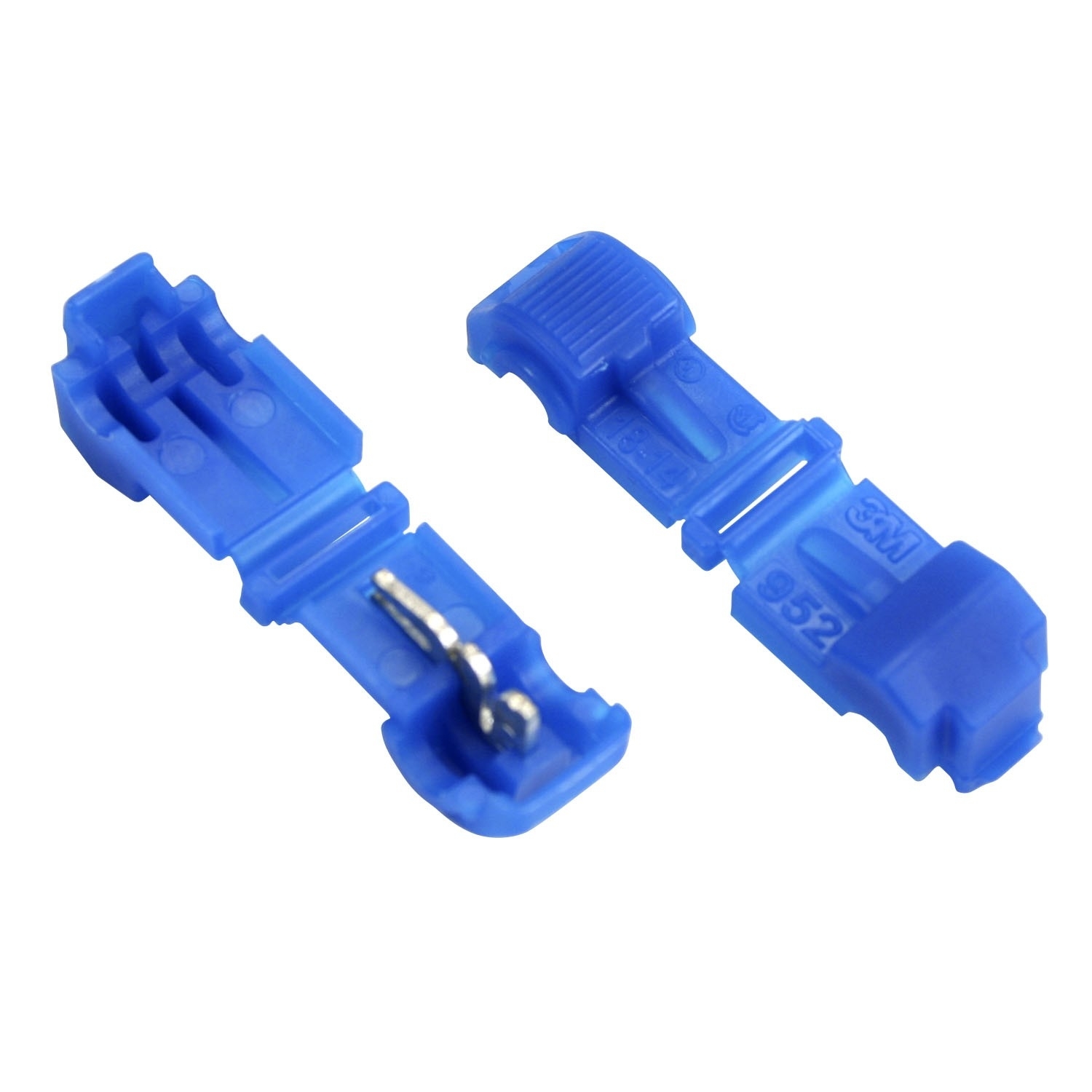

have a viper alarm/starter on my SUV. last week my locks stopped working all of them. I changed fuses under hood an under dash related to power locks. still not working so bought a power lock relay finally found the relay box in the dash under the oval panel pop out and on by one replaced each relay with the new one, but locks still do not work. can you help? then the following day my heater blower stopped working on lo/med settings and I cannot find where the blower resister is located at.
Apr 5, 2019 at 11:51 AM (Merged)
STEVE W.
  • 15,403 POSTS

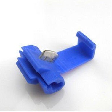

The power lock issue is likely bad wiring of the alarm, very common and one of the reasons shops hate any add-on's like them. One of the first things to check will be that wiring. Installers love to use scotch lock connectors to tap into wires and those cut the wires insulation so moisture gets in and corrodes the wires off. There are even ones who just bare the wires and twist them together with a wire nut. So find the alarm box and follow the wires. Look up the model number and you should be able to find a wiring diagram for it.
