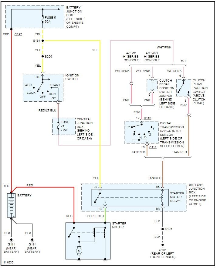

Drove it fine yesterday and a friend played with the locks in the car now it wont turn over. Its the original key and the battery is fine in it.
Oct 22, 2018 at 1:15 PM (Merged)
HMAC300
  • 48,601 POSTS
Have you locked and unlocked the door with the key? That usually will reset them...

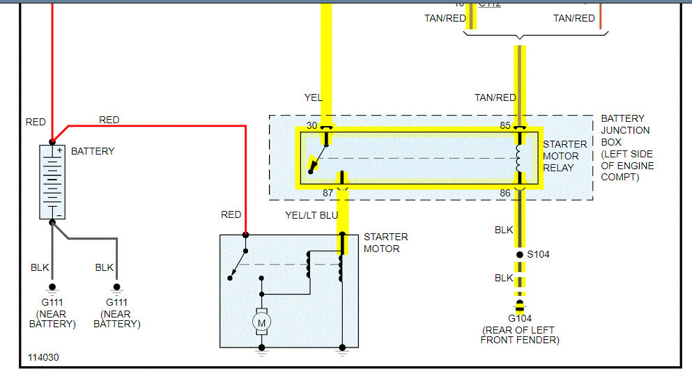

Have you checked for power at the starter solenoid? May be a coincidence that the starter is bad
See the guide below on using a test light, it is a good way to check for power at the small trigger wire on the solenoid
Attached below is the wiring diagram for your starting circuit

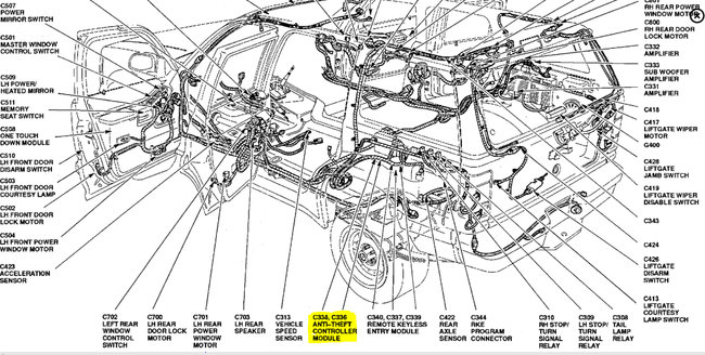

Which system do you have, PATS or active ???? Or both???(not sure if this is available). Does your key have the chip(pats)??? If you have the active, make sure all your door switches and such are not hanging up,, may have to have it diagnosed by knowledgeable person, this system can be checked with a scanner capable of reading pid's and so forth, also the ngs tester.. there's a couple of modules, rap and gem, that also play a part in this sytem,, check all the easy stuff first.. you may have to have someone look at it, without the correct diagnostic routines, may be hard to figure out.. hopefully it's something simple.. Does the keyless entry system still work??? You can try unhooking the battery + cable and re-installing it...

If they dont have a scanner capable of communicating with the anti-theft system, you might have to go to the dealer or another shop that can. The proper scanner can communicate with the controller to see if there is a problem with the RAP (remote anti-theft personality) or GEM (generic electronic module) or if the problem is with comm between the two

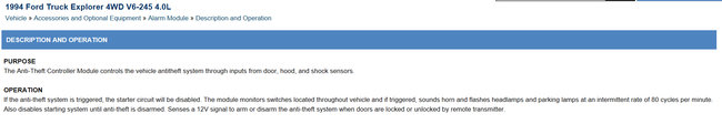

It's certainly not that simple. If you're talking about the factory engine disable, it HAS to be operational. If it's an aftermarket system, then it has to be removed and all the wires it interrupted have to be spliced back together.

Is this a factory alarm system? If so, there really isn't any way around it. Is the vehicle even starting for you?

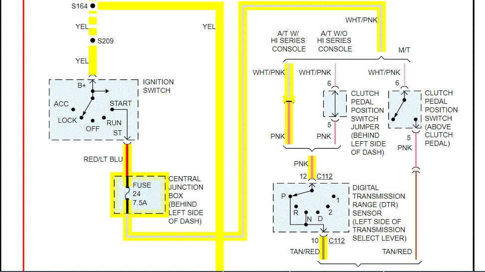

Okay.
I attached a diagram of the system for you to view. Do you have a test light or voltmeter to do some checks?
