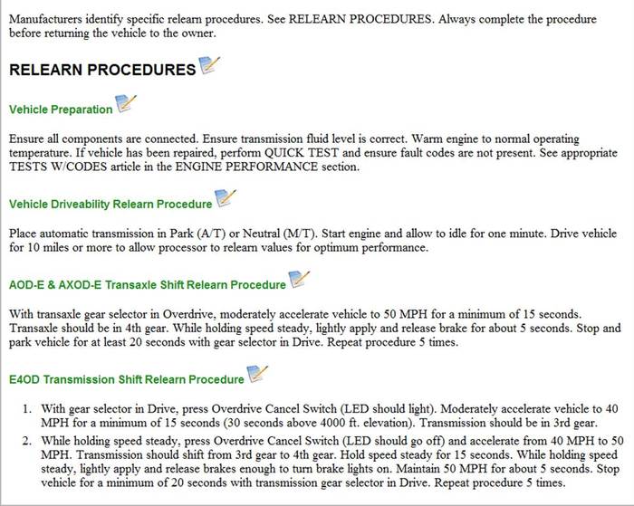

I replaced the battery on my 1997 Ford Explorer L.E. And after replacing it, the displays in the cabin did not reset (i.E; radio display, time, temp. Etc). It still displays alerts (i.E; "oil change required" and "system check") but goes back to blank again.

Hello klorster
Disconnecting or replacing a battery on a computer-equipped vehicle may cause starting, driveability and a number of other problems, including loss of air conditioning, power accessory functions (door windows, seats, sunroof), false warning lights, even damage to certain electronic modules.
Allays use a computer memory saver before disconnecting the battery.
A special relearn procedure or reprogram procedure should be performed with a factory scan tool.

Here is the information in the manual Hope it helps
