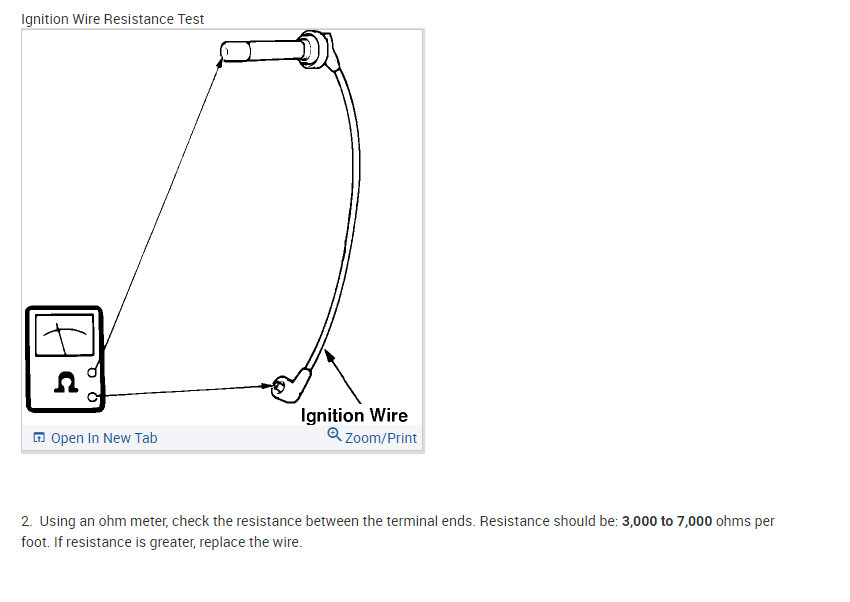

Popping noise that you hear could be from a spark plug wires. It could be shorting out to the block. Check the resistance of the plug wires. The resistance varies depending on the length of the wire. It should be between 3000-7000 ohms per foot.
