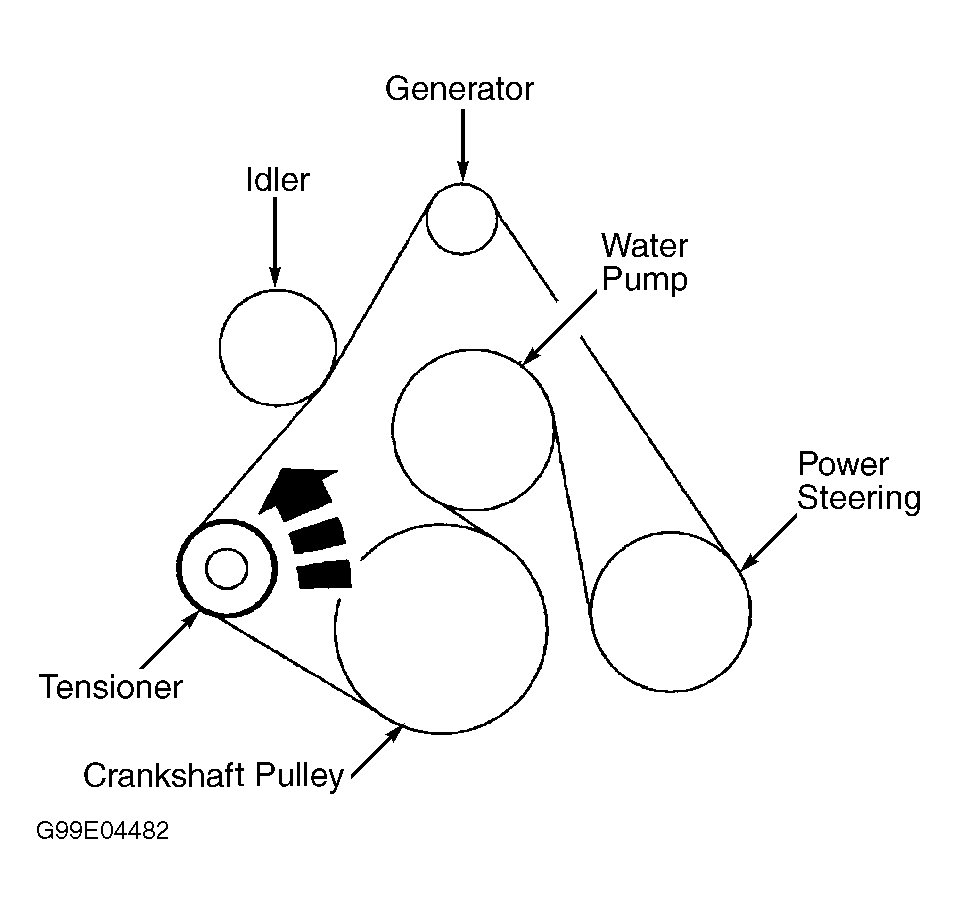

how do I put on a belt.I replaced my alternator in I cant get my belt back on
Wednesday, December 30th, 2020 AT 10:58 AM (Merged)
MATHIASO
  • 1,209 POSTS
Hello richking12,
# Rotate the drive belt tensioner clockwise and put the drive belt back.(see diagram for location of the tensioner.)
https://www.2carpros.com/forum/automotive_pictures/46384_0996b43f80209589_2.jpg

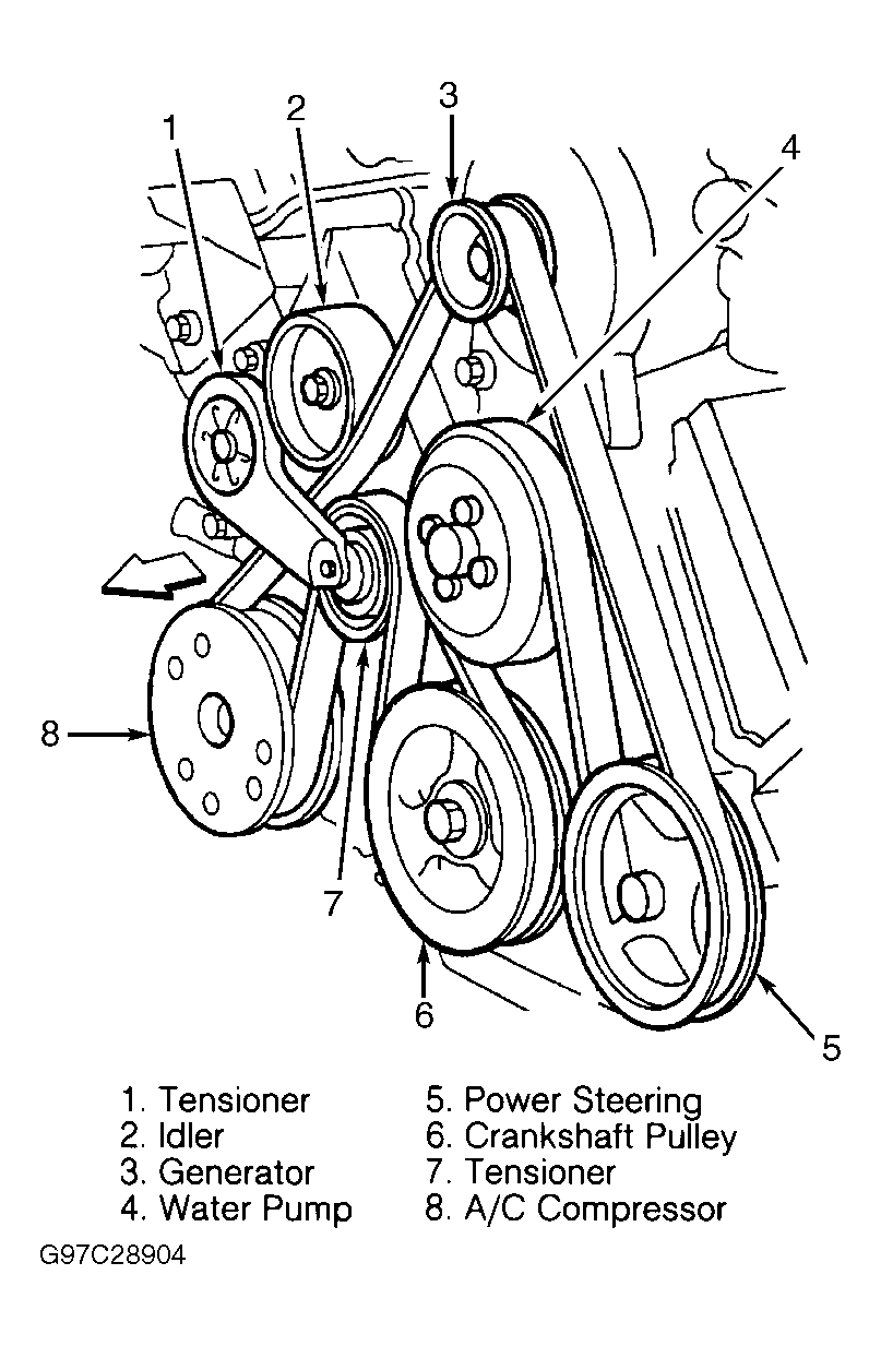

Diagram for serpentine belt?
DAVE H
  • 13,384 POSTS
This routing diagram is for 5.4L expedition Check out the diagrams (Below). Please let us know if you need anything else to get the problem fixed.
https://www.2carpros.com/forum/automotive_pictures/266999_exp_1.jpg
