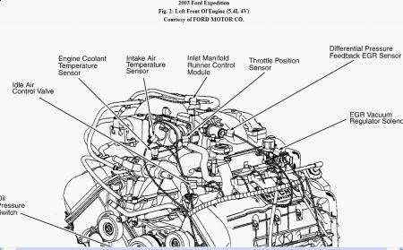

how to fix this is it expensive? will it be cheaper to have it done at ford dealer ?

Almost nothin g is cheaper at the dealer, most IAC's are under 100.00 at the parts store, it depends on which engine you have 5.4 2V or 4V here's the pictures. 2 small bolts and a gasket is all there is to it...
https://images.2carpros.com/forum/automotive_pictures/62217_iaca_1.jpg
https://images.2carpros.com/forum/automotive_pictures/62217_iacb_1.jpg
