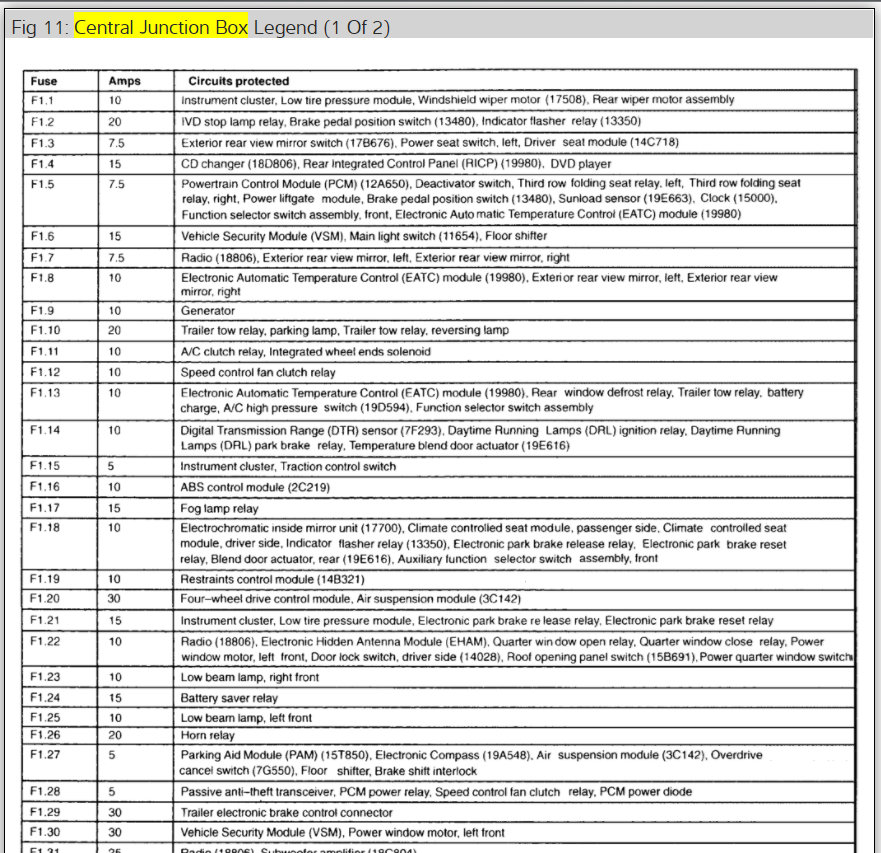

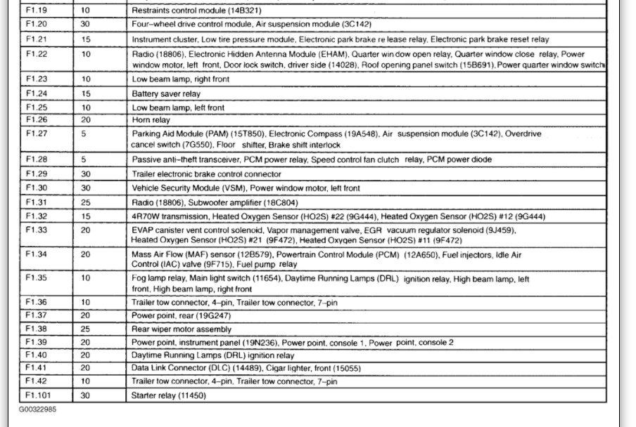

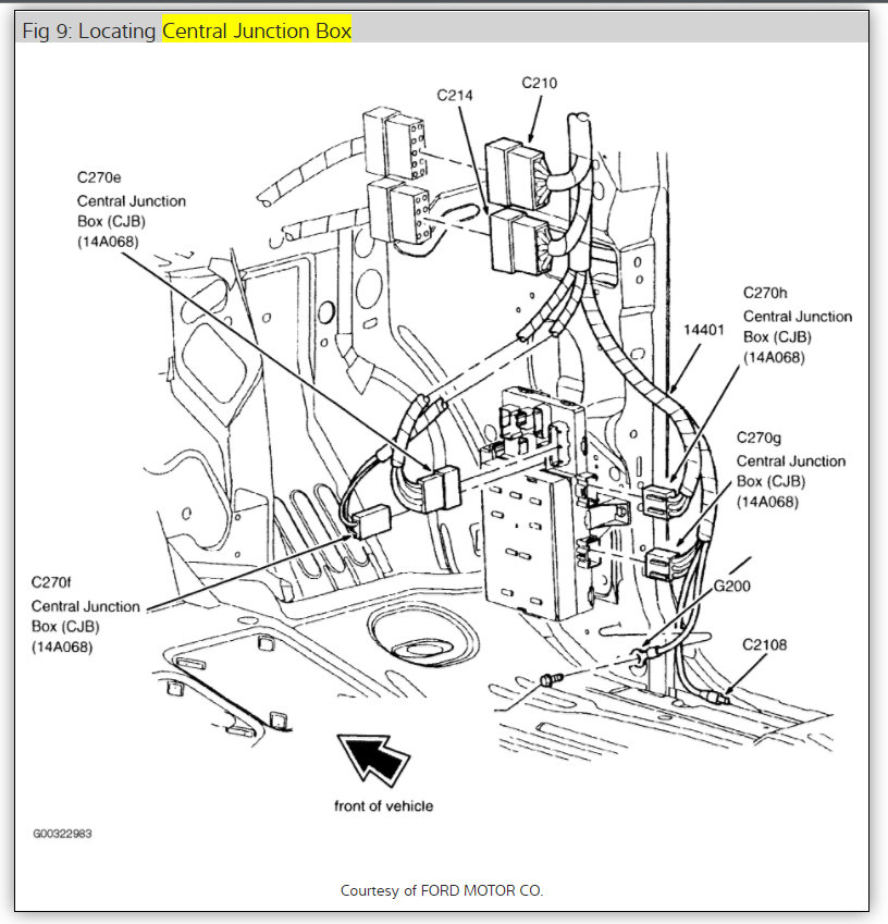

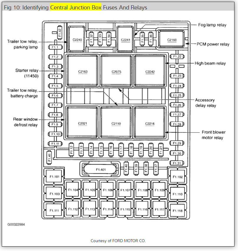

how do i find brake light fuse?
Mar 14, 2009 at 6:55 AM
MERLIN2021
  • 17,250 POSTS
Here is a guide to help you test for power at the fuse and the fuse panel diagrams below. The fuse is F1.2
