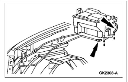

2000 Ford Expedition. Mileage: 97000 miles. V8. There is a leak in the windshield washer fluid system. The fluid leaks to the rear of the front passanger wheel well. I lost a full washer tank full of fluid when I found the leak. A mechanic friend told me the leak is probably inside the area below the wipers. He siad something like the sun must have gotten to some plastic piece. I haven't had a chance to look. What piece is he talking about? Is it easy to change? Is it cheap? Thanks.
P.S. If the tank had a leak the fluid would have leaked in front of the front wheel well, right? The fluid ran down the back of the front wheel well so this means that it has to be something else besides the tank, right?

remove the washer bottle from the vehicle and check for cracks or damage. if none are found, with the washer pump intact, plug off the pump, fill the bottle with water and look for any leaks. replace if necessary.

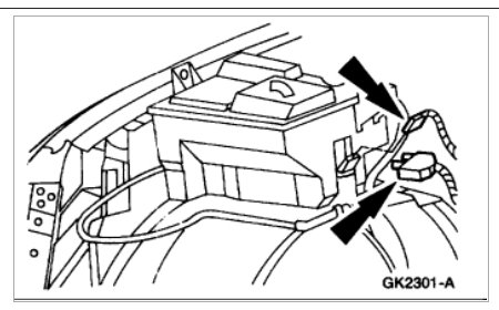

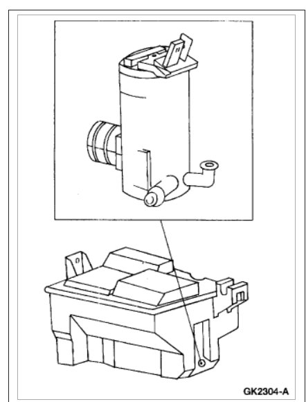

It sounds like you don't have the motor plugged in all the way or something got clogged in the line.
Here is a guide that will help you see what's going on
https://www.2carpros.com/articles/how-to-replace-a-windshield-washer-pump

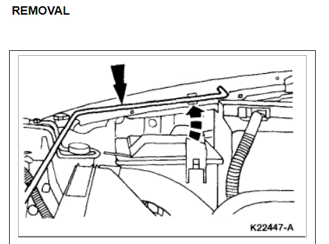

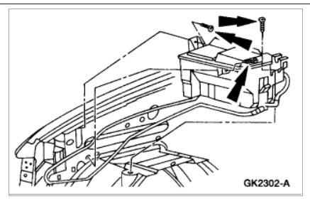

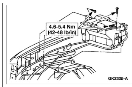

Here is how it is on your car (below)
Dec 20, 2017 at 6:42 AM
Suggested Repair
Remove the washer reservoir and inspect it for cracks or damage. If the bottle is intact, confirm the washer pump is fully connected and check the washer lines for clogs or damage, especially the rear line. Replace the reservoir or pump if it is damaged.
