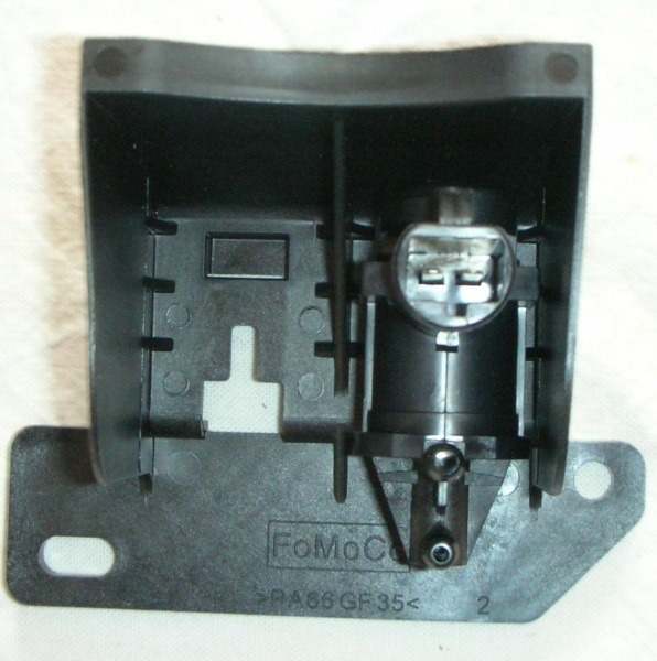

check your vacuum solenoid on the firewall behind battery pass side. if it is not not the newer model that is water sheilded you should replace it they are only 25 at dealer.(most) if it is not working you will not engage drive.

The lights on the switch on the dash are showing 4AWD 4X4 and 4L.
When I move the switch I do hear a loud Clunk, however the axles are not engaging. I replaced both solenoids on the firewall.
A friend looked at it for me and I hope to repeat what he told me. . .He took the cover off the differential, manually pushed the fork and it engaged easily. He then checked the solenoids on the firewall and one of them (passenger side) wasn't working. (He used a vacuum hose to jump between the two and he said it worked) So I replaced that solenoid but it is STILL not engaging.
I do have vacuum at both of the solenoids
ANY HELP OR SUGGESTIONS will be greatly appreciated.
Feb 12, 2019 at 10:40 AM (Merged)
  • 110,240 POSTS
Have you replaced the vacuum hoses? If there is a leak, you may have vacuum but not enough.
