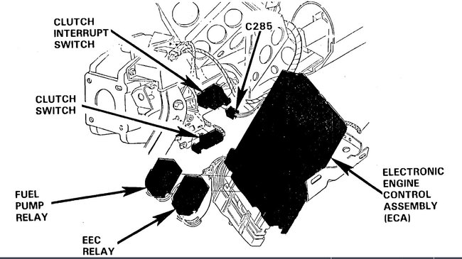

1987 Ford Escort Fuel Pump Relay
CARTOONZ71

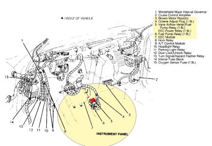

Where is the fuel pump relay located?
Nov 24, 2006 at 10:02 AM
  • 55,808 POSTS
Under left side of dash above brake pedal.
Check out the guide below on testing relays, it will help
See the diagram below for relay location

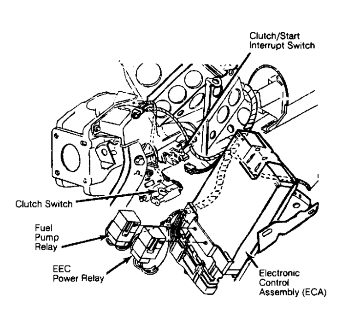

Where is the fuel pump relay located on a 1989 ford escort 1.9 l 4 cyclinder engine ?
Jan 17, 2019 at 10:58 AM (Merged)
  • 75,988 POSTS
FP relay-Under left of dash, attached to ECA mounting bracket.
  • 75,988 POSTS
See below

four cylinder front wheel drive automatic 172,000 miles.
I have the LX model (1.9 liter). I am looking for someone who could tell me where my fuel pump relay is located. It is not behind the dash, nor at either of the fuse boxes. my car is too old to have the relay fuse box. so all of the relays are kind of scattered. Or possibly something else is wrong? we replaced the fuel pump, the inertia is good we think and there is still no pressure into the fuel filter. any help would be appreciated greatly.
BMRFIXIT
  • 19,053 POSTS
It is under dash beside EEC.
