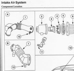

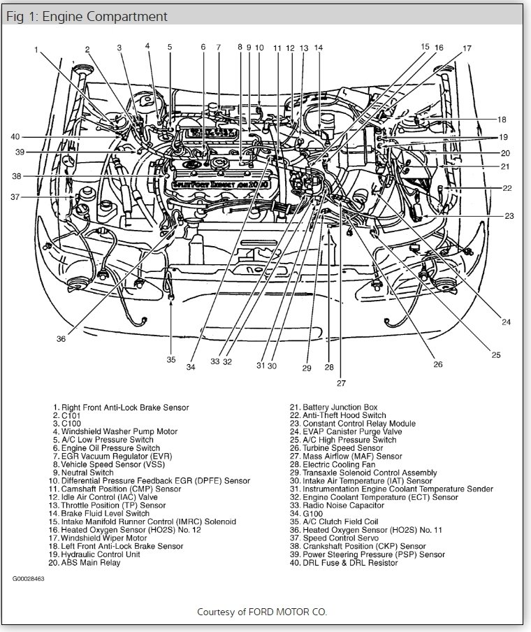

I need to know where I can locate the intake air temperature sensor on my car. It's a ZX2 and utilizes the cone type filter set up, not the box. The parts house has given me an air charge temperature sensor that is shown installed on a box that is not on my vehicle. Thank you in advance.
Nov 25, 2008 at 9:56 PM
  • 54,837 POSTS
Hey Jwall, Locate your Mass Air Flow Sensor. Along the air intake hose, towards the throttle body, you will see the IAT sensor. Connector has two wires. Here is a diagram of the location of the air intake temperature sensor. Click to enlarge. Please let us know happens so it will help others. Best, Ken Here is another picture. The number 12 is the Intake Air temperature sensor (IAT) sensor.
