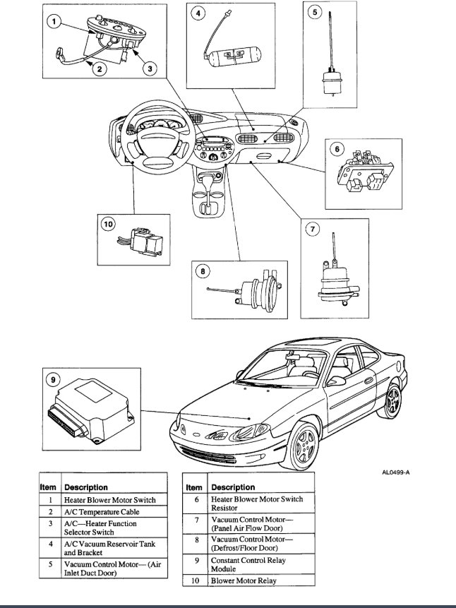

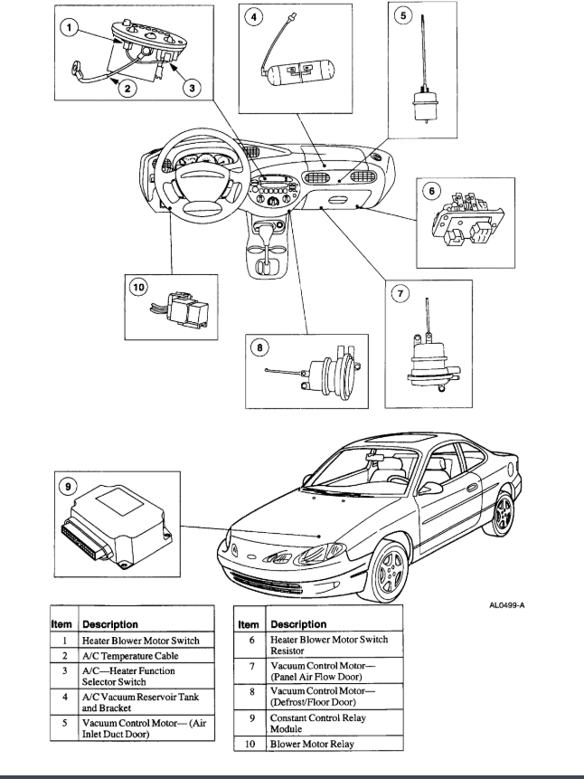

We replced the Blower motor last year and now it won't work again. Before I spend money on another blower motor I want to check the Blower relay. The manual says there is a 30 Amp. Circiut Breaker, however the manual doesn't tell me where the C/B is located. Can you help??????
Feb 14, 2009 at 3:26 AM
BMRFIXIT
  • 19,053 POSTS
The blower relay is with the resistor here is the location in the diagrams below. Check out the diagrams (Below). Please let us know if you need anything else to get the problem fixed.

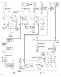

i need to know where the blower relay goes in my 2000 ford escort zx2
May 7, 2020 at 4:47 AM (Merged)
  • 110,244 POSTS
It is located in the relay box behind the left side of the dash. Here is a schematic of the system. Let me know if it helps. (you will most likely need to enlarge it).
https://images.2carpros.com/forum/automotive_pictures/249084_5_71.jpg
