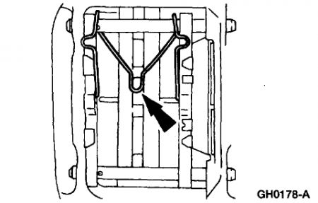

we replaced the front pads their were shims that needed to be put back on new pads and also some clips fell off and we could not see where they came from can you show a picture where they need to go back on the pads or where ever they came from
Apr 28, 2020 at 10:06 AM (Merged)
WRENCHTECH
  • 20,761 POSTS
https://images.2carpros.com/forum/automotive_pictures/561653_Brake_clips_98_Escort_1.jpg
