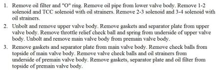

BLUELIGHTNIN6
  • 16,542 POSTS
OK, so the solenoid is the most likely culprit here then. to reach the solenoid you first have to remove and disassemble the valve body of the tranny. follow the steps below which will help in removing the valve body and the solenoids. also i have provided a link to a great video on how to test shift solenoids.. http://www.youtube.com/watch?v=24gkmDDV0C8
https://images.2carpros.com/forum/automotive_pictures/261618_Noname_2474.jpg

One last question do i repalce only shift selenoid c and will that probably eliminate p1744 also?
Jul 20, 2010 at 12:21 PM
SAULVITE
just lowerd valve body, all selenoids click ok, and feeding voltage is present, what else shoud i try?
