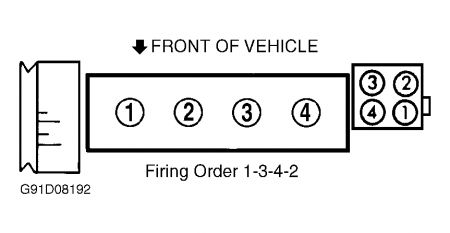

Im replacing an ignition coil and i was just wanting to see video on it so that way when i put it back together i put the spark plug wires back to it correct place?

Here is the firing order and a video of the job being done on a 6 cylinder ford. Almost the same thing https://youtu.be/iDgXwKA-IIc
https://images.2carpros.com/forum/automotive_pictures/99387_Graphic1_494.jpg
Check out the diagrams (Below). Please let us know if you need anything else to get the problem fixed. Cheers
