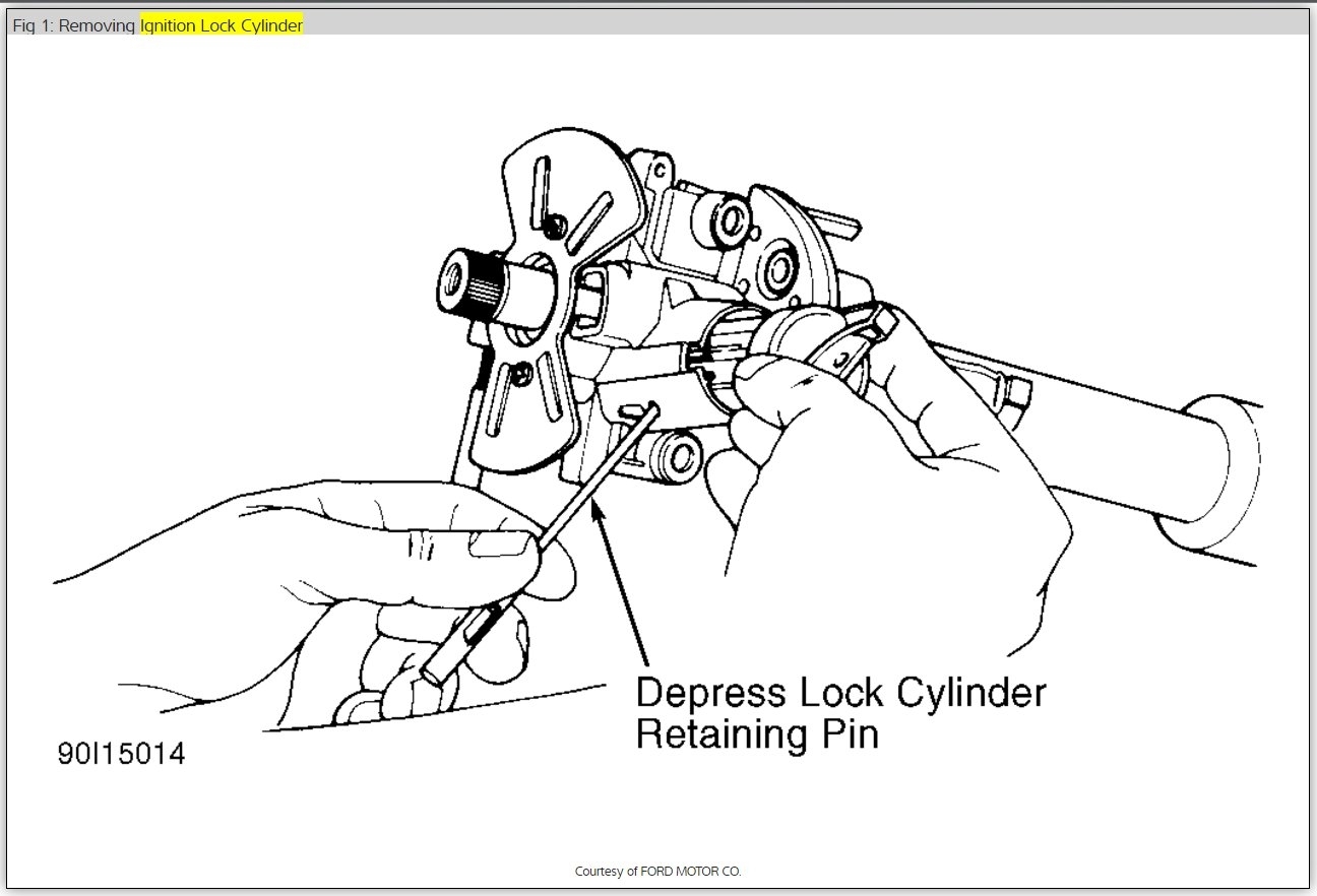

how do i remove the old cylinder on the ignition switch? i saw the two roll pins, but i cant remove them. tried to turn the ignition to the on position as well.

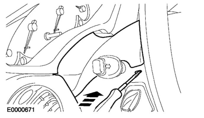

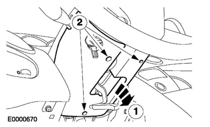

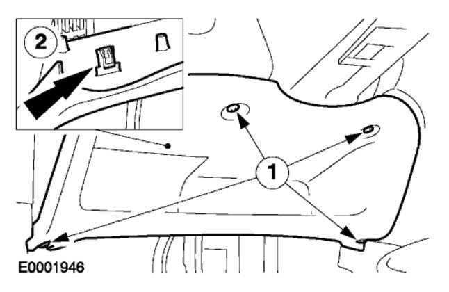

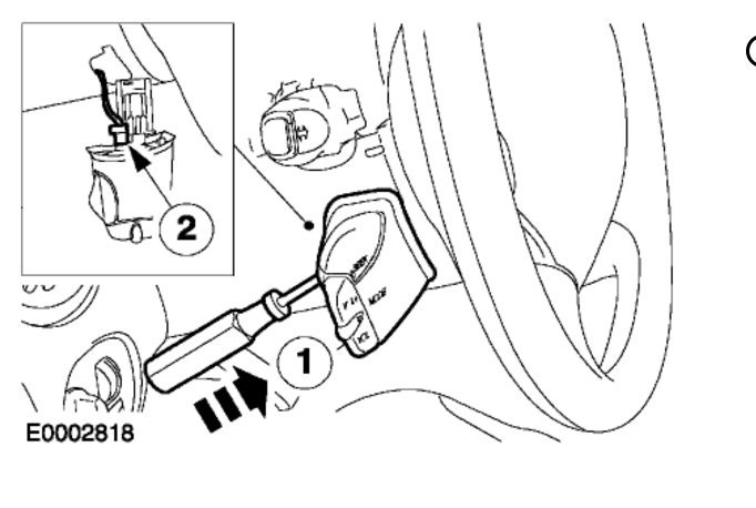

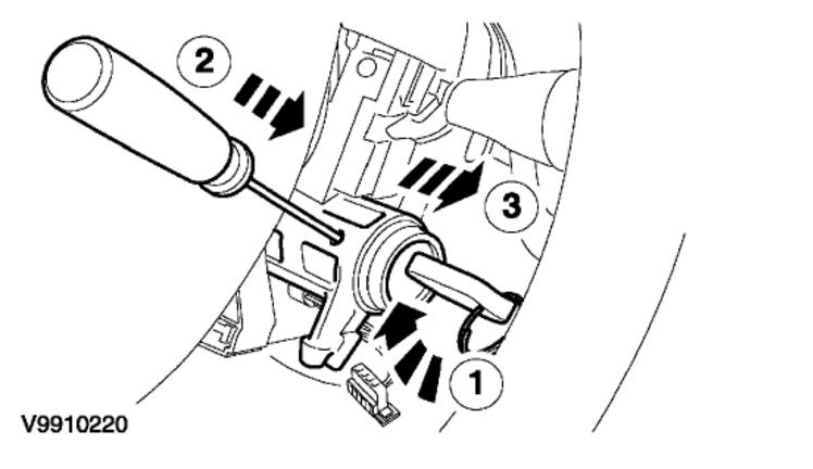

You need to turn the tumbler so the pins can be depressed. Here are diagrams (below) of the job being done. Please let us know if you need anything else to get the problem fixed.

Are you replacing the ignition switch or the ignition cylinder lock and key?
It sound like you are trying to replace the ignition cylinder to me
If so you need to turn key on insert small long screw driver in the whole u r talking about push pin in pull cylinder out insert the new one in start car

are you looking to replace the ignition cylinder /key
1- turn key to on just before start
2- look under the steering column by the key area
u will see a hole all u need is to insert a piece of metal
small screw long driver will do
use it to push in the pin and pull the cylinder/key out

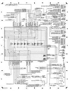

ASHLEIGH
Electrical problem
1992 Ford Escort
I need the electrical skematic for this make and model my chiltons shows me the skematic for a 97-2003 im not sure if it is the same design. I have replaced the igniton switch twice in my vehicle within the last 6 months the mechanic told me the part/s he ordered were from the factory supposed to be brand new now i am fed up and i am going to put a toggle in and a push button help thank you
Oct 8, 2018 at 4:19 AM (Merged)
DAVE H
  • 13,383 POSTS
you may have to save this to your computer to enlarge it ...
https://images.2carpros.com/forum/automotive_pictures/266999_elec_1.jpg

There is a small hole under the ignition key. Can I use a probe in that hole to release barrel & key??

Good call, thats exactly how it is done.You will need to use the key to turn the lock forward while pressing the button inside the hole to get it to release

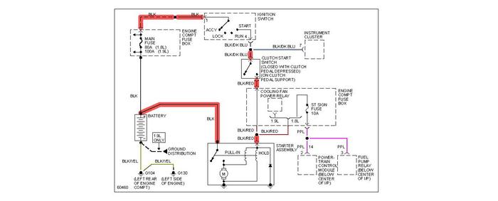

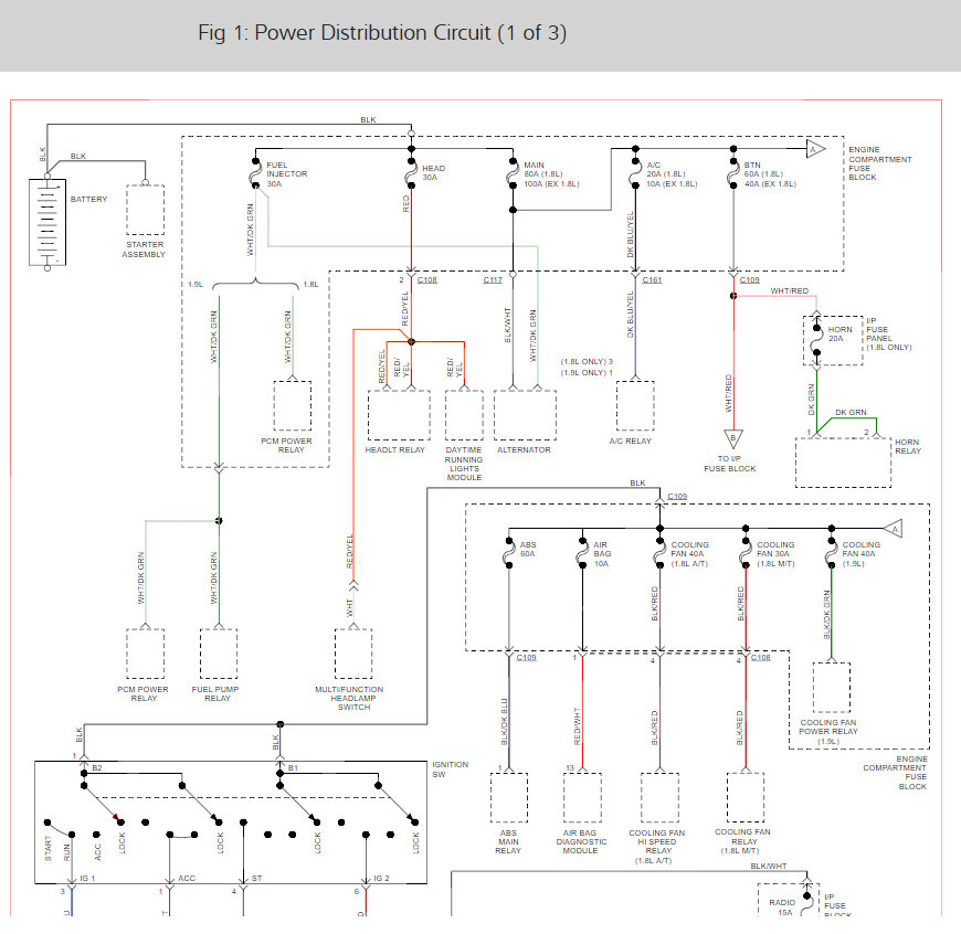

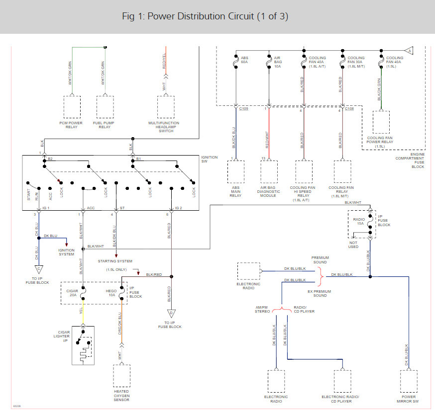

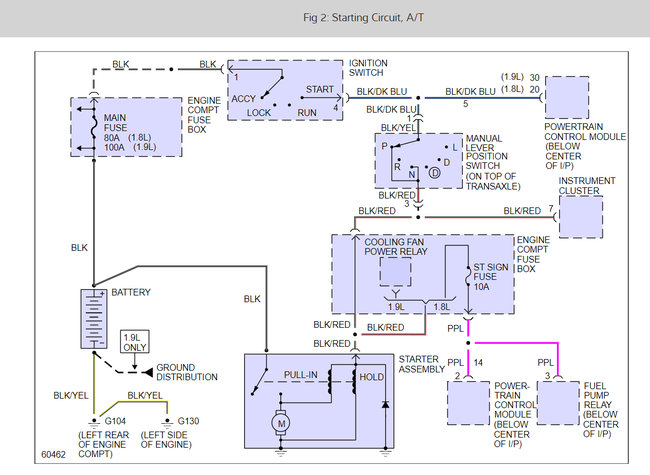

JTTRUNK
Hey guys! I have a 94 escort 1.9L lx wagon manual trans. My ignition lock cylinder broke and I'm going to install toggle switch and push start button. The problem I face is the wiring, on the ignition switch there is 2 lrg black constant 12v (one connector) and 4 wires (smaller gauge then the 2 black) on a different connector, the colors are B/R, BL, B/W and B/DBL. I believe the B/DBL is to the stater solenoid. I plan on leaving the ignition switch in the RUN position and installing toggle(s) for ACC/RUN and a momentary push button for the STARTER.
Can one of you please explain which wires to connect to toggle(s)? The 2 black 12v constant are confusing me. Do I need 2 toggles, or a 3 pole toggle?
Oct 8, 2018 at 4:20 AM (Merged)
  • 75,988 POSTS
You need a push button in between one big black wire and the black/dark blue to engage the starter.
You will need on off on toggle for the power wires for the ign1, ign2 and accessory .
Check out the diagrams below by clicking on them
