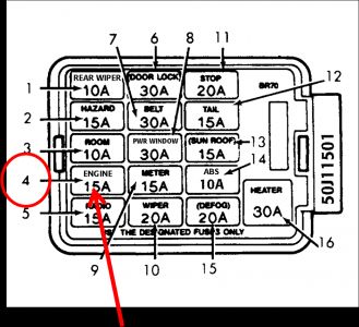

Next check the 15A fuse located at the instrument panel fuse box. See the above pic

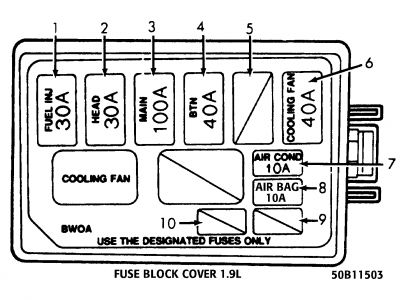

https://images.2carpros.com/forum/automotive_pictures/248015_Graphic_12.jpg
See pic above for these Using an ohm meter check the 100amp fuse.........item 3 on the pic on in the main under hood fuse panel. Next ensure the 40 Amp fuse is good using an ohm meter located in the engine compartment item 6 in the pic. Next I would replace the relays......you have one located in the engine compartment fuse box as shown in the above pic

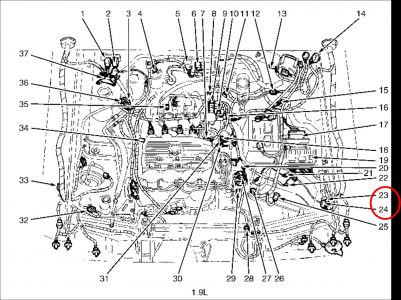

https://images.2carpros.com/forum/automotive_pictures/248015_Picture4_31.jpg
Then on your model you have a low speed relay located front of left fender well and the the high speed fan relay also located there numbers 23 and 24 on the pic.

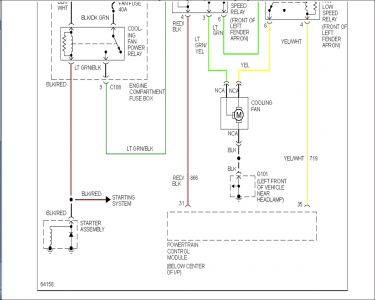

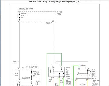

https://images.2carpros.com/forum/automotive_pictures/248015_Picture1_112.jpg
https://images.2carpros.com/forum/automotive_pictures/248015_Picture2_69.jpg
As you see by the wiring diagram that seems to be the only items in this system.
