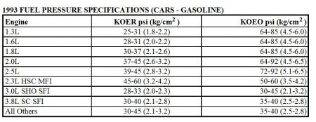

No Sir, the engine light is not on. The car will start fine and idle ok. I was thinking about the posibility of a bad fuel pressure regulator. The fuel filters (ALL) are new the sock is new as well. Fuel pump (TANK) is new too. Im thinking about checking the pressure on the rail. I have the proper gauge to check that with. I just need to see what Ford (or you ) can tell me what the proper operating pressure and fluctuation is I guess. Carefully checked for Vacuum leaks with soapy water on all lines. None. Im also thinking about checking all fuel lines for obstructions.

Things to do in your case
Check power to MAP/BARO sensor.
Check air intake system. Also, ensure throttle plate and linkages operate properly.
Check for restricted exhaust system.
Check EGR system.
Check fuel delivery system.
Check engine compression.
Check engine mechanical condition.
Check intake manifold, manifold gasket, camshaft and valves.
https://www.2carpros.com/forum/automotive_pictures/192750_FuelPressure93Escort_1.jpg
You should use the specs for OTHERS
