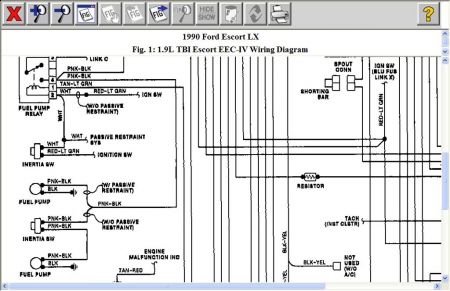

My car quit, checked and no fuel to carb.
Checked with test light and no power seems to be
getting to the pump. There are four wires going to
the fuel tank, 2 are grounds, colored black, one is yellow, I believe that is the fuel gauge wire, it blinks with a test light on it and the fuel gauge still works.
The other wire is pink w/black stripe. No power in this wire with the ignition switch on. I checked the fuel pump shut off switch, it is okay. My chilton book on page 5-16 under fuel system/fuel pump diagnosis says "check fuse integrity" what fuse??? there is no fuse designated for the fuel pump in any of my books for this car. I located the fuel pump relay under the dash, is this the fuse they speak of? Is there a fuse link somewhere I can check, I am stumped. Can you point me where or what I need to do?

Check the fusible link C also at the yellow wire at the fuel pump relay do you have power to it?

Checked the yellow wire at the fuel pump relay, doesn't seem to be power there. I am trying to find fusible link C in my book now and also trying to trace yellow wire from relay. Correction, I have power in the yellow wire at the relay. Is fusible link C one of the links at the starter relay switch with yellow wire
coming out, if so there is power going throught it.

Power the fuel pump pink and black wire from the battery did it come on? if so and fuel pump relay is okay -check the computer ground control circuit

If you power it from the battery positive post to the pink and black wire and ground the black wire and don't come on-the fuel pump is defective.

Test the fuel pump relay and inertia switch-

if you are referring to the fuel shut off switch located under the hatchback behind the left side panel, I checked that before I first posted here...from my first post... If that isn't what you are referring to, I have no idea what or where the inertia switch is and I have no idea what you mean when you say check the relay. I can test the wires, that is the extent of my testing ability and I can't seem to disconnect the relay switch from where it is fastened under the dash. Thank you for trying to help me.
