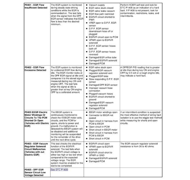

Good afternoon.
There is nothing on the list for the EGR system at all.
This code is referring to either the PCM internal short or the EGR solenoid itself.
Symptom/DTC P0403
Descriptor
Eegr Electric Motor Windings Or Circuits To The Pcm Shorted Or Open
Egr Vacuum Regulator Solenoid Circuit Malfunction
Probable Causes
EGR Vacuum Regulator (EGRVR) Solenoid Circuit Open (Non-Electric Exhaust Gas Recirculation Vehicles)
EGR Vacuum Regulator (EGRVR) Solenoid Circuit Short to Ignition Switched Power (VPWR) or Ground (Non-Electric Exhaust Gas Recirculation Vehicles)
EGR Vacuum Regulator (EGRVR) Solenoid Damaged (Non-Electric Exhaust Gas Recirculation Vehicles)
Electric Exhaust Gas Recirculation (EEGR) Connector Not Seated (For Electric Exhaust Gas Recirculation Vehicles)
Electric Exhaust Gas Recirculation (EEGR) Motor Short Circuit (For Electric Exhaust Gas Recirculation Vehicles)
Electric Exhaust Gas Recirculation (EEGR) Motor Windings Open (For Electric Exhaust Gas Recirculation Vehicles)
Harness Short Circuit From Powertrain Control Module (PCM) to Electric Exhaust Gas Recirculation (EEGR) (For Electric Exhaust Gas Recirculation Vehicles)
Ignition Switched Power (VPWR) Open to EGR Vacuum Regulator (EGRVR) Solenoid (For Non-Electric Exhaust Gas Recirculation Vehicles)
Open Circuit In Harness From Powertrain Control Module (PCM) to Electric Exhaust Gas Recirculation (EEGR) (For Electric Exhaust Gas Recirculation Vehicles)
Powertrain Control Module (PCM) Damaged (Non-Electric Exhaust Gas Recirculation Vehicles)
Powertrain Control Module (PCM) Open Circuit (For Electric Exhaust Gas Recirculation Vehicles)
Powertrain Control Module (PCM) Short Circuit (For Electric Exhaust Gas Recirculation Vehicles)

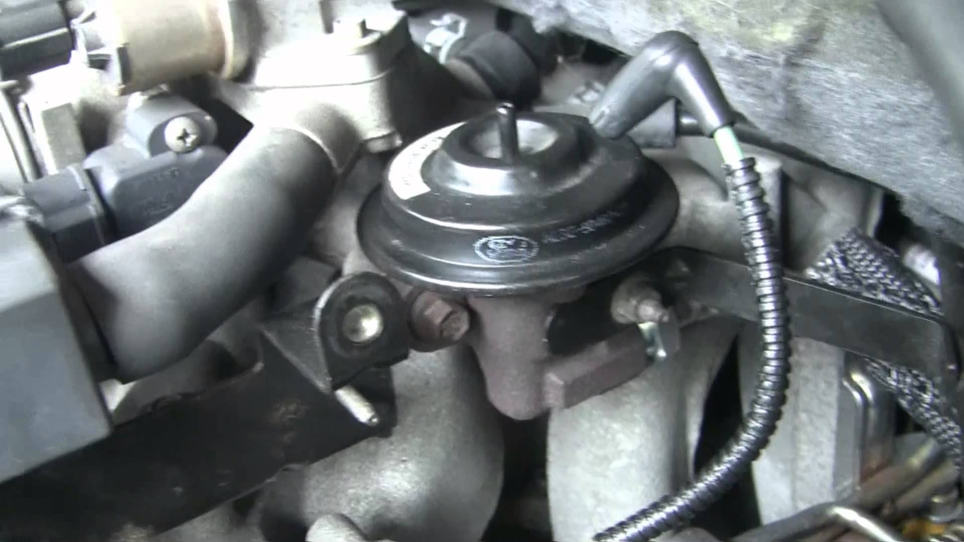

EGR Vacuum regulator showed 19 ohms. When I disconnect hose from EGR there is no changes. Also, there is not a catalytic converter. Sometime car will not start it cranks, after two minutes it start normally.

EGR valve maybe bad? My friend sad that when you disconnect hose car must change sound but it has not changed.
Jun 17, 2018 at 5:50 AM
Okay, the next thing I would do is to check the fuel pressure.
If you have low pressure, it will cause delayed starting as you have at the moment.

In order to check that system with the list I sent you, you need an advanced scan tool to turn on the solenoid to see if it responds to the commands from the PCM.

It respond my mechanic tried and it responds. We also checked EGR vacuum regulator showed 19 ohms, in my country there is no good mechanics for Ford.
Jun 17, 2018 at 6:07 AM
When vacuum is applied, does the valve open?
If it opens the engine should stumble and may stall.
Jun 17, 2018 at 6:31 AM

No its never happening, car never changes sound. Also, when I disconnect hose from EGR it never changes sound.
Jun 17, 2018 at 6:46 AM
Does it have vacuum?
Jun 17, 2018 at 6:48 AM

Feel the end of the hose. It must have vacuum sent from the solenoid to operate. That is critical in operation of the valve.

Hi, today I checked vacuum and there is vacuum.
Jun 26, 2018 at 12:43 AM
The next step is to remove the valve and see if the passages are clear. Start the car with the valve removed and you should hear a good exhaust leak and the engine will run very rough.
Jun 26, 2018 at 12:47 AM

I cleaned valve two times with carburetor cleaner. I will remove EGR valve today again.
Jun 26, 2018 at 1:46 AM
No, I said nothing about cleaning the valve. You need to make sure the engine passages are clear.
When you have vacuum to the valve, can you see it moving?

No, I cannot see if it is moving.
Jun 26, 2018 at 1:52 AM
Remove the valve and run the engine and see if it moves with the line attached?

Hi, I removed EGR and car start idling but EGR not moving.
Jun 27, 2018 at 7:58 PM
Okay, when it was idling did you hear a loud exhaust leak, and a loud exhaust noise as well?

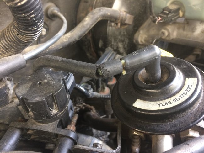

Hi, I replaced EGR but MIl is still on. Today I checked EGR hose and it was broken maybe it is a problem.
Jul 2, 2018 at 5:53 AM
It sure can be. It will not allow the valve to open.
