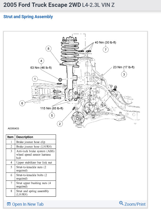

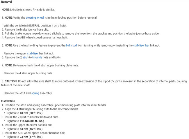

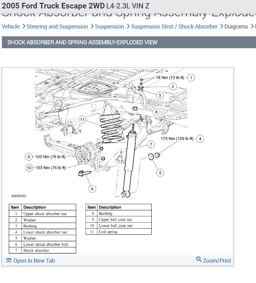

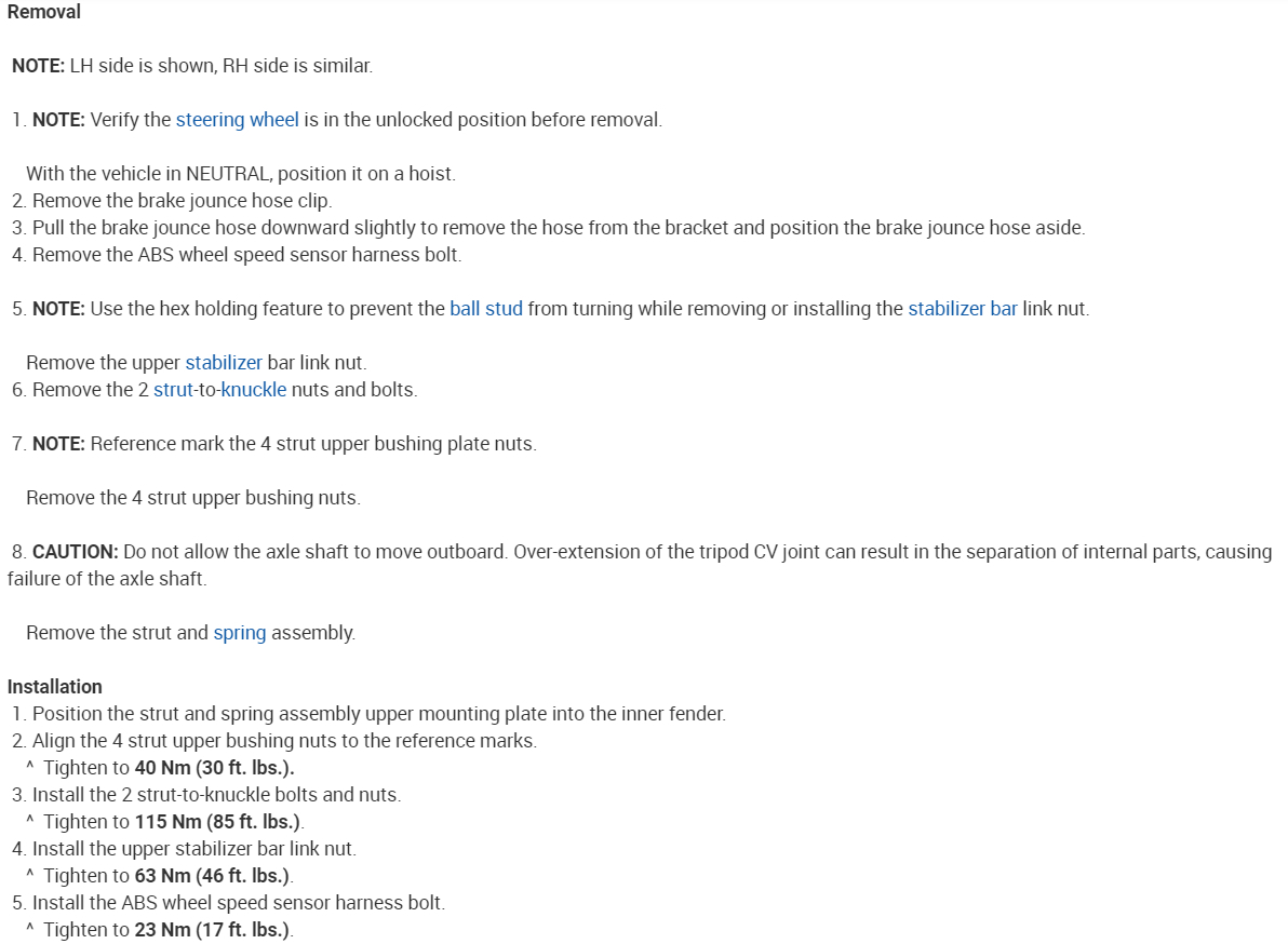

I would like to know how to replace the rear shocks?
Oct 9, 2010 at 7:49 AM
BLUELIGHTNIN6
  • 16,542 POSTS
It looks like they came with both struts and shocks here are instructions on how to change both the diagrams below. Please let us know if you need anything else to get the problem fixed.

when replacing struts do the shock absorbers need to be replaced also?
Aug 2, 2019 at 9:49 AM (Merged)
BLUELIGHTNIN6
  • 16,542 POSTS
your vehicle uses strut assemblies on the front and shock absorbers on the back. if you replace the front struts then you should go ahead and replace the back shocks also as they have all endured the same wear and tear.
