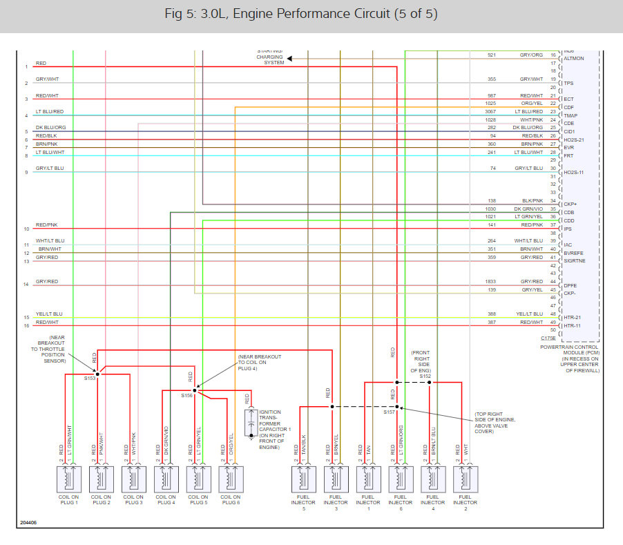

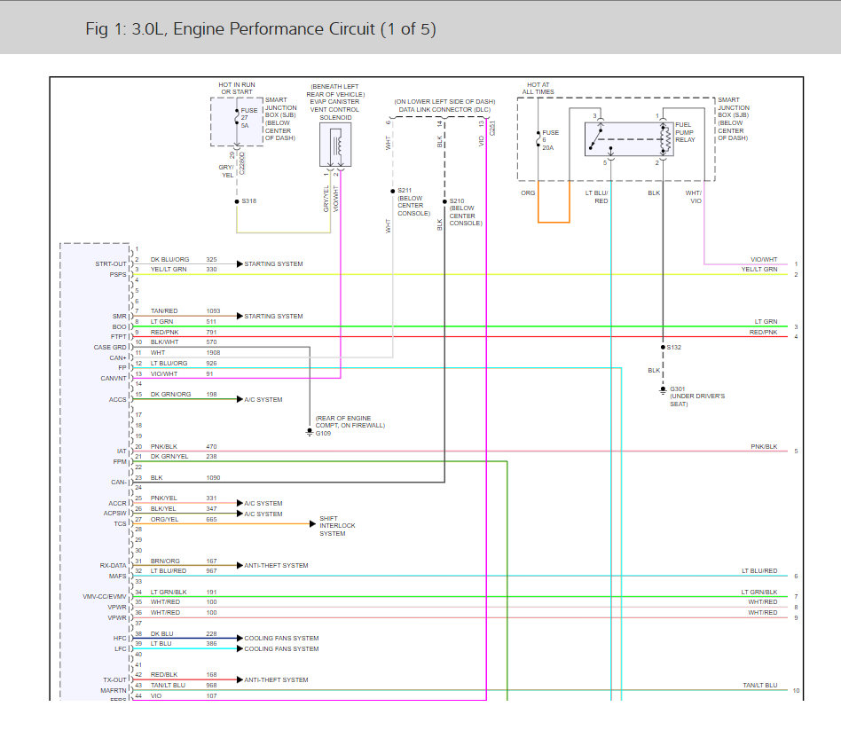

my check engine light is on the code read p0351 ignition coil A primary / secondary circuit. I have changed spark plugs and tne coil on the # 1 coil according to repair manual and still the car sutters when running and the code remains the same am i missin g something in the circuit
Mar 11, 2009 at 1:09 PM
BLUELIGHTNIN6
  • 16,542 POSTS

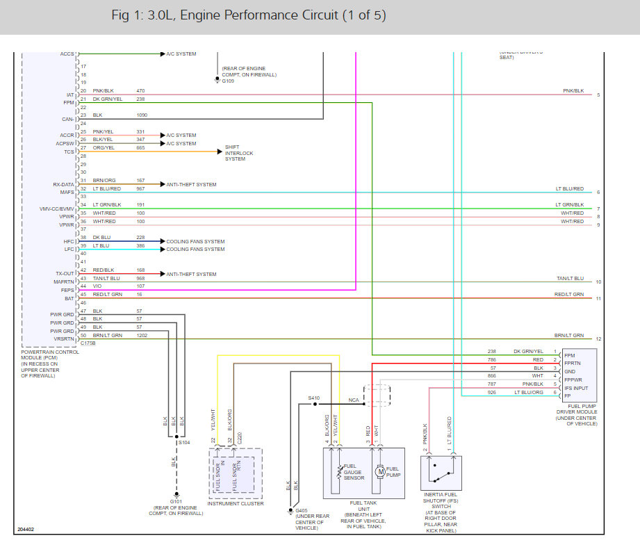

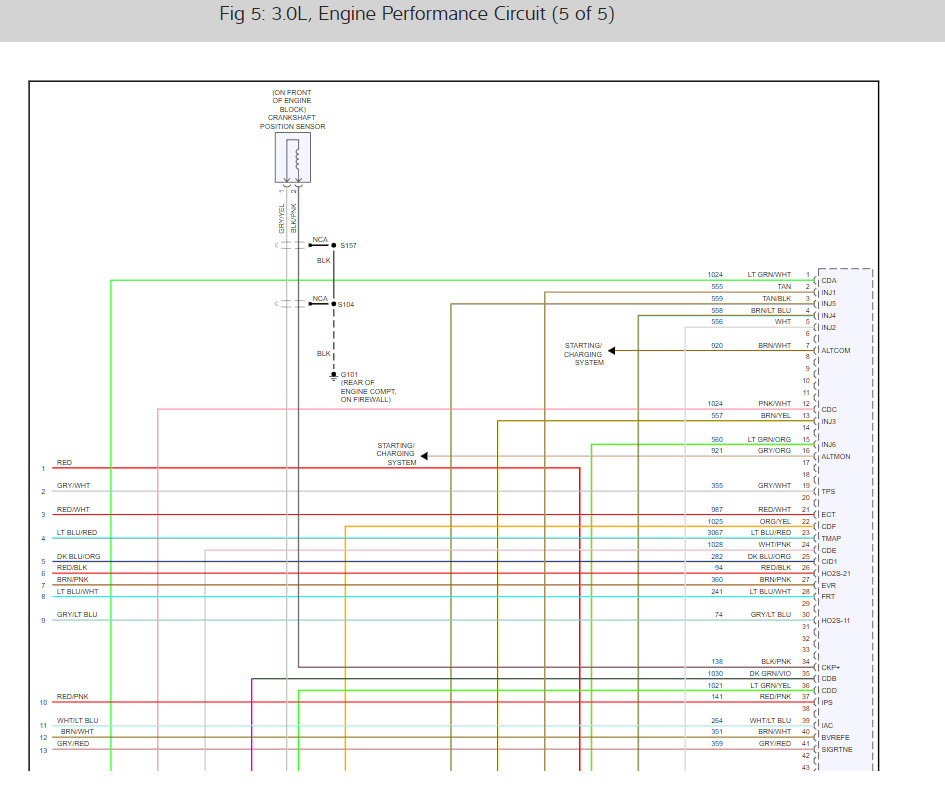

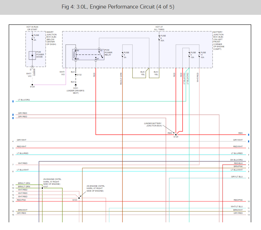

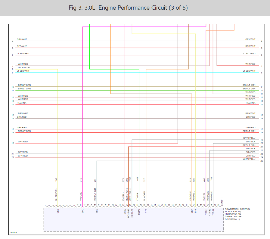

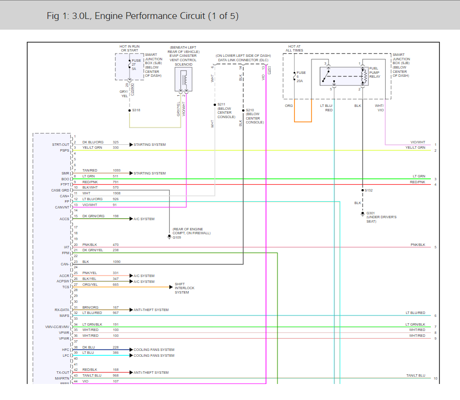

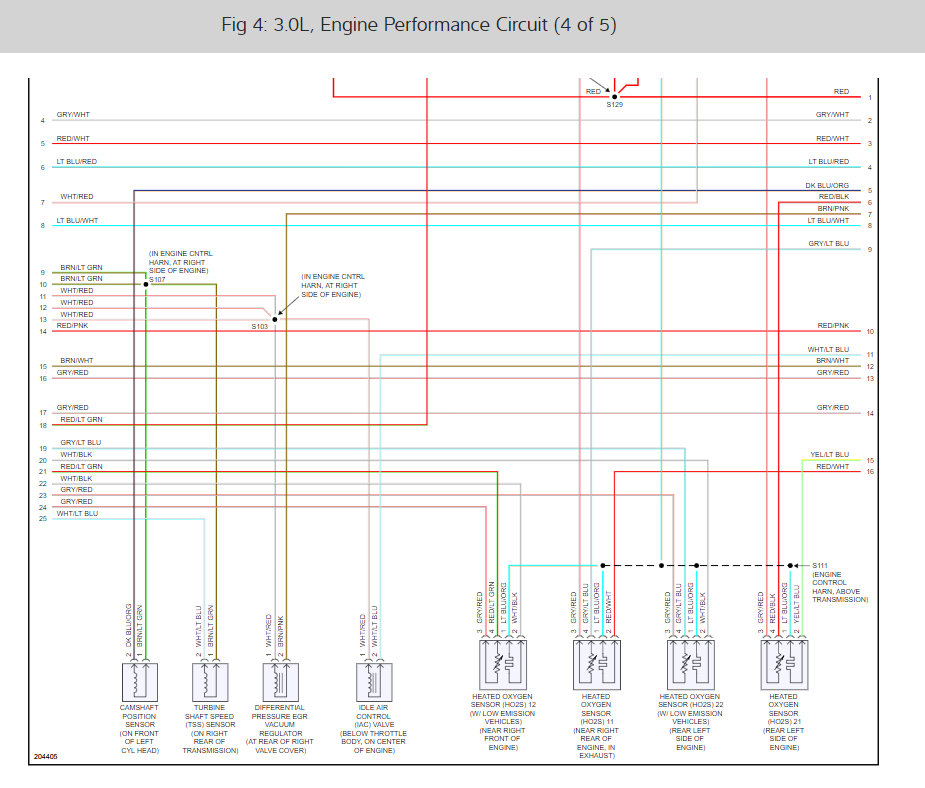

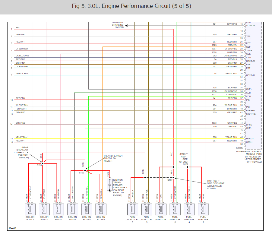

The secondary circuit is between the PCM and coil. Here is a guide to help test the wiring and the engine wiring diagrams below so you can see how the system works and which wires to test for the coil circuit.
Check out the diagrams (Below). Please let us know what you find. We are interested to see what it is.
Mar 11, 2009 at 1:59 PM
NOSEHAIR351
I found the wiring connector was bad I had to get a new pigtail cost $32.00
