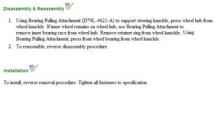

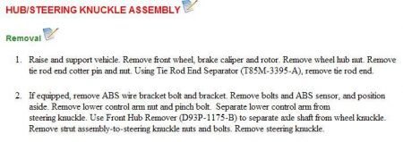

How do I change wheel bearings? I think they have to be pressed in is this true or can I work them in myself? How do I get the hub assbely off and how do I get the old bearing out

https://images.2carpros.com/forum/automotive_pictures/261618_Noname_1091.jpg
https://images.2carpros.com/forum/automotive_pictures/261618_Noname2_314.jpg
