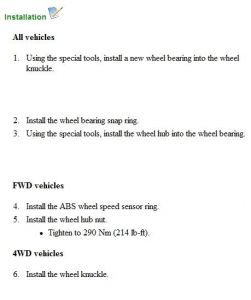

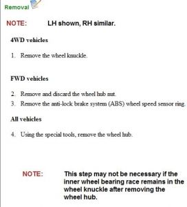

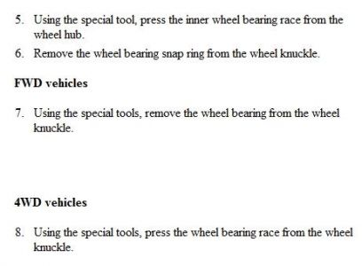

how do you change a rear wheel bearing right side
