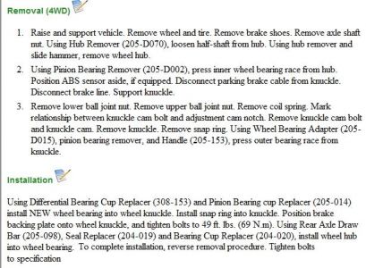

can you tell me the procedure for changing rear wheel bearings on a 2001 ford escape

Hello and thanks for donating Below are the proper steps for replacing your vehicle's rear wheel bearings...
https://images.2carpros.com/forum/automotive_pictures/261618_Noname_1898.jpg
