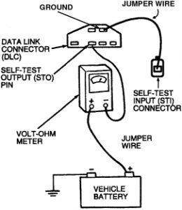

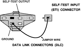

I know it can be done. Need to know how to hook up a jump wire where thecode reader should go? Guy at Autozone said it could be done? But didnt know how. Can someone help please? Need whatever info I can get on this? Thanks Alot

Here is the hookup....
To extract DTCs from the computer for diagnostic purposes, the Self Test connector is used.
Start engine and bring to normal operating temperature. If engine will not start or stalls after starting, proceed with next step.
Turn the key "OFF", then wait ten seconds.
Activate the self test by grounding the Self-Test Input (STI) connector.
Turn the ignition key "ON".
Record all codes received.
Turn ignition "OFF".
